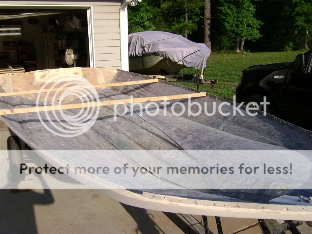

Re:New Project - 71 Glastron GT-150 15 years 5 months ago #33113
  • MarkS's Avatar Topic Author
Pulled the deck today getting ready for stringer and floor work
Bow up Stern up She's clear Topless :ohmy: Where am I gonna put this? Ready to go to work!

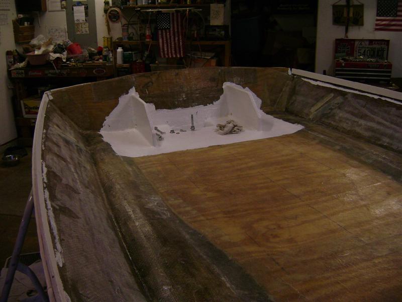

Re:New Project - 71 Glastron GT-150 15 years 5 months ago #33531

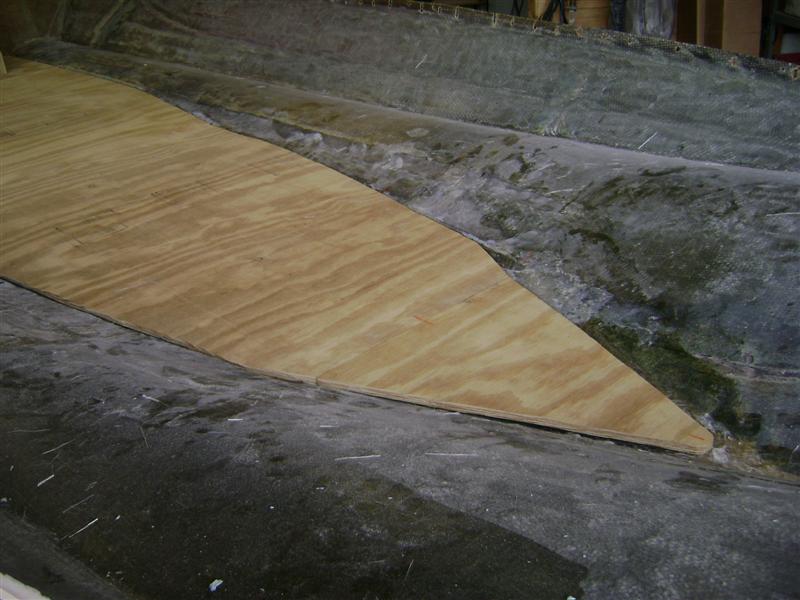

Stringers and cross braces cut, built a set of "knees" for the transom, since I'm not sure yet what motor will be going on her. (Hopefully, the Merc 1000, but that's been back burnered until the boat is back together.)
First fitting
After I got tired of the rough edge of the fiberglass hull tearing up my hide, I figured out putting some tape over the edge helps alot! Duh.

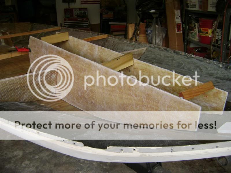

Re:New Project - 71 Glastron GT-150 15 years 4 months ago #35931

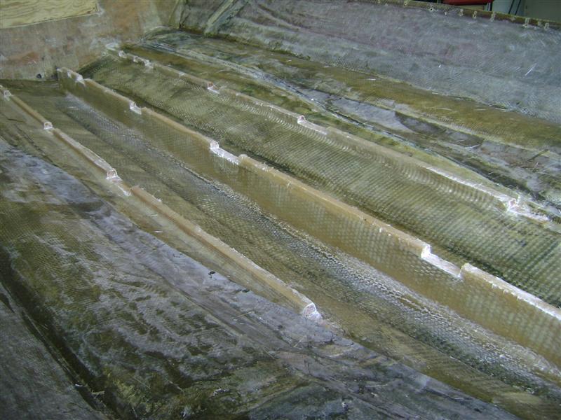

Finally got the hull cleaned and ready for re-construction; Applied poly resin to the stringers, one layer of Biax and cloth to the bottom of the main: And got them bedded into the hull with PL Premium (Didn't go too bad for a first time 'Glasser, shure kicks quick when it's 97* in the garage!)
The cross braces will come off to glass in the stringers, but wanted them to hold the stringers steady while the PL set up. That was enough for today anyway. ;)

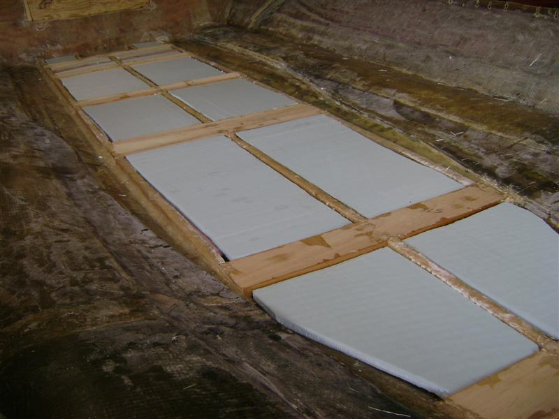

Modest progress report - stringers and cloth reinforcements are in; Foam installed between stringers; And floor is cut and temp installed to check fitment.

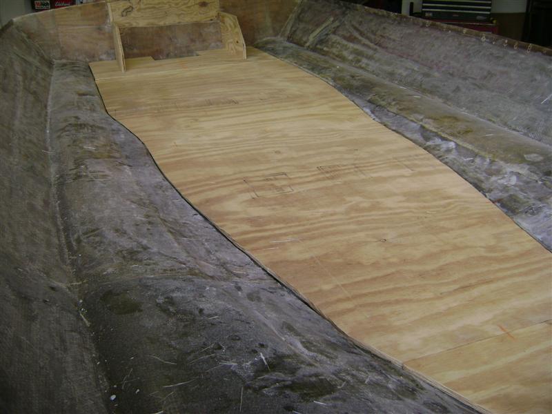

Re:New Project - 71 Glastron GT-150 15 years 2 months ago #42577
Been a while since I posted any progress, 'cause it's been slow going around here. (Not for lack of trying, I assure you!)
Got the floor glued, screwed, and glassed.....
Re-fit the deck to take measurements for the ski locker / console. Cut out the pieces and covered them with csm, kick plates got woven for strength.....
Test fit and trim, test fit and trim, you get the idea
She's assembled and in, gotta wait till next weekend to glass it to the floor, out of resin again. :S

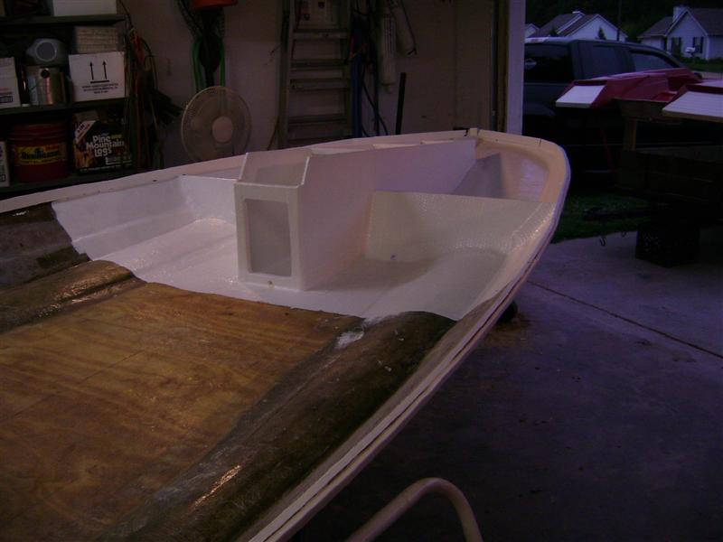

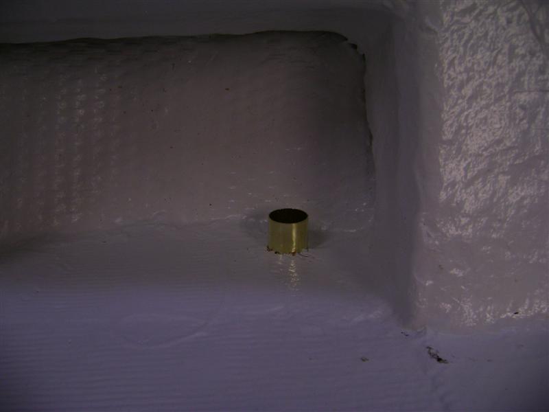

Re:New Project - 71 Glastron GT-150 15 years 1 month ago #44550

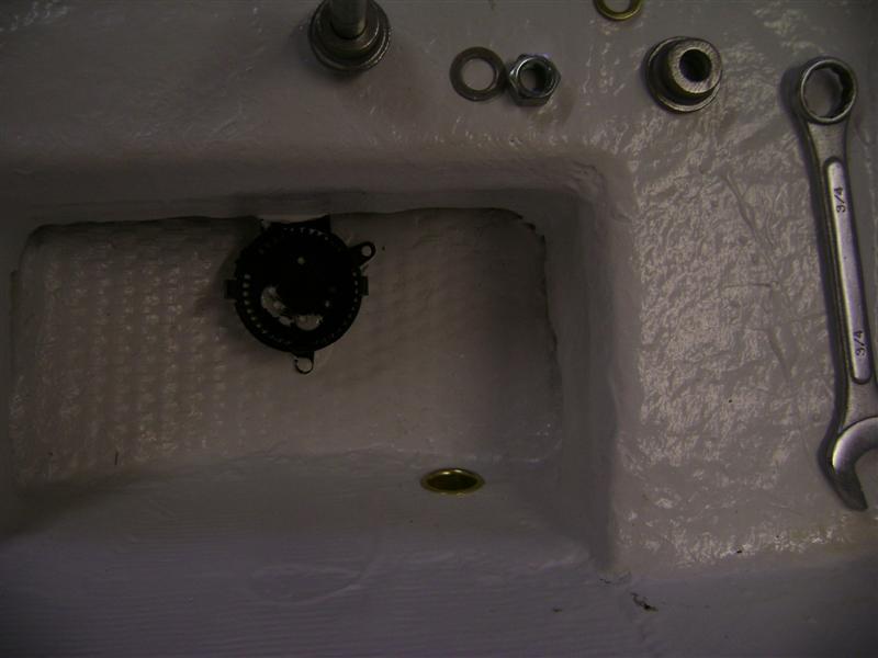

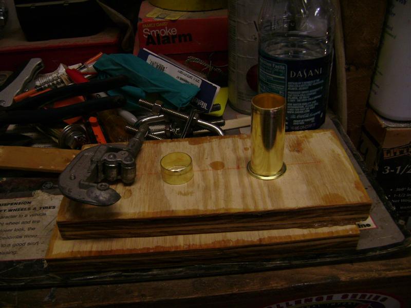

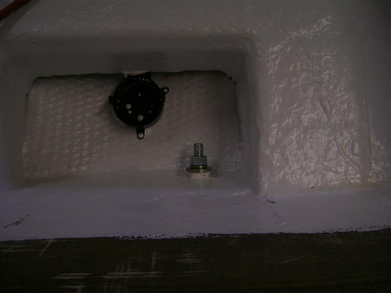

Just a little progress report before the deck goes back on the hull, hopefully tomorrow. Most of the "woodwork" and some areas that will be hard to access once the deck is on have been painted, but I didn't want to paint the entire floor until I figure out and install the seating supports.

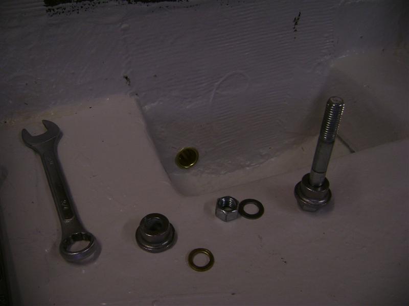

I tried out the new drain tube installation tool, using 5200 to seal it in. (Final "crank down" on the tube will take place tomorrow, after the sealant has partially cured.) My tubing cutter is shot out, but I managed to get it done anyway. Left 3/16" past the mark for transom thickness to make the flare, looks about right;

Great job Mark. I did mine tonight also, must be the moon. Could't get as low to the bottom as I wanted because of the curvature of the outside hull. Up about 1 1/2"
Re:New Project - 71 Glastron GT-150 15 years 1 month ago #44699
Not bored at all Bob, just limited time and $$$ force the schedule to go at a snail's pace. Target launch date = next spring.
I considered moving my drain to the very bottom of the "V", Cal, but the PO had already drilled the new transom in the same spot the old drain was, so there it stayed. I am installing a bilge pump down in the bottom, and hope to not leave her out in the rain anyway.
I used 3/4" wide 5/16" think rubber foam tape around the deck to hull seal, so it took several hours to get them married back together yesterday! These models are prone to leaking in the stern around that joint, so I figured a few ounces of prevention was worth a pound of cure?
Re:New Project - 71 Glastron GT-150 15 years 1 month ago #44708
Totally understand, just thought I'd throw a shot out. ;) I'm still trying to get the Fat Fifty hot rodded, witha thread, paint its cover and get to the trailer before I start on the Century. The wife keeps throwing honey do's with priorities in front of it!
The bilge pump is a good idea, especially if you can't put the drain at the bottom of the V. The foam is a good idea also. I would have done that too. The big thing will be what's the lifespan of the foam you used. Some have a short lifespan depending on heat and moisture, like the stuff you can get for around your doors. I've seen some of that stuff break down after a couple of years, but that was in florida. I'm sure that's not as dense as the stuff you used but just an example.
