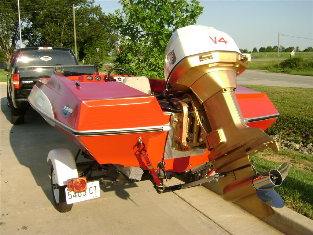

What year is that good looking engine?
Re:New Project - 71 Glastron GT-150 13 years 11 months ago #66323
  • MarkS's Avatar Topic Author
It's a 1978 E'rude 115 Jim, with PT&T. I've got one more piece of "Bling" to add to it, but I'm waiting until launch day to install that!

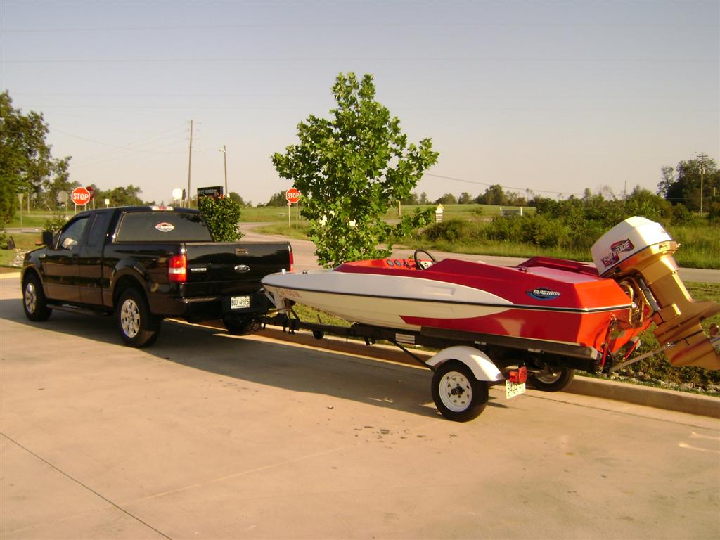

Got the axle moved back to the rear position, much better balance now. (Ended up lifting the boat off the trailer with the engine hoist on the stern, come-a-long on the bow.) Gotta love the old Holsclaws and their built-in adjustability!
Made a few final adjustments this morning, and headed to the lake. To quote a phrase from "back in the day", WHAT A RUSH! :laugh:
I've got some serious chine-walk issues at 53mph, had to back down from there. Not bad for the first time out, though. :kiss:

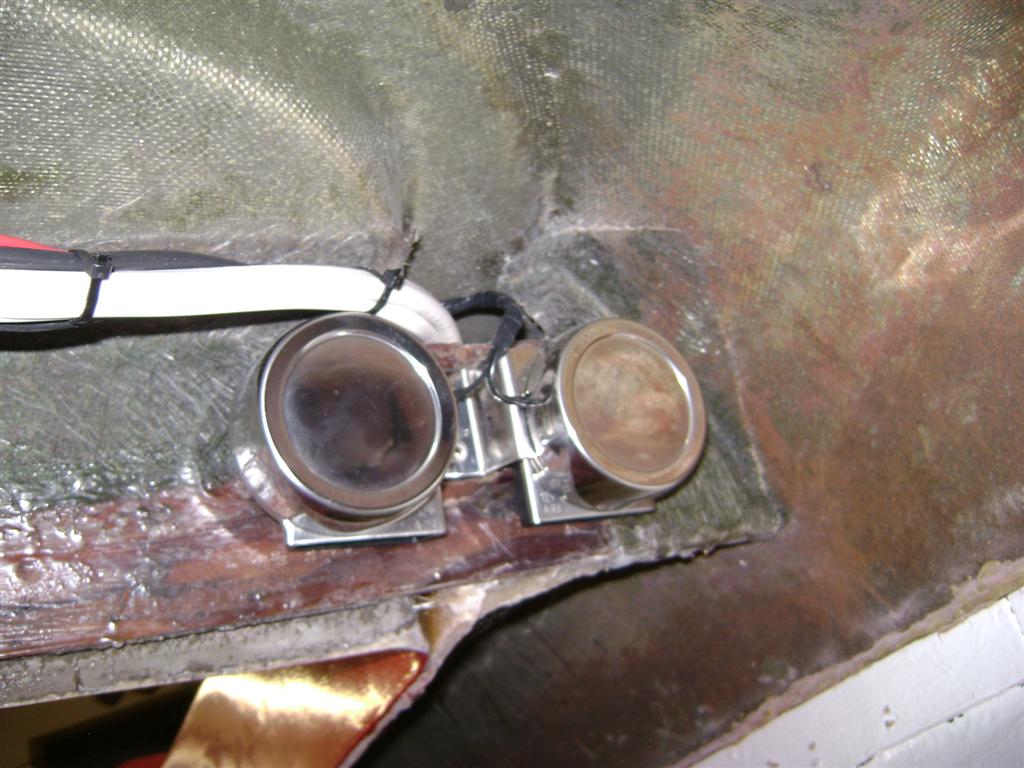

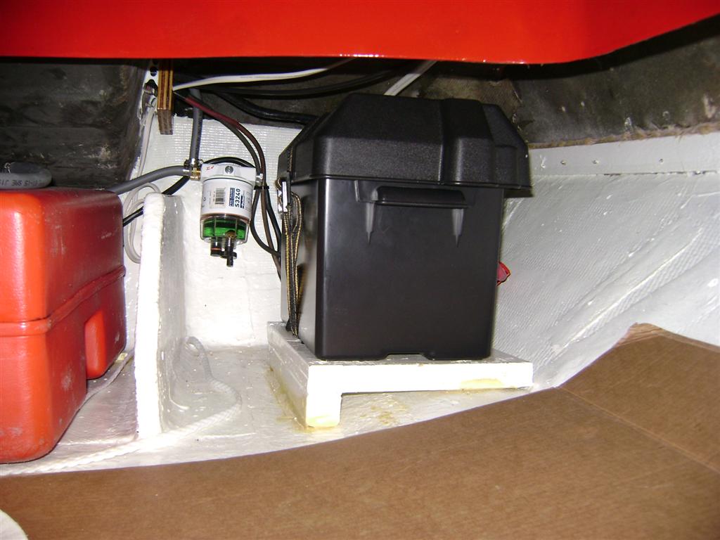

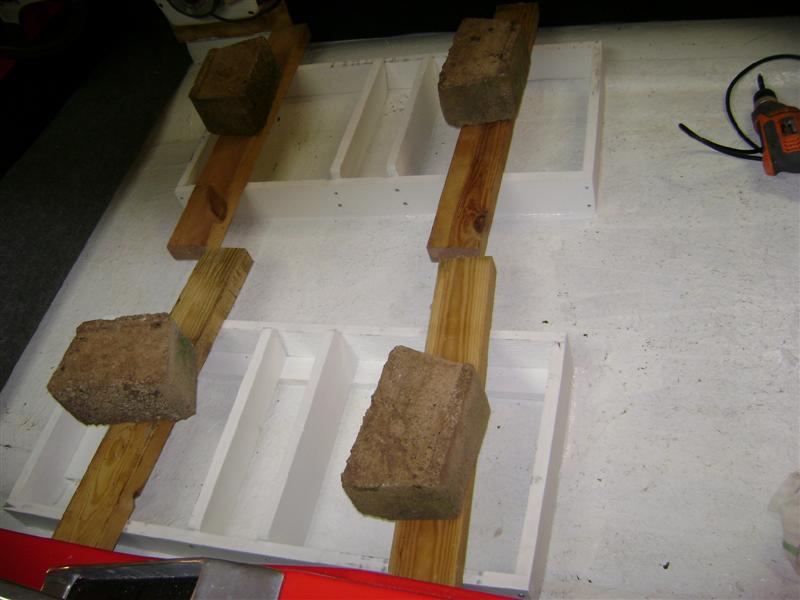

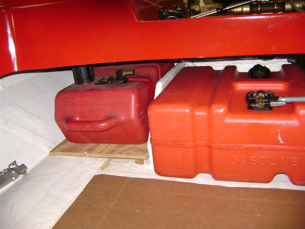

Just catching up on some pics of the project updates, knocking out a few more small details;

Nicely done Mark, tucked away all nice and neat!!!!!!!!
Re:New Project - 71 Glastron GT-150 13 years 11 months ago #67314
Mark, now that's what I call ship shape, nice and clean!

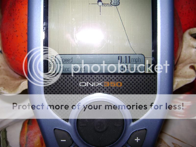

Thanks guys, I'm trying my best to do the old girl justice. Took her out again yesterday for some training (me) and prop testing (OMC 12.75x21P alum). First one is just a cruise with a short blast at the end;
Boat control at (close to) WOT takes both hands, I was trying to document the speed as I "snuck up" on the chine walk;
(Bumped 55mph, we'll call it 54)

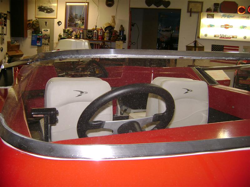

Having a ball, but a windshield is going to take priority over finishing the interior! (That's just a temporary seat, not even fastened down!)

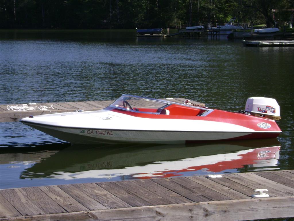

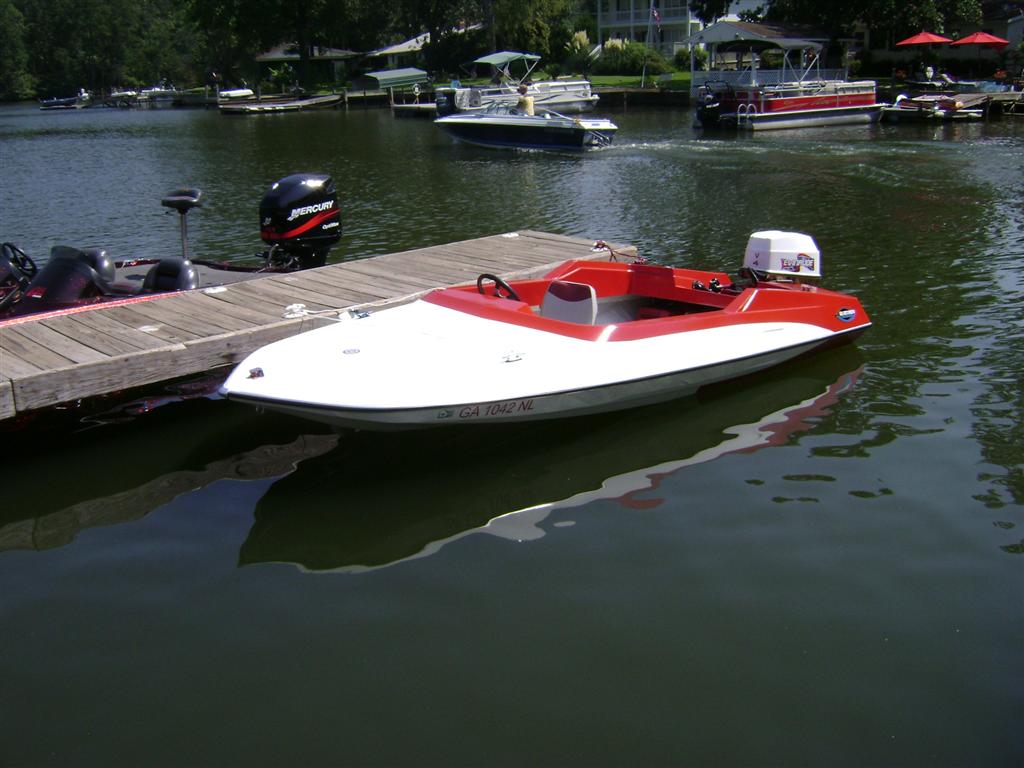

Beautiful day for a boat ride, but a little too windy for any serious prop testing.

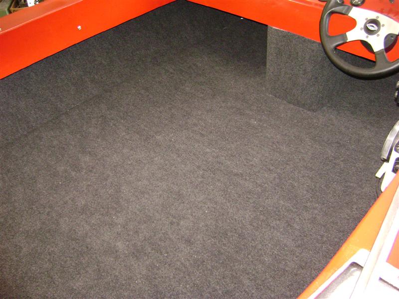

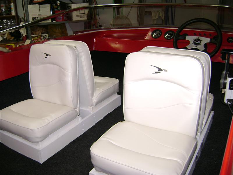

Things have been pretty hectic and stressful at work lately, so I took a day off to have some "quality time" with my baby. :)~ New carpet installed. New seat frames glued and screwed together, glued to floor (last weekend) with 5200, NO screws into this floor! Trimmed them in.... After cutting the 10" tall bases down to 4", the new seats were set in place. I couldn't afford the upholstery bill for re-creating the exact replacements for a true restoration, heck I couldn't even afford "store bought" back to back lounge seats. These were some jump seats I caught on sale last winter, I think they turned out okay for a "first timer".
Re:New Project - 71 Glastron GT-150 13 years 9 months ago #70802
Nothing wrong with that Mark. We all do what we have to do. I think they look great!!!!!!!!!!!!!!!

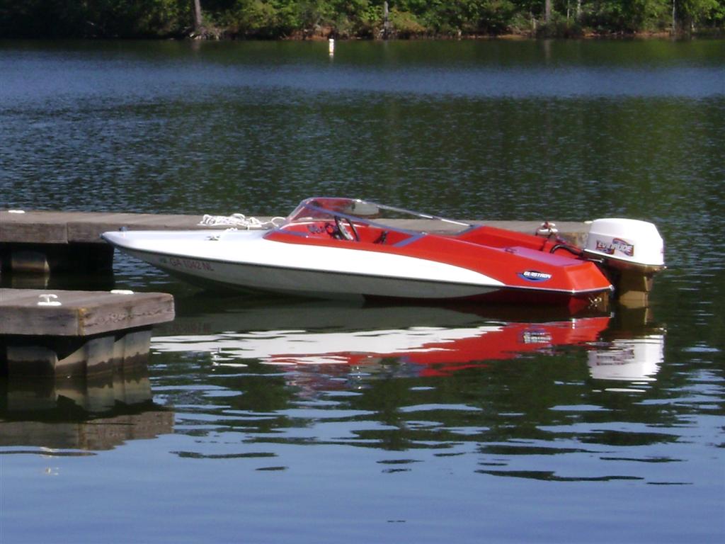

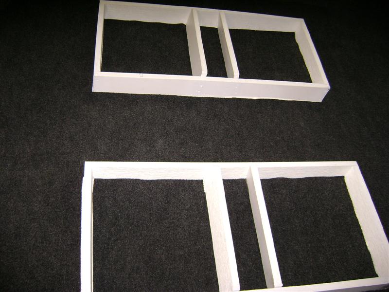

Well I ended up cutting another 1 1/4" off the seat bases, trying to get the wind out of my eyes while underway. (Short windshields don't offer a lot of protection.) Still have a few odds and ends to finish up, but I'd say she's 95% complete at this point. Played with weight distribution and different props, still have a little "tweaking" to do during the off-season on the motor set up. Got a very respectable top speed out of her today though, I'm pretty well satisfied with the number for now!
Prop Test Results to Date;
Mission is to get WOT at 55-5600, with max SAFE speed. (Looking for 55!)
Starting point/baseline - 1st Prop - OMC brand 12 3/4 X 21P ALUM - WOT 5400 @ 54MPH - Note: gets a little hairy over 53mph, nature of the hull design as I am told.
2nd Prop - OMC SST 12 3/4 X 21P Stainless (teflon coated) - *WOT 5200 @ 52MPH - Note: more left on the table in the speed, *chine walk gets too severe to continue. Porpoising at lower speeds if trimmed above 1/4. Probably going to be the fastest/best all around, if the set-up can be refined to control the boat at top speed.
3rd Prop - OMC Raker 13 3/4 X 22P Stainless - WOT 5100 @ 50MPH - Note: Too much pitch & bow lift, didn't like much if any trim, porpoise and chine walk prevalent, much better suited to CVX style hulls with pad.
4th Prop - OMC SST II 13 3/4 X 19P - *WOT 5800 (pulled back, was still winding up!) at 48MPH - Note: not enough pitch, might be a good prop for heavy loads or pulling barges.
5th Prop - Power Tech PT03(?) 13 1/5 X 19 w/custom cupping and pitch added - WOT 5200 @ 48MPH - Note: Stern lift created by this prop gives a whole new "feel" to the boat, thought we had it here. RPM and MPH just not where they need to be.
Back to props 1 and 2, with a Solas Amita 3 13 X 19P as a back-up/spare/emergency. Will probably try raising the motor up another hole as suggested, and maybe add a Bob's True Tracker to help with stability. All numbers posted from recollection, so please forgive me if they're not exactly as stated earlier.
