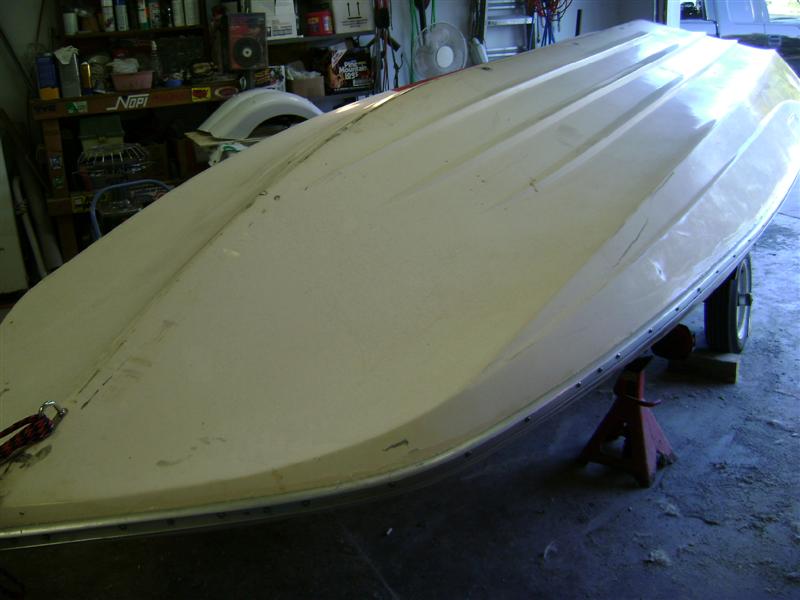

I've been trying to decide how to tackle the bottom of the hull, whether to just slide it off the trailer, tip it up on her side and do one side at a time. Since I really wanted to be able to work through any weather, and do the entire bottom at once, I got brave and decided to flip her over! First attempt didn't go well, not enough room in the garage. Using a 1/2" drive 4" extension thru the motor well drain hole: So I pulled her outside, swapped ends, and gave it another go. Kinda nerve wracking doing it by yourself, but I got it done. :P Time to have a "sanding party". :laugh:

hello mark, you buy the beer and i'll come and help sand, ohhh thats right you live along way from minnesota. lol but it is the thought that counts. you are doing a remarkable job, but we all knew you would. the snow is about to fly up here, they are talking maybe next week. i'll buy the beer and have a toast to ya. frog
Re:New Project - 71 Glastron GT-150 15 years 4 weeks ago #47530
wow,mark cool looking boat,it even looks fast upside down!!!,your doing a great job buddy,john

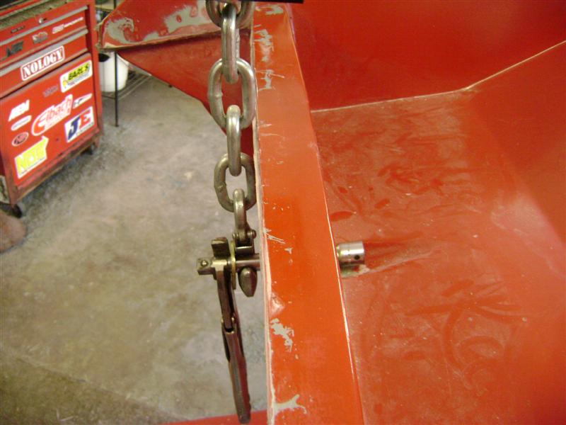

Looking great.....can't believe you drove that far to get...you must have really wanted this project.
wondering where you had the come along hooked to and how much effort it took to flip?

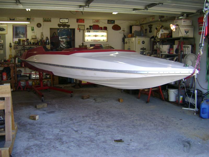

Thanks guys, and yes Matt I wanted it a lot! :laugh: Still do, now I want to go for a ride though. All in due time, I guess.
I ran a 3/8" x 4" long lag bolt with a hook on the end into the header across the garage door opening (inside) to hook the come-a-long into. I highly recommend having a friend or helper handy when you do it, it's a little tricky doing it by yourself. I ended up pushing down on the gunnel closest to me, reaching up and pulling the oposite side over the top toward me. The tricky part is holding it in position (level horizontally) while lowering the hoist(s)! (She wanted to flip back over, so I used some 2x2's to prop it in place. Let her down a little, re-position the props, etc..)

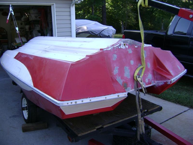

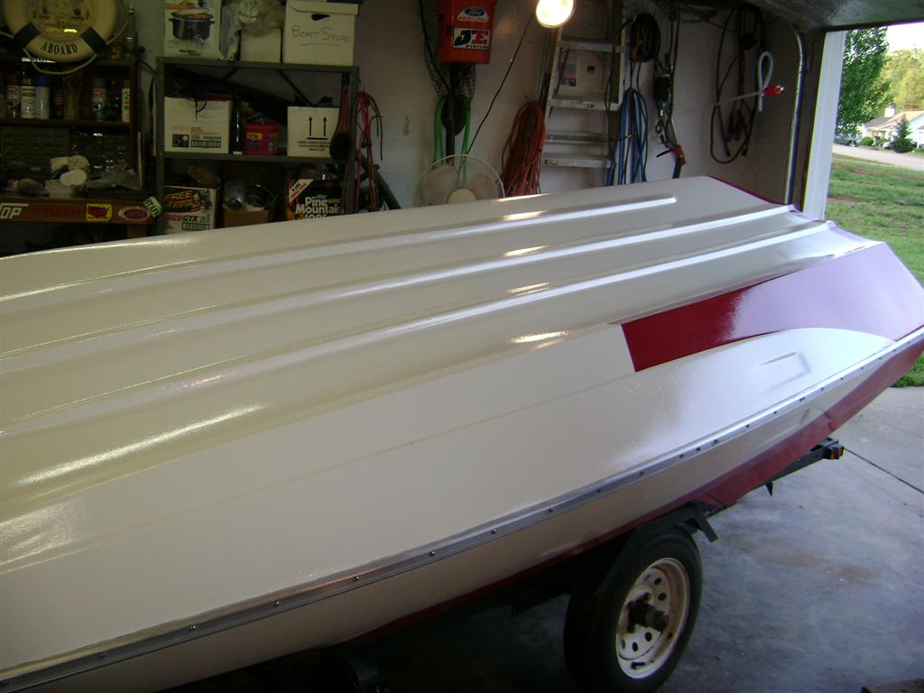

Just finished up the final sanding on the hull yesterday, Ken. (Looking at the previous posts here, it only took 5 months!?) Getting kinda lazy these days I guess, but I'm no paint and body man. It's been gorgeous here too, so the "fire of desire" to get her done is renewed. The E'rude is ready for installation, I think I have most of the parts gathered I need, hope to post some new progress soon. ;)

I figger'd you had it all done by now !! LOL.........Take your time ... It'll get done plus you allready have a ride you can use in the meantime............ Good luck Mark !!
Re:New Project - 71 Glastron GT-150 14 years 7 months ago #58014
Mark,
I thought I would chime in and say COOL! I love the old Glastrons and you've done a great job on the rebuild. Feels good to save a life eh? :kiss:

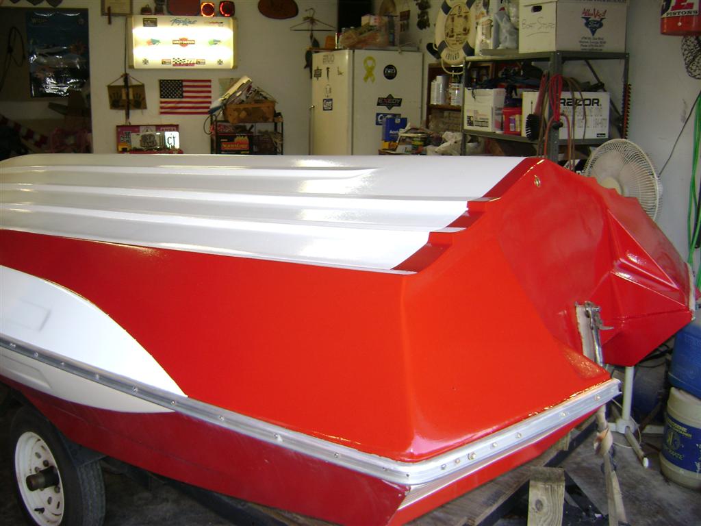

Project - 71 Glastron GT-150 14 years 7 months ago #58631
  • MarkS's Avatar Topic Author

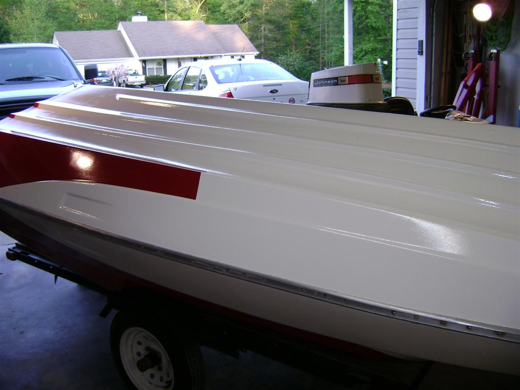

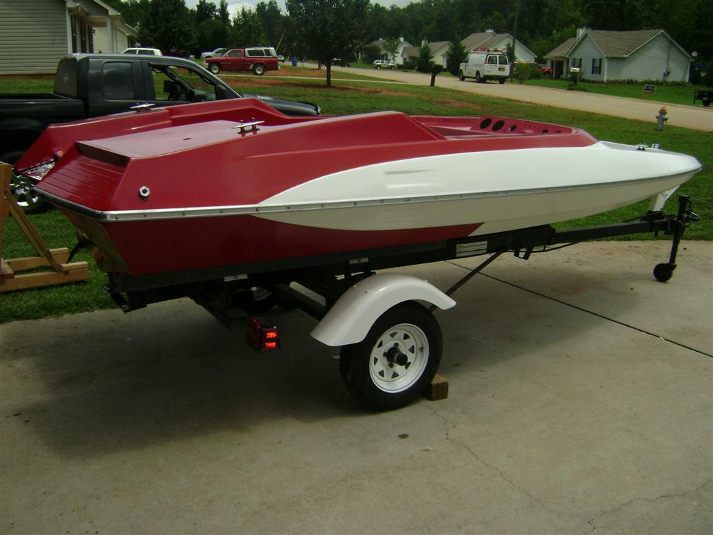

Finished painting the hull last night, it didn't turn out too bad. It's got a few bugs, (low to mid 80's here for the last couple weeks!) a few "oh shiz's" (I hope to touch up later), and the quality is no where near what most of you are turning out, but it's done! Gonna let it set this week, hope to flip her over back onto the trailer next weekend. Woo hoo! :P
Re:New Project - 71 Glastron GT-150 14 years 7 months ago #58664
Don't sell it short buddy, it looks Great!!!!

Re:New Project - 71 Glastron GT-150 14 years 7 months ago #58738

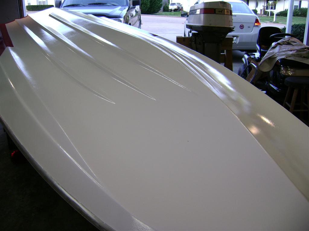

Thanks guys. I decided to go with the Valspar paint and hardener, and used the "roll and tip" method to apply. The process went fairly well until the temp in the garage got up over 80 degrees, then the paint was setting up pretty quick and the "tip" part got a little tedious! (Doing it by myself, as is normally the case.)
We'll see how it holds up, I plan on getting plenty of seat time in when she's finished! Hope to flip her back onto the trailer this weekend, that's always pretty nerve racking. :P
Re:New Project - 71 Glastron GT-150 14 years 7 months ago #58809
Nice job! I'm amazed at the results some people can get with roll and tip. Never able to pull off myself.

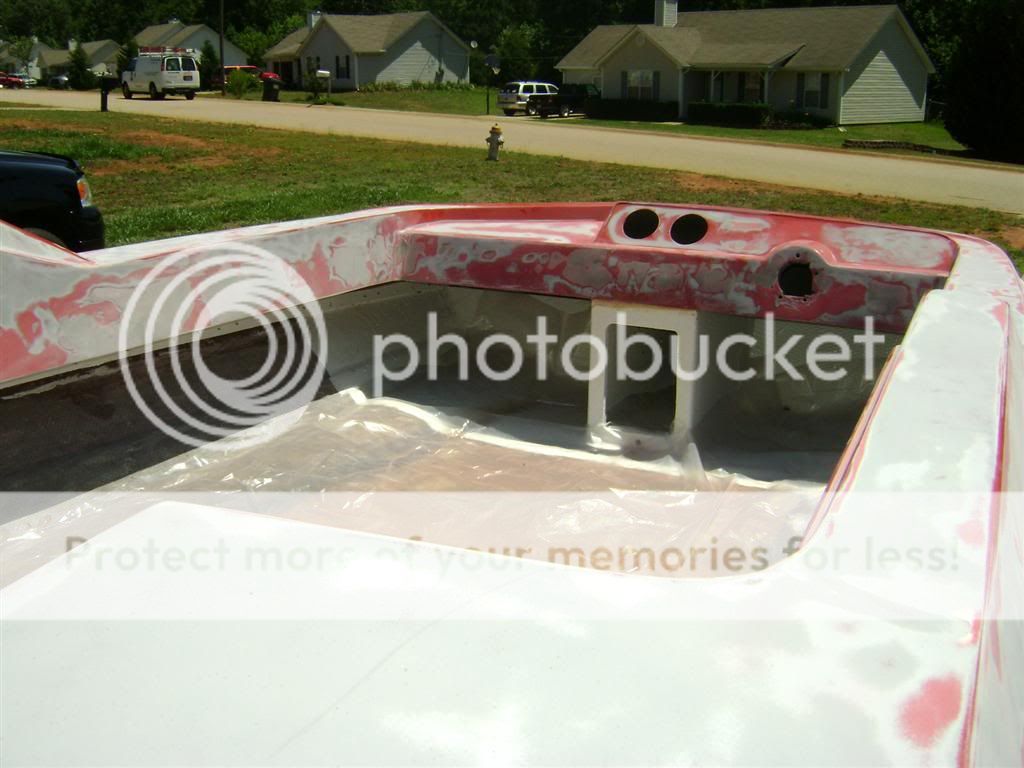

Re:New Project - 71 Glastron GT-150 14 years 5 months ago #62469

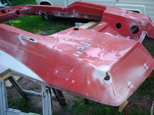

I didn't want you guys to think I had given up, so here's a meager progress report. The hand sanding is taking it's toll, but I'm determined to get her finished! I wanted to do a little body work on the rough spots of the deck, it may be a while before I'm able to swing the nice padded bolster boards that go into the interior. Almost ready for some primer and paint on the topside..........
With all the high quality renovations and restorations being completed lately, I feel a little hesitant to post my humble attempt. I may not tackle another one, but I'm going to give this my best shot and by golly I'll get her done eventually! :)
Re:New Project - 71 Glastron GT-150 14 years 5 months ago #62477
Yeah Mark i know the felling. She's looking great though, good progress still keep up the good work.
Re:New Project - 71 Glastron GT-150 14 years 5 months ago #62482
  • Andgott
  • Andgott's Avatar
  • Posts: 1245
  • Karma: 72
Looking good, mark... This HAS to be the most frustrating part of the restoration process- you sand over and over, think you have it all, only to find more sanding that needs to be done. I feel your pain, I just went through it! But, it WILL get done, just keep focusing on the end result and you'll be fine!
How do you plan to paint the boat? Roll and tip like the hull? You may have mentioned it before but I don't recall, and I'm on my iPhone right now and can't easily scroll through the old posts...

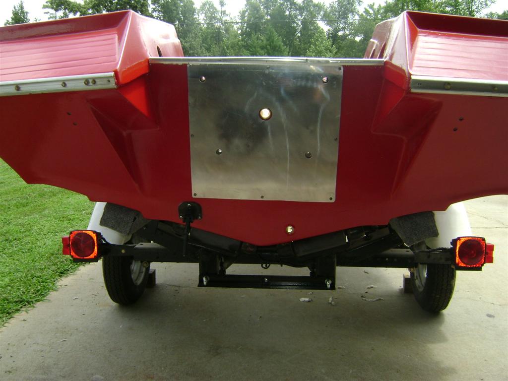

Re:New Project - 71 Glastron GT-150 14 years 3 months ago #65096

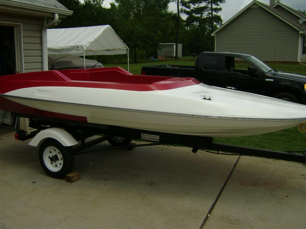

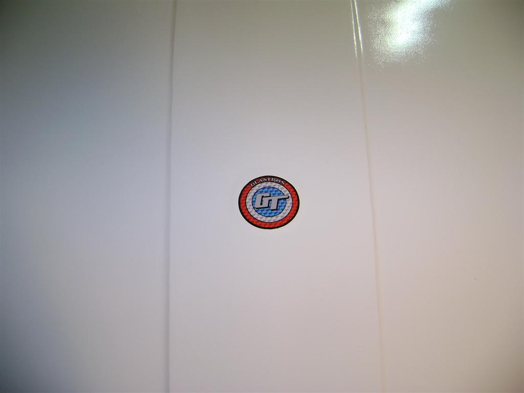

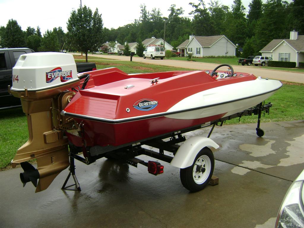

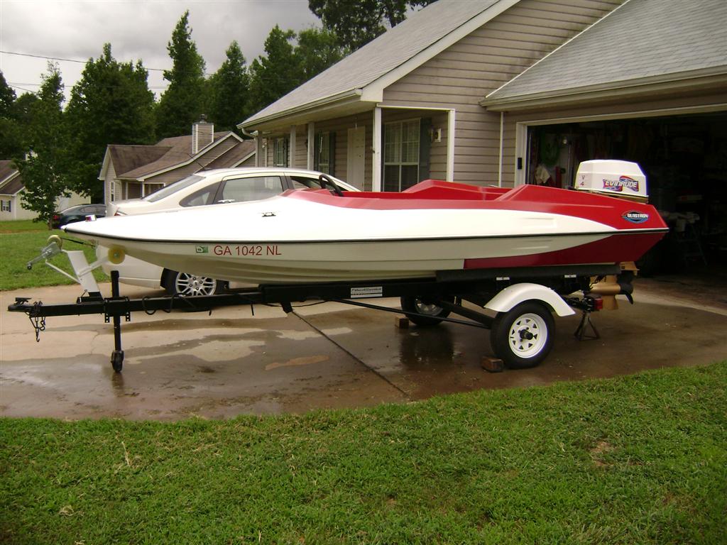

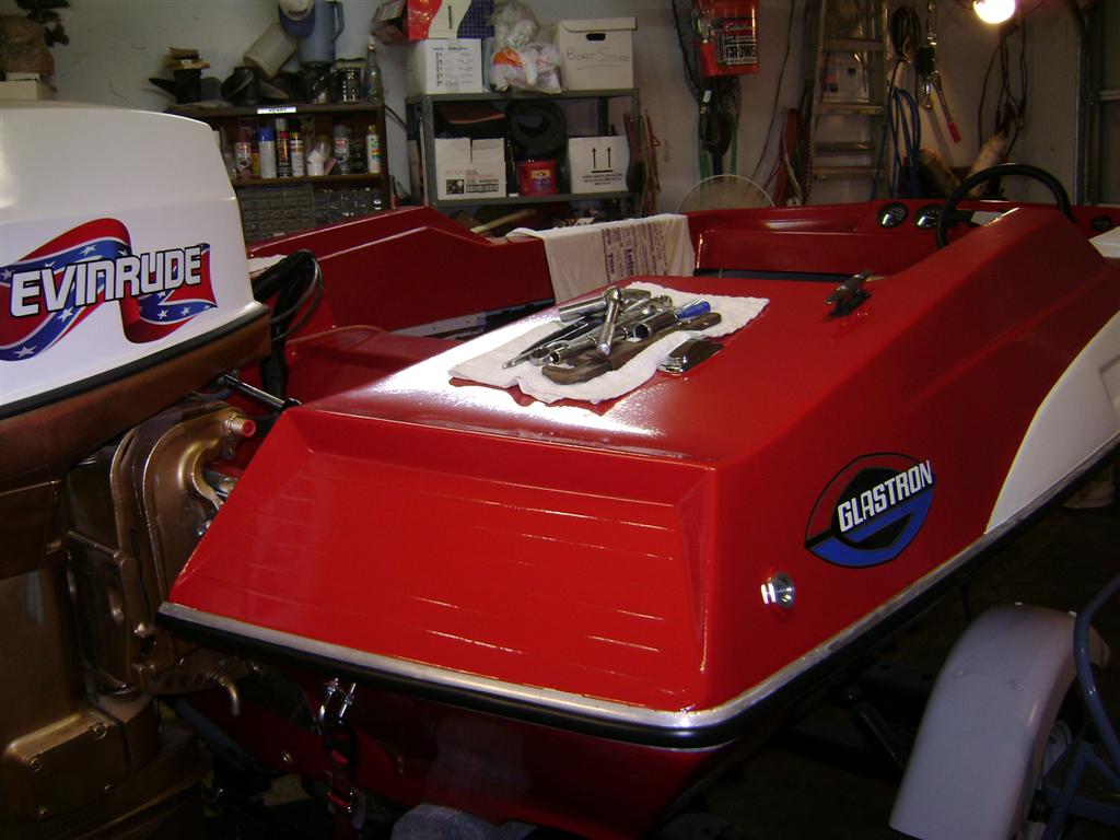

Well the painting is finally done, not perfect or show quality but not bad for my first attempt - by my standards anyway?...... Fabbed up a stainless steel plate so the motor doesn't "eat" my new paint job, and started mounting the "goodies" on her, hope to get some more done tomorrow. I'm pooped!
Re:New Project - 71 Glastron GT-150 14 years 3 months ago #65099
Man... that looks good.
Great work Mark, I love the stainless plate it looks factory.
1963 Starcraft 14' Ranger
Re:New Project - 71 Glastron GT-150 14 years 3 months ago #65100
She's looking fantastic Mark, great job buddy!!!!!!!!!!!!!!!!!

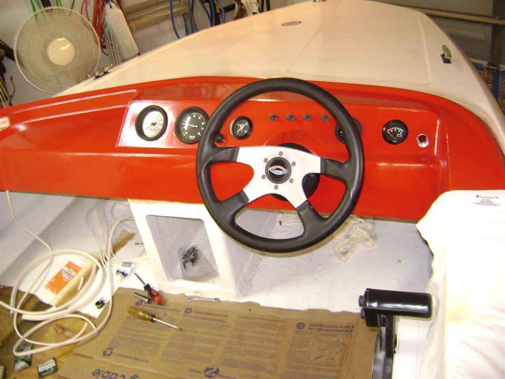

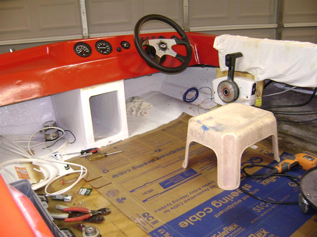

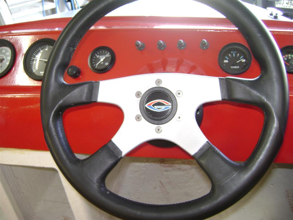

Been making a little headway here and there, thought I'd give a progress report. Steering, controls, and electrical are all in, gauges mounted and mostly wired, started adding a little "make up" to keep me motivated.... :P
Re:New Project - 71 Glastron GT-150 14 years 3 months ago #66083
  • Shelby18
  • Shelby18's Avatar
  • Posts: 436
  • Karma: 18
Looking good Mark! Can't wait to see this one done.
Great to be on board.
Rick
Re:New Project - 71 Glastron GT-150 14 years 3 months ago #66088
Outstanding work buddy she's looking GREAT!!!!!!!!!! I'm with Shelby, can[t wait to see her complete!

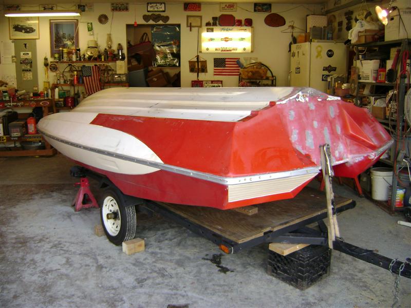

Re:New Project - 71 Glastron GT-150 14 years 3 months ago #66245

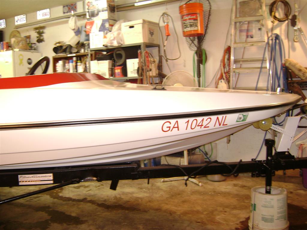

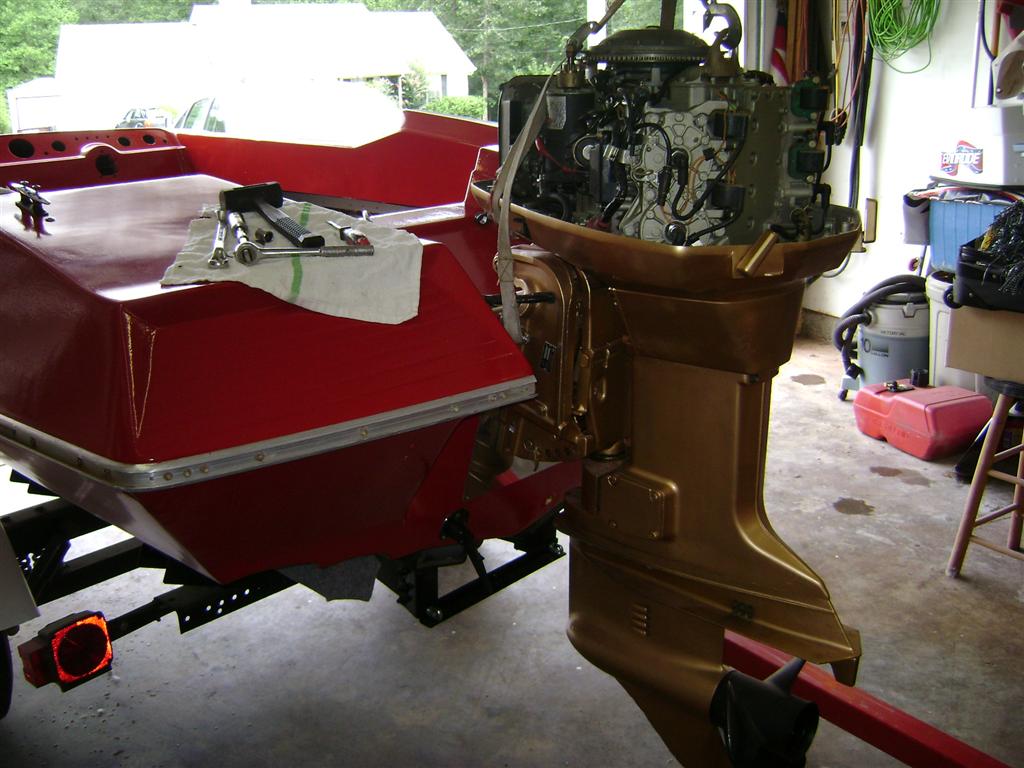

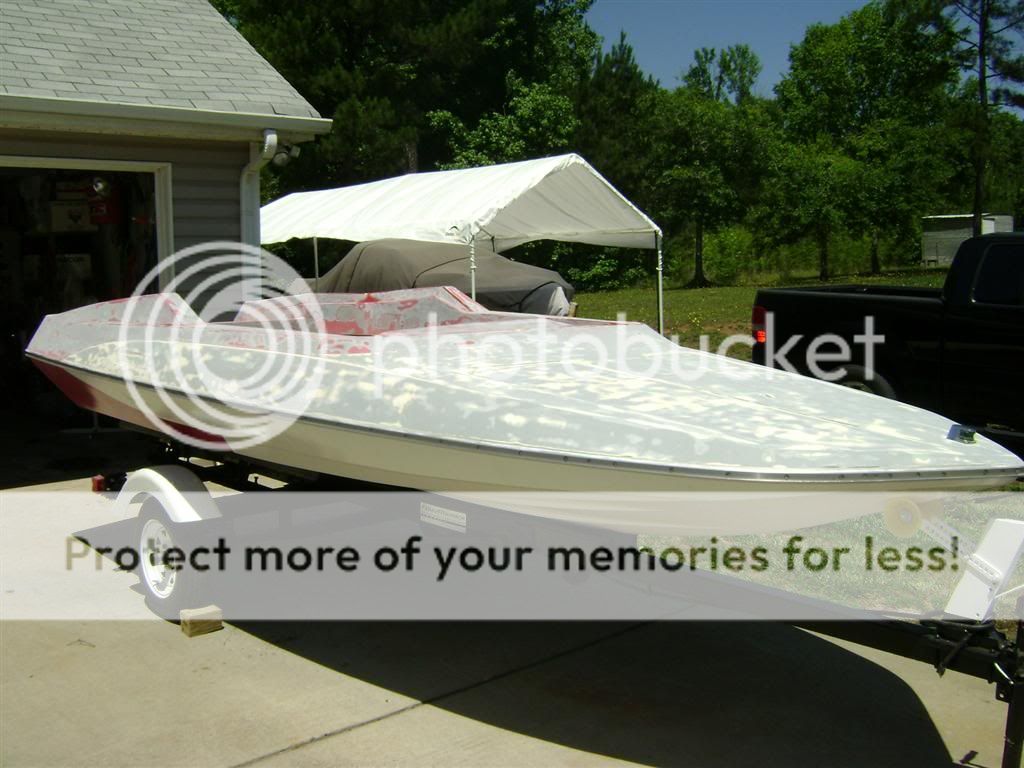

Two steps forward and one step back! I've had jack stands under the trailer while working on the boat, mounting the motor, etc.. (Keeps everything stable while you're crawling in and out, hanging motors, gotta be safe ya know.) When I went to push her out into the driveway yesterday to test run the motor, I moved the jack stands under the stern and the tongue of the trailer went straight up - the skeg hit the carpet (luckily) on the floor! Seems the weight distribution is a little (!?!?) off with the big V4, battery, etc. in the boat.
The Holsclaw trailer has bolt holes to move the axle back 4 1/4", so guess what's on the agenda for Saturday. :S
