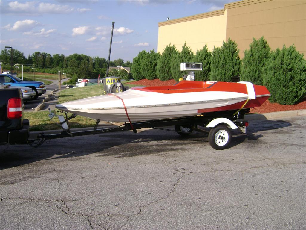

22 hrs of driving (over 2 days), haven't totaled up the gas receipts yet (probably don't want to, it's money GONE now!), but she's home! Needs stringers, floor, interior, and a little cosmetic work on the hull. Here we go..... ;)

Nice boat . Seems Ive seen that one before on Somebodys Project page . Gas is only Gas . Youll have a good story to tell when your done ..

Probably on the CGOA site, Donrh out of VA Beach sold it to me. He's replaced the transom, and done a lot of the hard work already. Still needs new stringers and floor installed (old stuff already out), interior, and some minor cosmetic stuff.
He burned a CD of the pics documenting the restoration so far when I picked it up, fed me breakfast the morning I arrived, and treated me like family while I was there. All the hardware, trim pieces, windshield frames, etc. came with it (in boxes) as well as some supplies to get me started. First Rate guy and does great work bringin' 'em back. He did a GT-160 that looks fantastic, and several others including a hand built "DarkWater" woody he recently finished up.

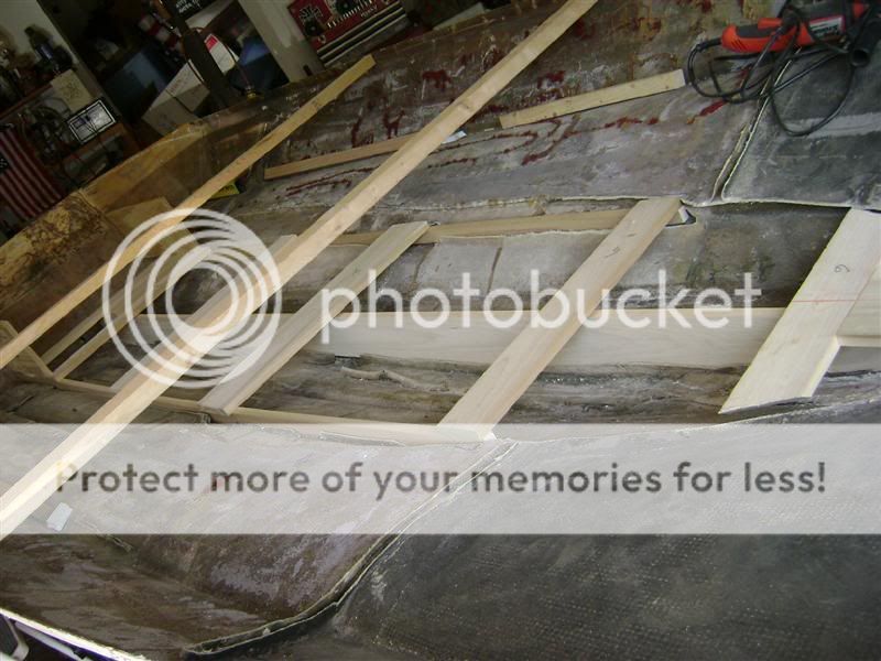

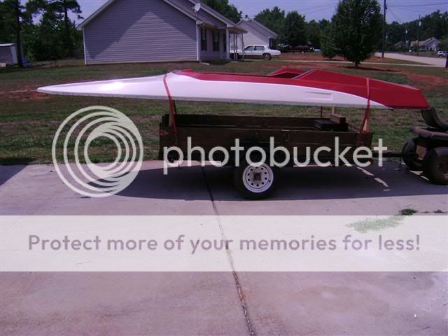

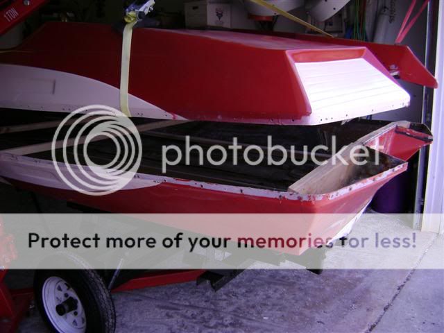

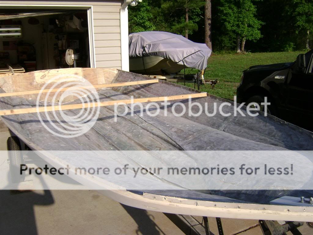

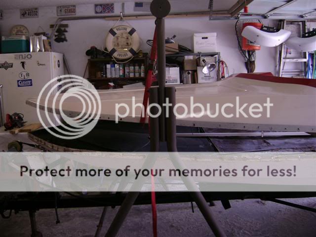

Pulled the deck today getting ready for stringer and floor work
Bow up Stern up She's clear Topless :ohmy: Where am I gonna put this? Ready to go to work!

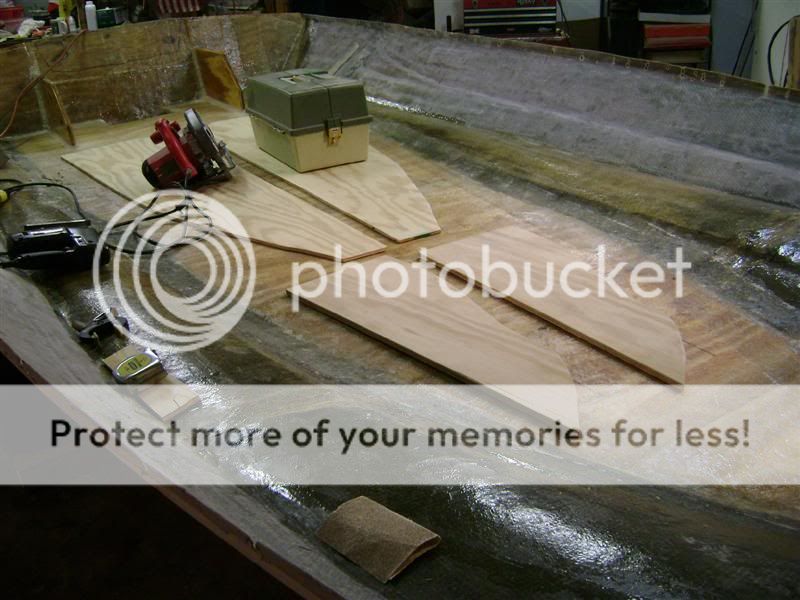

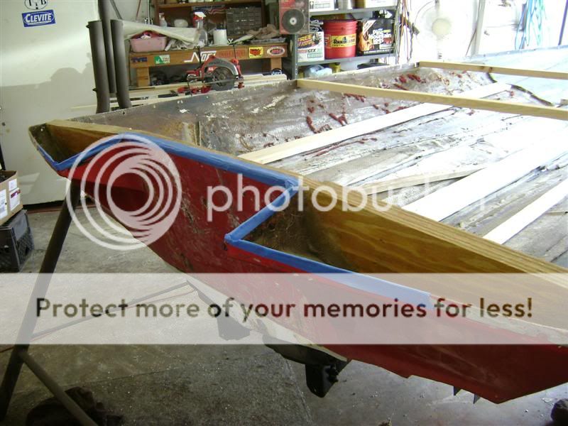

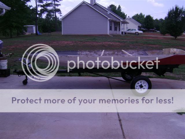

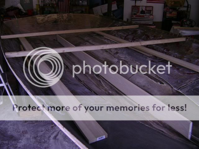

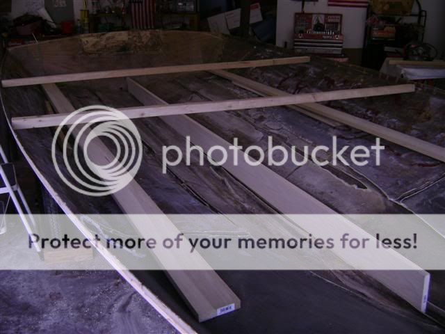

Stringers and cross braces cut, built a set of "knees" for the transom, since I'm not sure yet what motor will be going on her. (Hopefully, the Merc 1000, but that's been back burnered until the boat is back together.)
First fitting
After I got tired of the rough edge of the fiberglass hull tearing up my hide, I figured out putting some tape over the edge helps alot! Duh.

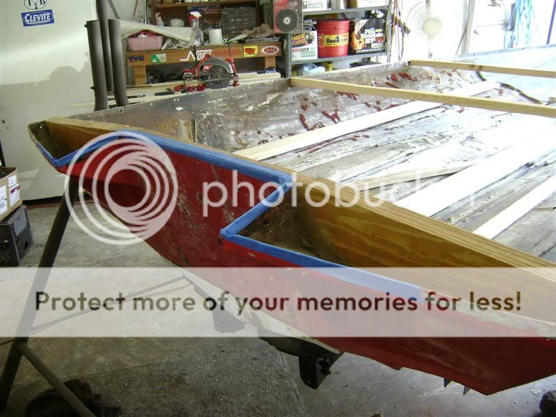

How I spent my day; Speaking of stupid moments, let the grinder get a little crazy and now have another spot to fix in the hull. Live and learn, and quit when you know you're getting tired. :S

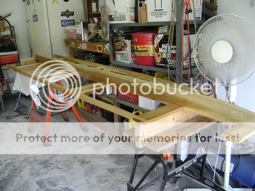

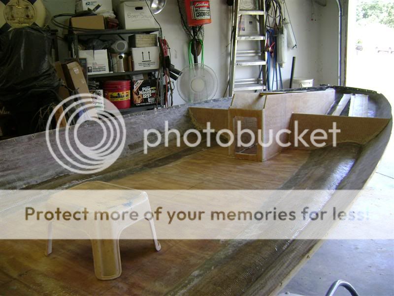

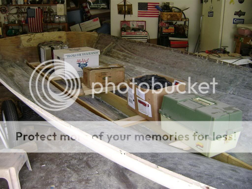

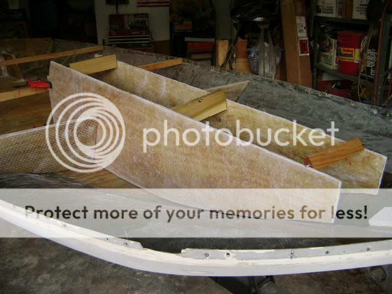

Finally got the hull cleaned and ready for re-construction; Applied poly resin to the stringers, one layer of Biax and cloth to the bottom of the main: And got them bedded into the hull with PL Premium (Didn't go too bad for a first time 'Glasser, shure kicks quick when it's 97* in the garage!)
The cross braces will come off to glass in the stringers, but wanted them to hold the stringers steady while the PL set up. That was enough for today anyway. ;)

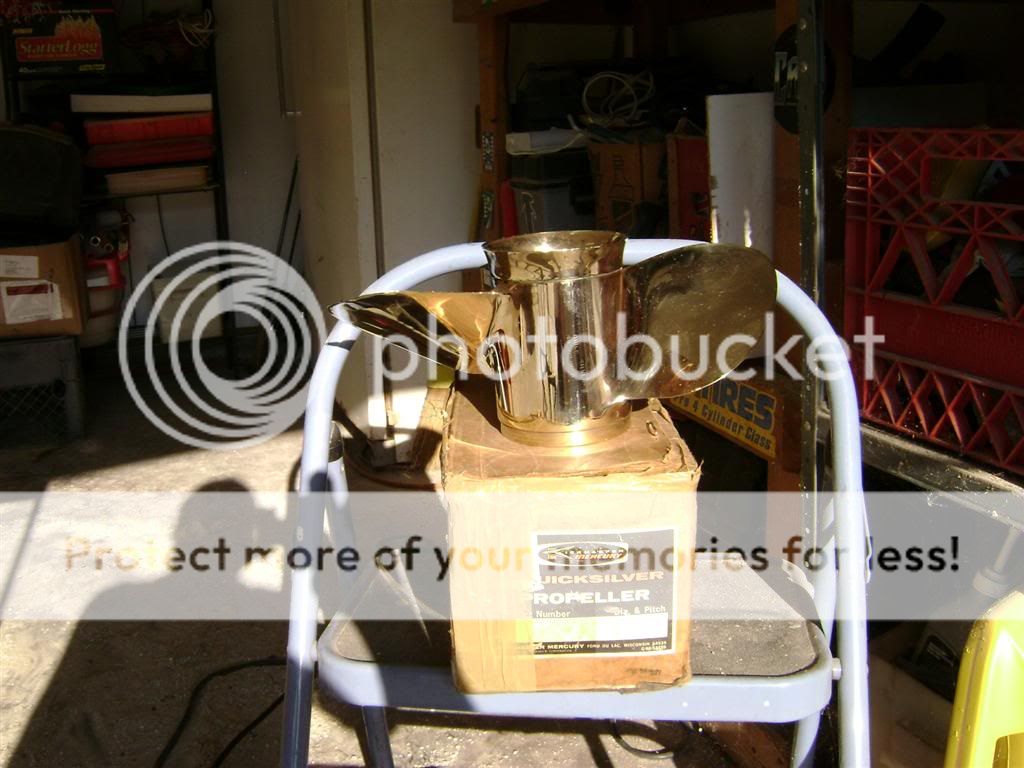

A great friend sent me my first "bling" for my project, I am so proud!

Modest progress report - stringers and cloth reinforcements are in; Foam installed between stringers; And floor is cut and temp installed to check fitment.

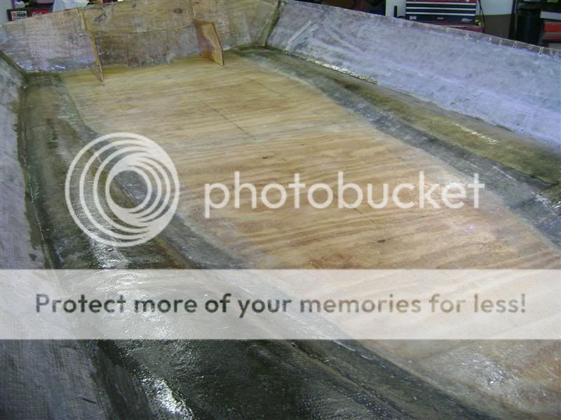

Been a while since I posted any progress, 'cause it's been slow going around here. (Not for lack of trying, I assure you!)

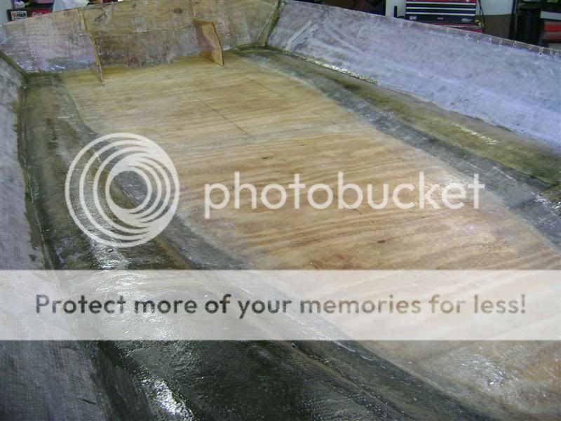

Got the floor glued, screwed, and glassed.....

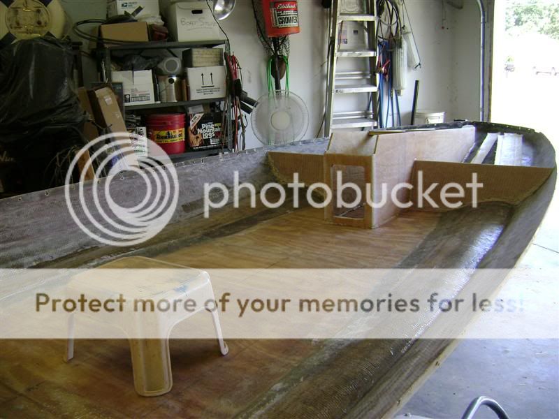

Re-fit the deck to take measurements for the ski locker / console. Cut out the pieces and covered them with csm, kick plates got woven for strength.....
Test fit and trim, test fit and trim, you get the idea
She's assembled and in, gotta wait till next weekend to glass it to the floor, out of resin again. :S

Looking good, Mark!!!! What's the pitch on the "bling"?
Re:New Project - 71 Glastron GT-150 15 years 2 months ago #42639
  • MarkS's Avatar Topic Author
Thanks Kerry. It's a 13(+3/4?)" x 19P. The motor has a 21P on it now, but it was rigged on a (15'or 16' Starcraft ?) lummie originally.

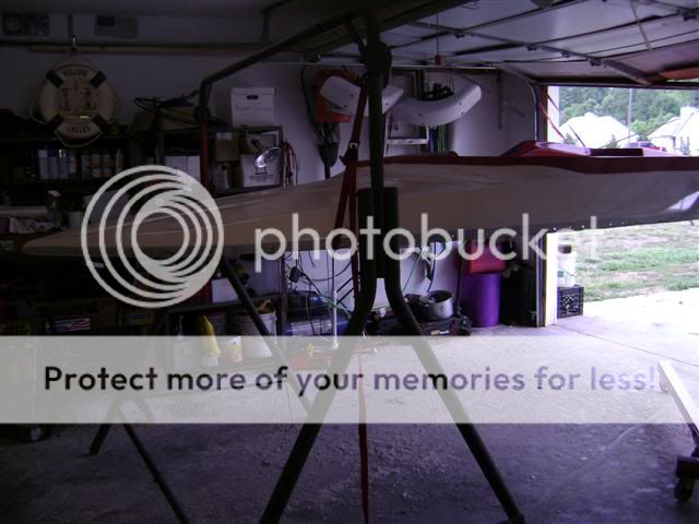

Just a little progress report before the deck goes back on the hull, hopefully tomorrow. Most of the "woodwork" and some areas that will be hard to access once the deck is on have been painted, but I didn't want to paint the entire floor until I figure out and install the seating supports.
I tried out the new drain tube installation tool, using 5200 to seal it in. (Final "crank down" on the tube will take place tomorrow, after the sealant has partially cured.) My tubing cutter is shot out, but I managed to get it done anyway. Left 3/16" past the mark for transom thickness to make the flare, looks about right;
