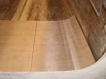

I am not familiar with Span America boats, but after looking at your pics it appears the boat has a balsa core floor. If you look at the sides of the boat you can see a projection of an inch or so into the boat and then the floor continues down, across, and up the other side where it goes projects back to the wall again. If the wet side of the floor does not have the same geomtry, it's probably balsa blocks used to stiffen the floor. It is fairly common on boats of that era, and it almost always rotten in a boat that has been stored outside as that one appears to have been.
Re-doing a balsa core floor is somewhat difficult if you have never done one before, but there is a number of resources in this website to help you. As far as drilling to check for construction details, any holes you drill will be minor repairs compared to some of the work other areas of the boat requires. I would drill the floor to confirm the balsa wood existence and condition.
The seat is probably hollow, built as a separate assembly and then tabbed to the floor. It's probably filled with foam blocks as is the front chamber. If the drain tube through the seat wasn't sealed well, or has been cracked by ice, the foam in the seat is probably waterlogged.
That boat will need a lot of work. It really should have the deck removed to do the transom correctly.
I'm not sure what your arrangement with your friend is, but if the floor is balsa and it's rotten, you might want to consider opting out.
I have attached a pic of another members balsa floor repair. If you search the Main Forum and the Project Forum for "balsa floor" you will find quite a bit of info.

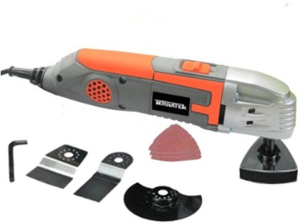

do you think one of those multipurpose dremels would work?
Re:1960's era Span America restoration questions 11 years 9 months ago #95559
  • Thank you received: 5
The oscillating multi-tool is the way many of us go, they're pretty cheap at Harbor Freight or Northern Tool....less dust than a grinder but pretty slow going. (Just have to be carefull about how deep you're cutting and at what angle!)
Some of the gang have good luck doing it "manually" with a hammer and chisel, prybar, whatever you have to work with. MUCH less dust this way, but I think it would be a bear to get started if the floor or tabbing wasn't de-laminating. Everyone has to find the method that works best for them.
