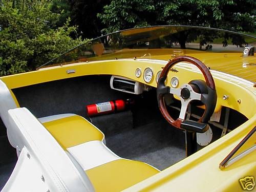

Currently, I am running a Classic 50 Merc. I'm trying to fix up or buy a good '75 horse McCulloch. How big do you suppose would be reasonable? Six cylinder Mercs and big V4 OMCs are a lot easier to find. When I was a Kid, my dad had a couple G3s. Those had a 75 Evinrude, a 75 Scott (which worked better), and a Merc 1000. The Mercury was quite peppy on it.

Gorgeous boat SportLido, welcome aboard. (Clicking on the pic took me to your photo hosting site, please share some more pics with us when you get a chance!)
