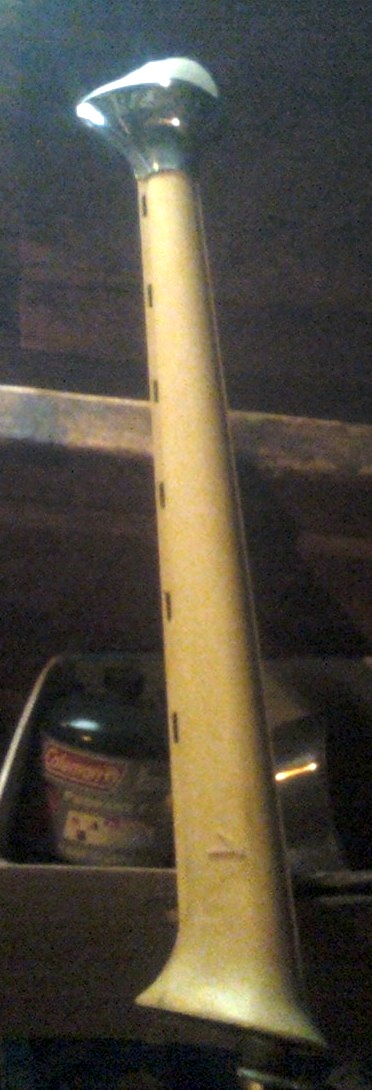

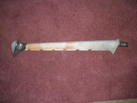

#1 is the Stern Light / Flagpole (photo here of what it looks like....)
#2 would be the Reverse Steering Unit Parts #1-3 only.

the stern light comes up once in awhile on ebay,i cant remember who made it.
the problem seems to be with them that the plastic ,where the flag rings go are usually broken out,but there are some out there ,do a saved search for vintage stern/anchor lights,ya might get lucky,john

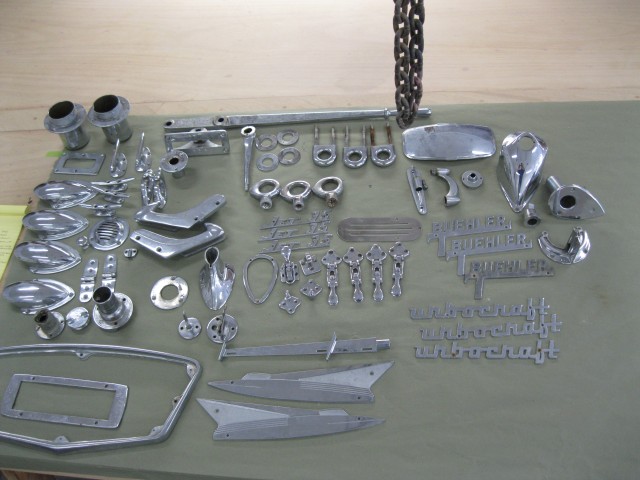

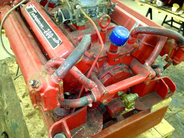

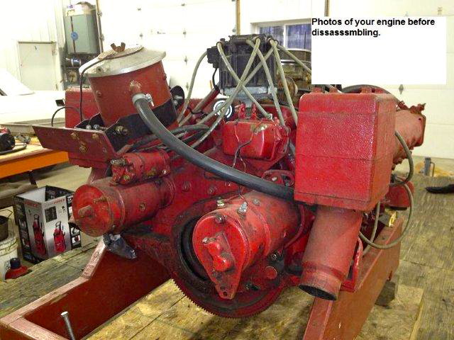

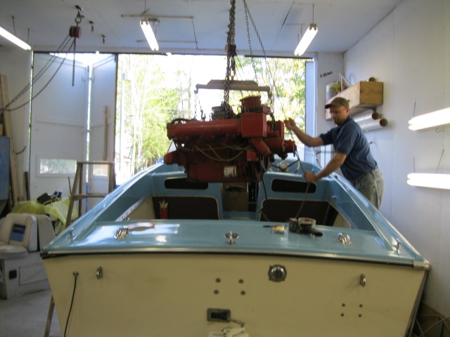

The restoration has started! While on the way to the St John's Concours to show both my '59 Country Squire & my '59 Colony Park I stopped by Marine Services to check on the progress. Being my first time there Dave & Scott showed me around, talked shop with my auto restorers, and let me peek at my boat for the first time. The work they do is really impressive, and when they saw my Colony Park that was just restored we all knew that this was a perfect fit.
Here are some photos of the progress. I'll update more as the restoration progresses.
Pulling the motor. What we found out here was that this block was replaced some time back with a newer year. We already have spoken to a engine re-builder that has a correct year motor that will be built for this boat.
The engine bay sans the motor
Repairing the glass
Parts to send for re-chroming
Great to be on board.
Rick
Re:Restoration 1962 Buehler Turbocraft Jet 35 14 years 2 months ago #65893
Looks like she's in good hands there Rick, thanks for sharing the progress report. After checking out your other restoration threads (automotive), I can't wait to see how the Buehler turns out!
Re:Restoration 1962 Buehler Turbocraft Jet 35 14 years 2 months ago #65937
man oh man....thats gunna be one heck of a re-chroming bill!
Re:Restoration 1962 Buehler Turbocraft Jet 35 14 years 2 months ago #65986
  • Shelby18
  • Shelby18's Avatar Topic Author
  • Posts: 436
  • Karma: 18
Chrome plating $4157.00
About 1/5 the bill of the Mercury Colony Park... ;)

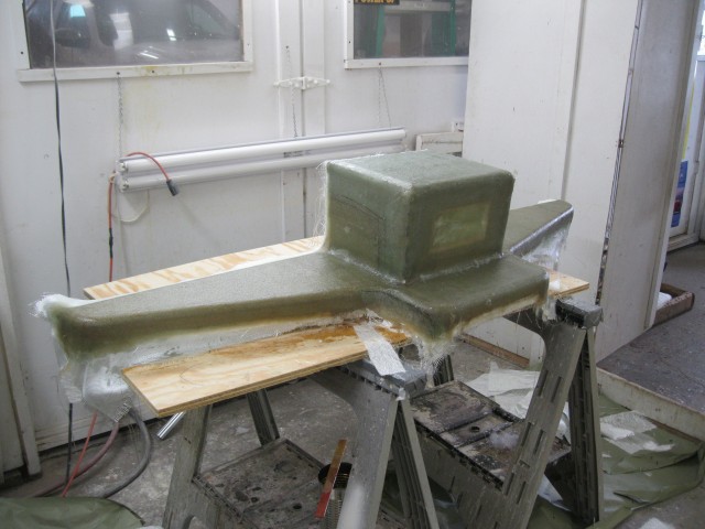

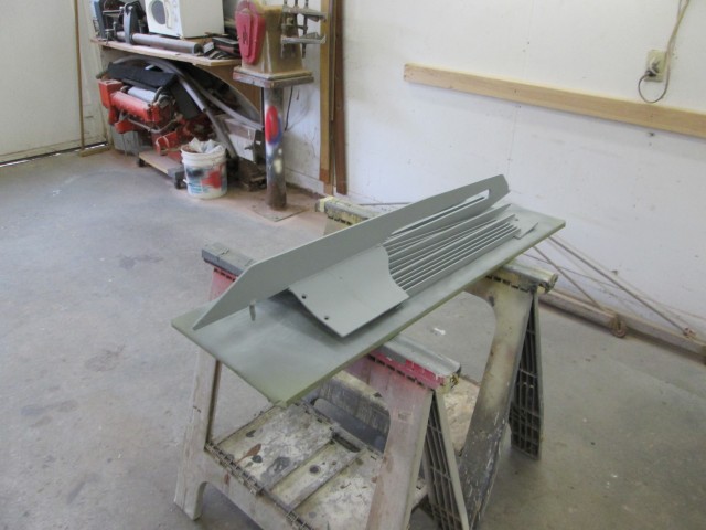

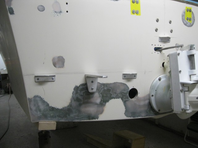

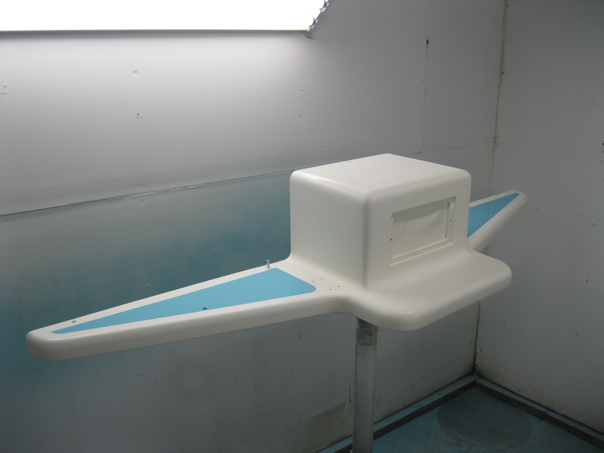

Well in two months more progress has been made. :)

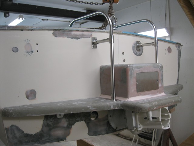

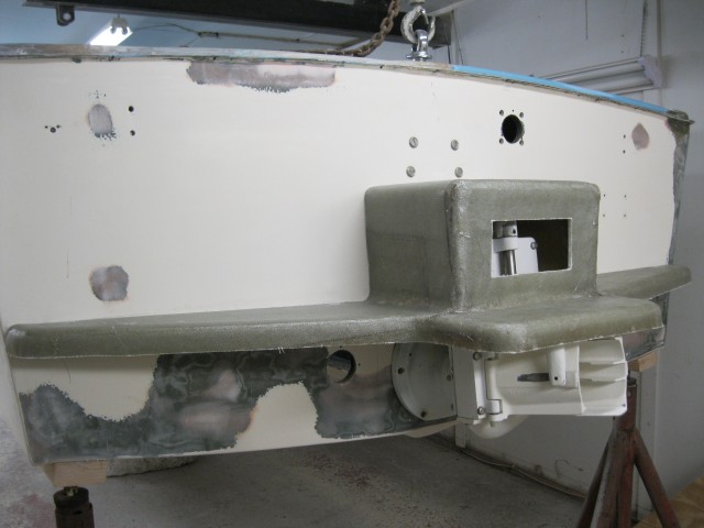

The delay was due to me wanting a boarding area that fit in line with what Buehler had for the Queen Bee. Since mine did not come with this and the Queen Bee type just didn't look right, we came up with something along the line of what we thought Buehler might do for a lower line boat.

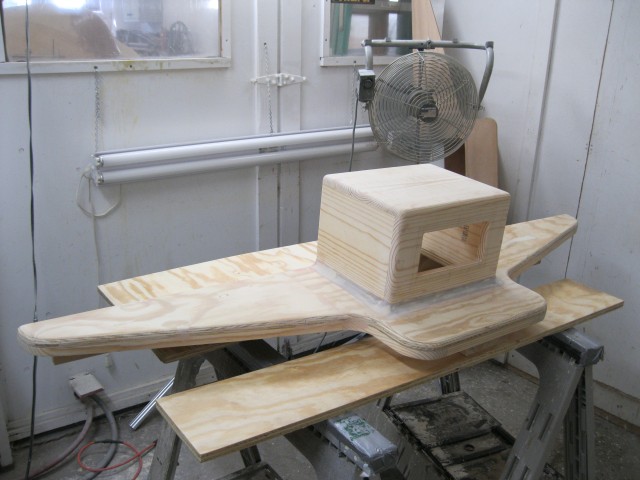

This was the first prototype mock up
After some modifications this is the plug
Port side of the lay up.
Mounting hardware
trial fitted. Notice how we have the access area which will be covered with the Buehler logo plate
Custom bent handrails now attached to the platform to give more strength. The access plate is also in place.

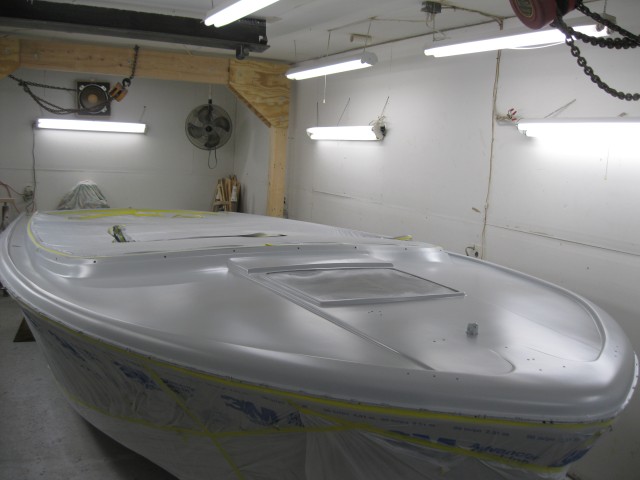

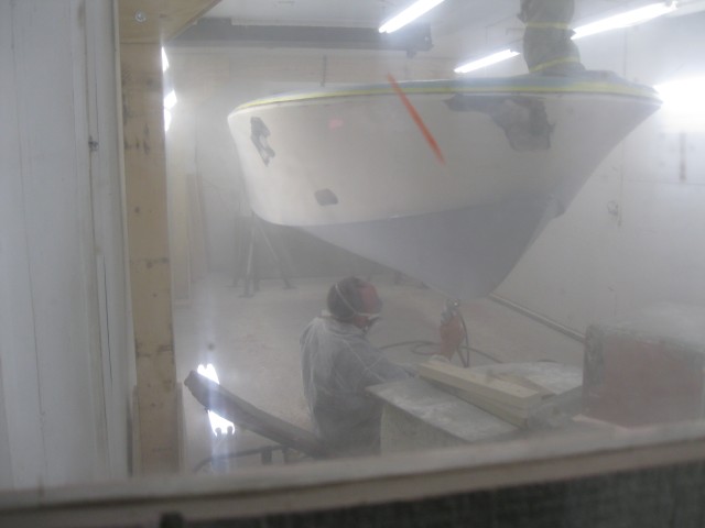

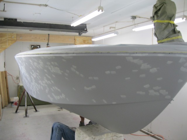

Applying the Feather Fill
Primer being spot puttied and sanded ready for color.
Oh, and regarding the automotive restoration, we came away with a Lions Award at the St. John Concours d'Elegance. Not bad for the first time out! ;)
Rick
Re:Restoration 1962 Buehler Turbocraft Jet 35 14 years 4 hours ago #70497
Rick, That looks really cool! I looked at a 1967 Bolero yesterday that is a total wreck. I am interested in the jet unit and tail section that has the built in step that Buehler offered on all of their boat lines after our 1962. I am thinking of using that unit for the very same reason that you are building the swim platform. It may not be original, but in the long run, I think it will make the boat so much more user friendly and not alter the value of the boat.
For these reasons, I am leaning towards a "retro restoration". That would mean, some minor upgrades. They include new gauges in classic design, sound insulation of the motor box, interior lighting of the glove box, front seat storage areas, and gunnel lighting. Other improvements will be stiffening of the foredeck, and maybe a snap in style of carpeting...All coming together and hopeful for a Spring christening!
Re:Restoration 1962 Buehler Turbocraft Jet 35 14 years 4 hours ago #70499
  • Shelby18
  • Posts: 436
  • Karma: 18
Thanks Royce!
One of the thoughts with going this way was ease of use for my kids. They are still young and have their mothers height challenges.
We can always take the boat back to original by filling in the holes and repaint. But I can't think of any reason someone would want to take it off.
Glad to hear yours is coming along! Can't wait to see it in all it's glory!

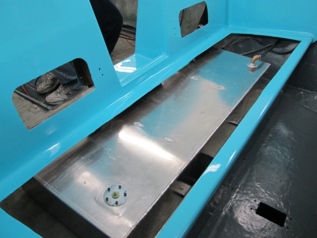

Interesting on the fuel tank placement. Mine is in the stern. My first 1960 jet 35 had the tank under the front seat. My 1962 has a fiberglass enclosed are directly under the front seat that has no opening for storage, so I am thinking it may have floatation foam in that area. The battery is located under the front seat walk through in a recessed area in the floor. I also have two hull plugs aft of the engine on etiher side of the engine bay that I have been unable to get removed.

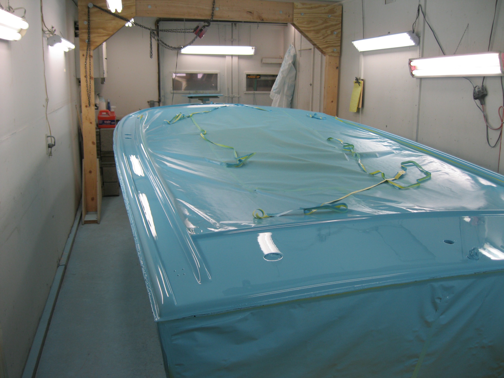

Here are some updated photos...
And my favorite..it looks like something out of Star Trek

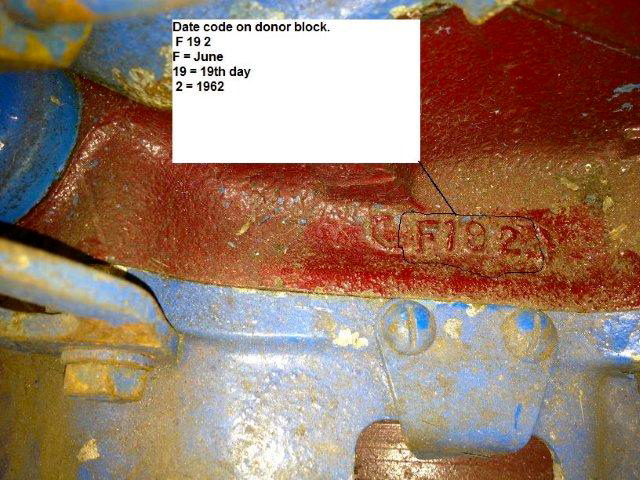

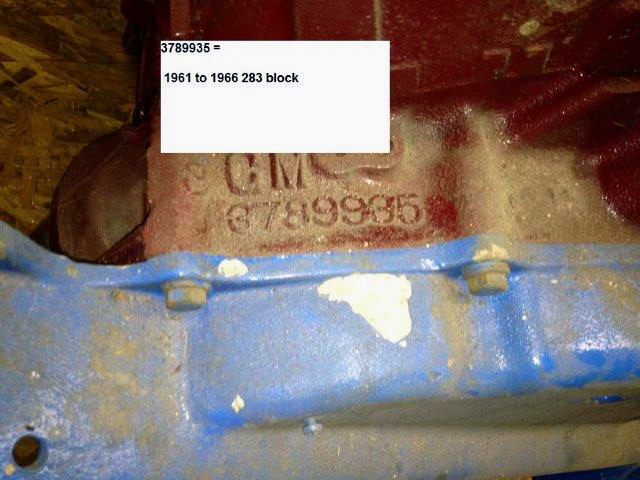

The 283 block in my boat was from 1967. A correct block was needed to bring the motor in line with the year of the boat.

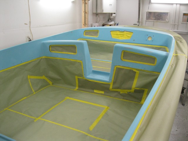

It's about time for some new shots!
Rear port deck with new paint applied.

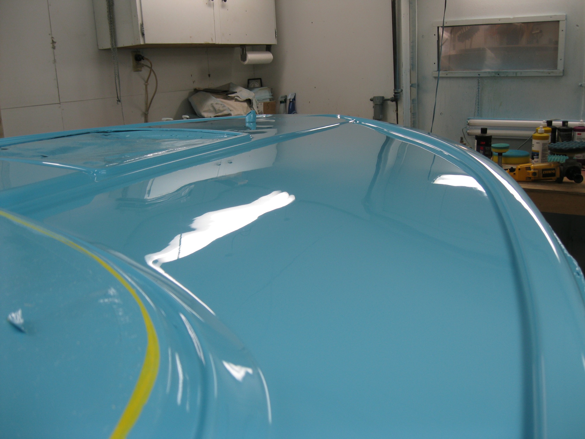

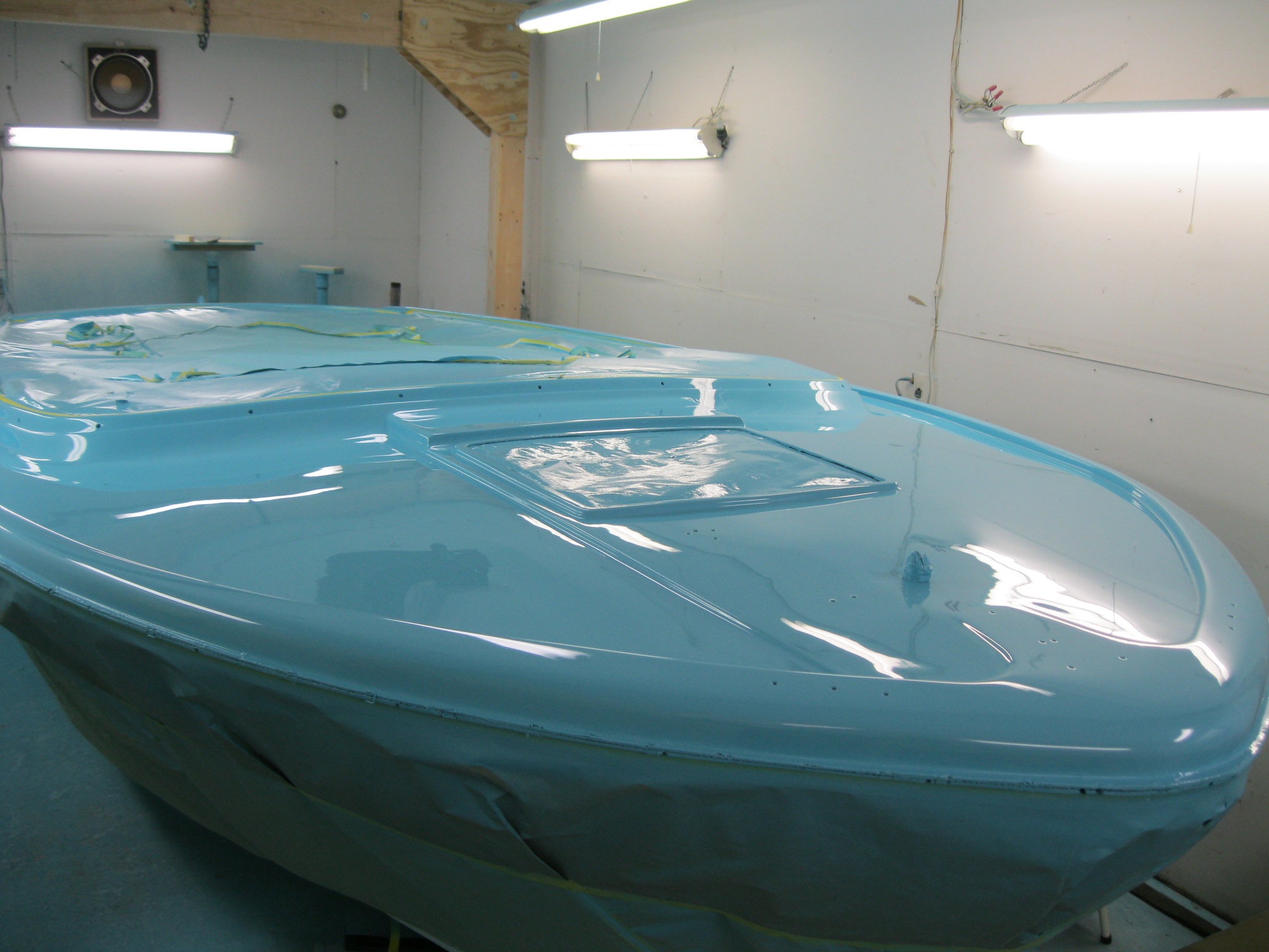

View of starboard front deck after buffing.
Starboard front deck looking forward.

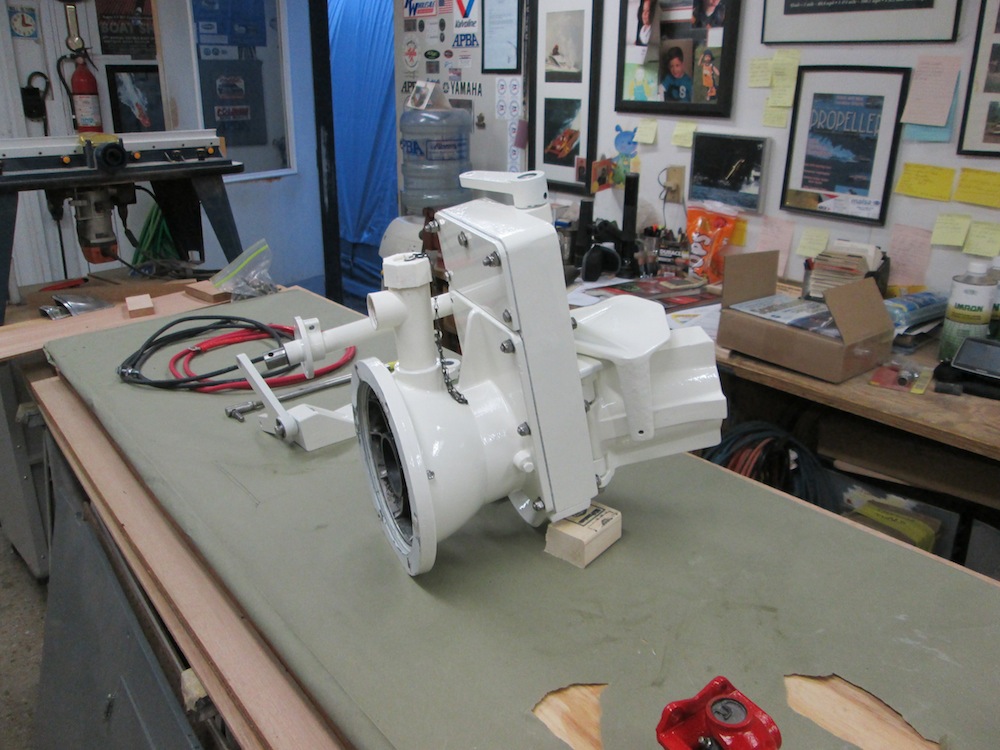

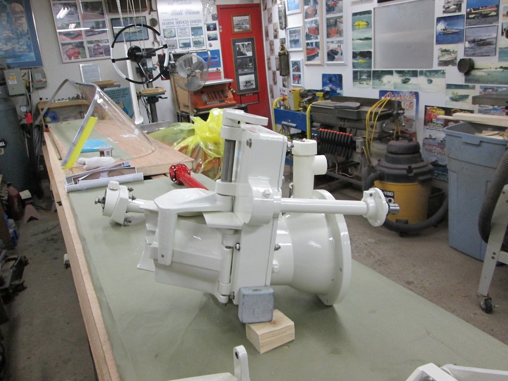

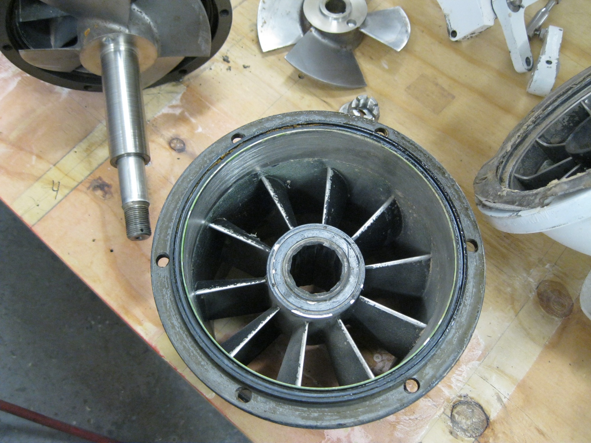

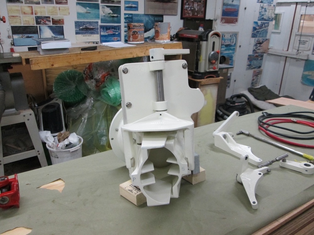

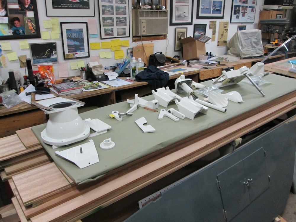

Hamilton pump apart so we can determine what needs to be replaced.

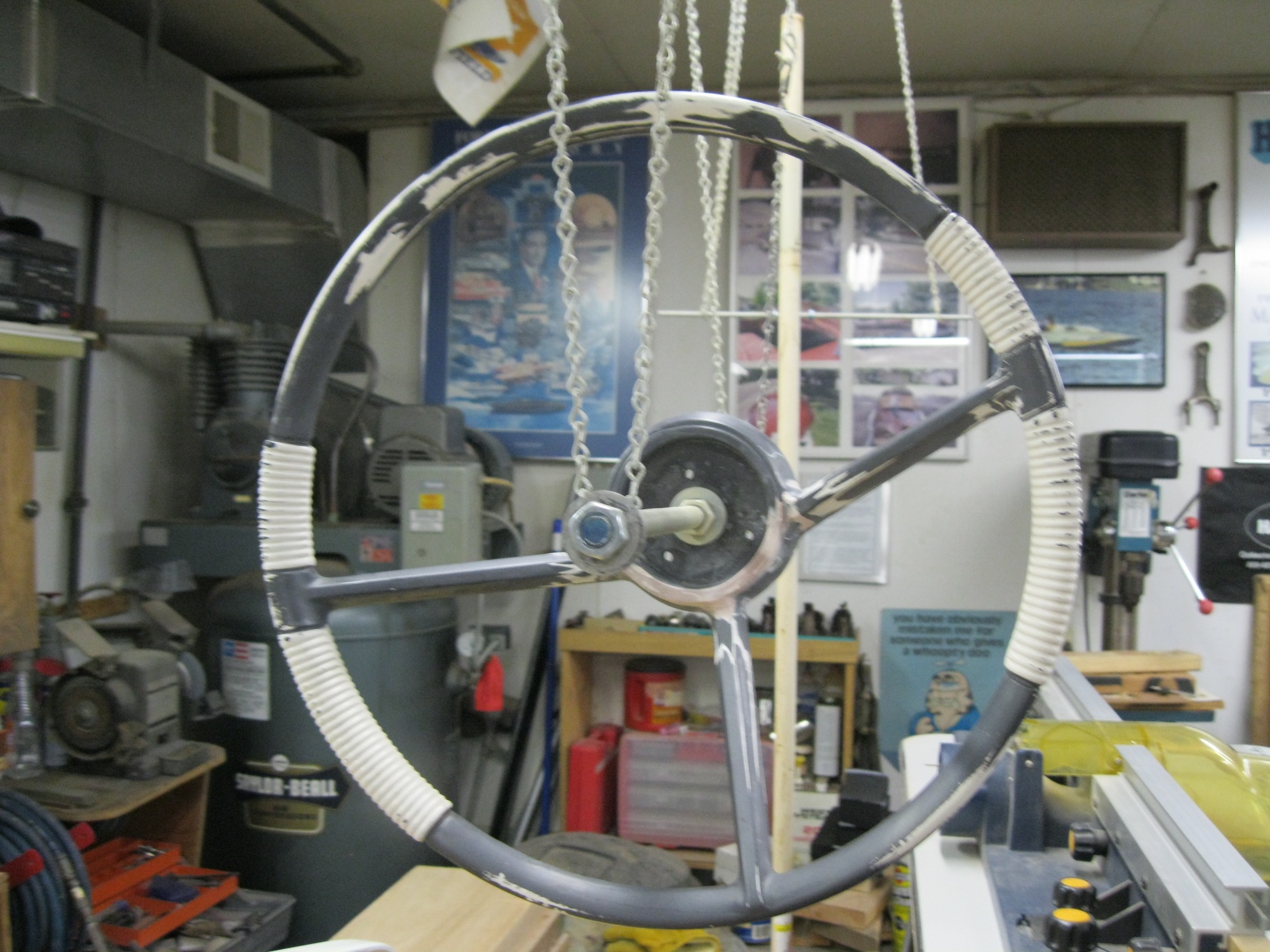

Front view of steering wheel repaired ready for paint.

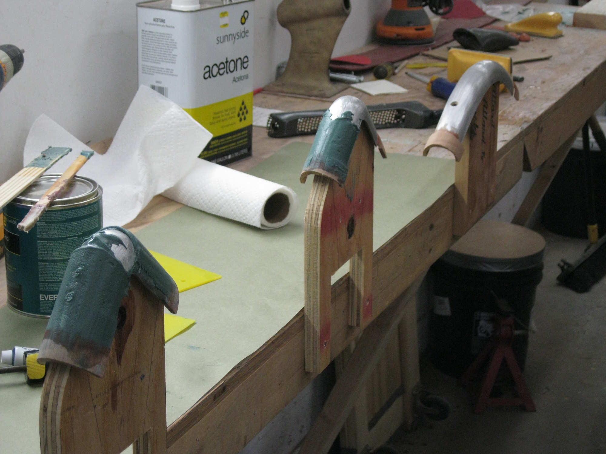

Making casting paterns for rub rail end caps.

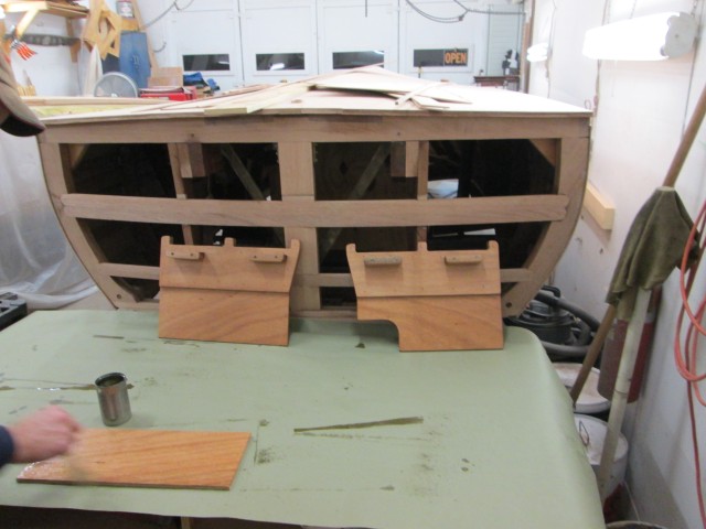

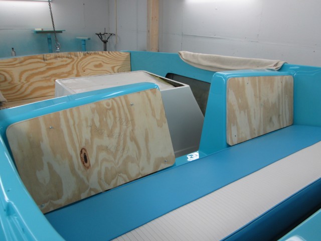

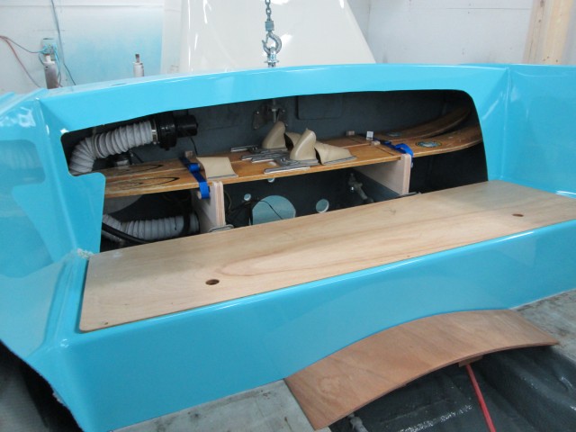

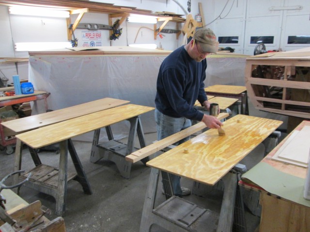

The restoration is progressing. We have the turbo back from getting restored, the seats are getting redone to better match the color of the boat, and new wood because the old wood was warping.

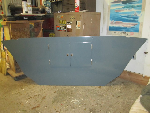

Some other mods we decided to add. A storage wall behind the foot rest to keep stuff from bouncing out, and a hidden ski rack.
The new seat wood
Epoxying the wood
The new storage bulkhead, and footrest.
The hidden ski rack, when the seat back is put in place you'll never know they are there.
The ski rack pieces epoxied
Rick

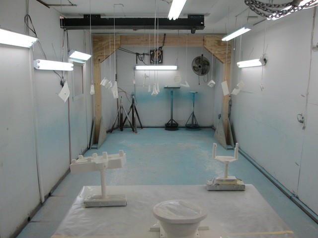

Some more progress...
Bulk head painted with hardware installed
Intake with new plating
New fuel tank installed with fittings
All pump parts repainted

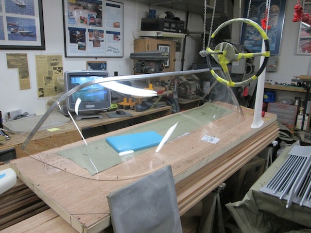

Windshield polished

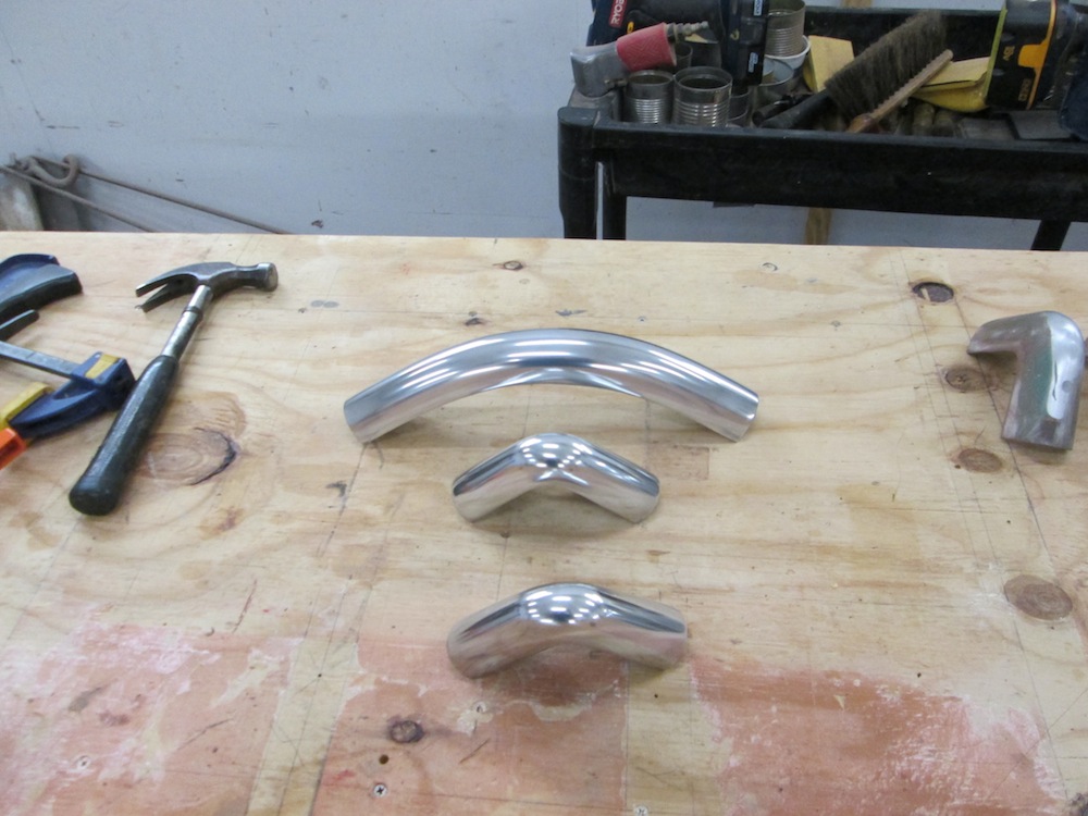

Remember those castings made for the rub rail end caps? Here are the new parts all polished up.
Rick

Re:Restoration 1962 Buehler Turbocraft Jet 35 13 years 5 months ago #77238
  • Shelby18
  • Posts: 436
  • Karma: 18
Thanks Bob! It's not much longer until this baby hits the water!
The pump is now painted and assembled. The optional reverse steering will be installed shortly. I'll update the photos then.
Rick
Re:Restoration 1962 Buehler Turbocraft Jet 35 13 years 5 months ago #77399
how did you do the windshield polishing?
Re:Restoration 1962 Buehler Turbocraft Jet 35 13 years 4 months ago #77561
  • Shelby18
  • Posts: 436
  • Karma: 18
From Dave @ Marine Services:
"The windshield polish is three steps. First we used 3M compound #05973 with a foam waffle pad. You have to keep wet with water as you are buffing. Then we used Meguiar's #17 cleaner also with a foam pad and water. Then we finished up with Meguiar's #10 polish. This takes about 6 to 8 hours if you are doing inside and out."
