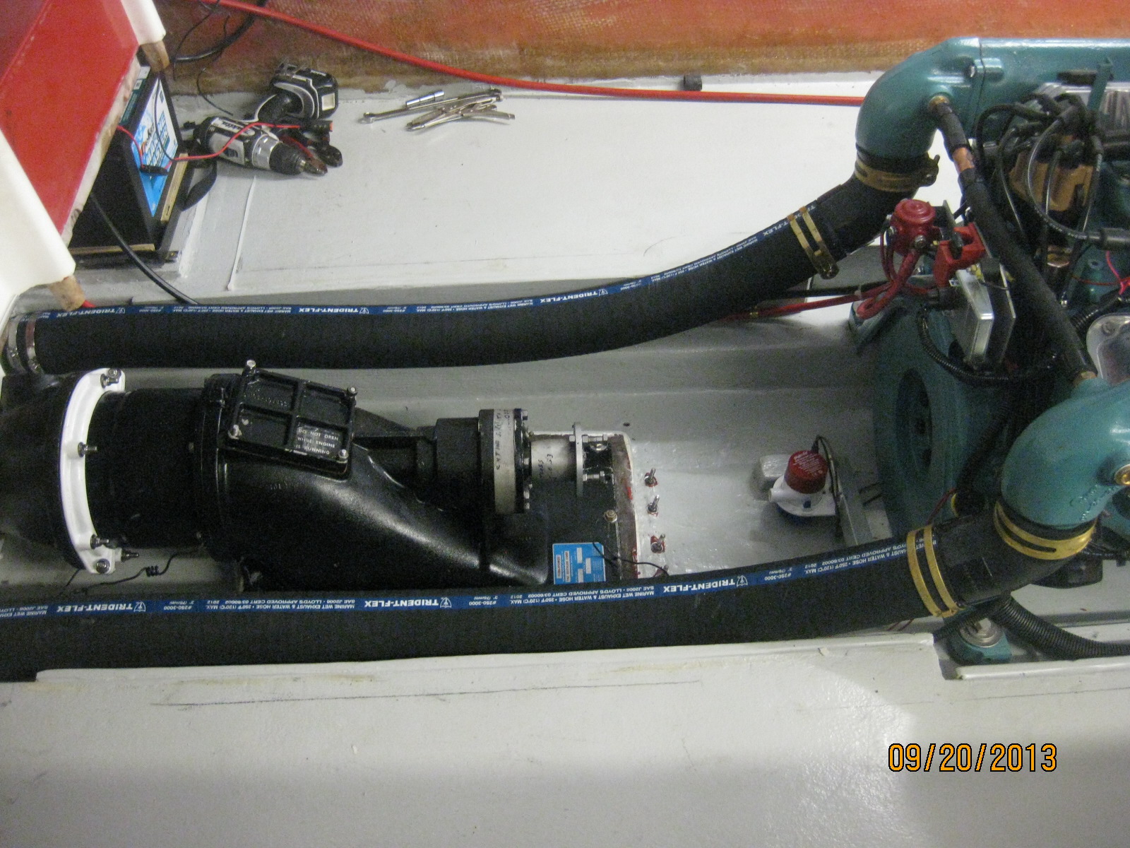

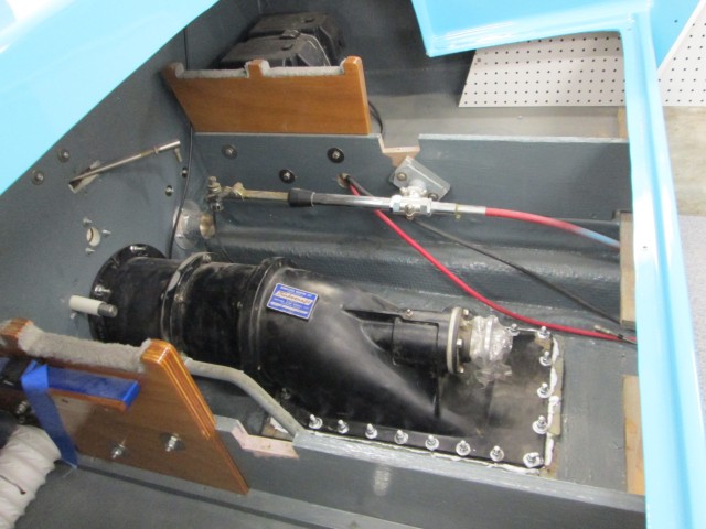

Re:Restoration 1962 Buehler Turbocraft Jet 35 13 years 1 month ago #84001
  • Shelby18
  • Shelby18's Avatar Topic Author
  • Posts: 436
  • Karma: 18

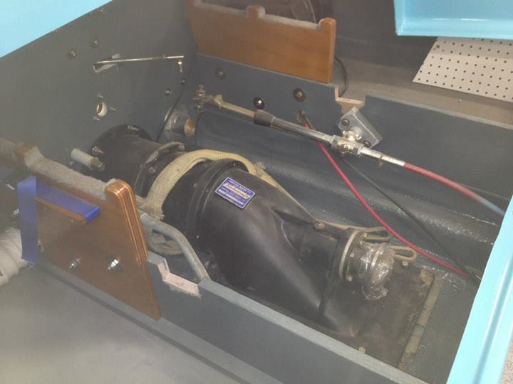

More photos. The pump is in!
Custom step mounted.
Bulkhead installed

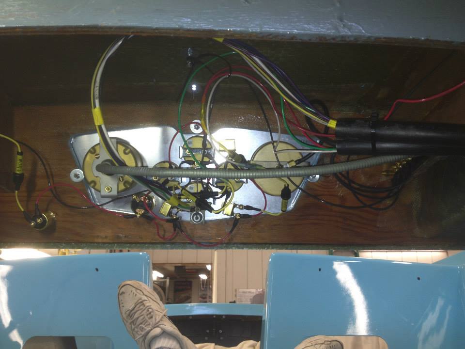

All new wiring for the restored guages, and the rest of the boat.
Great to be on board.
Rick

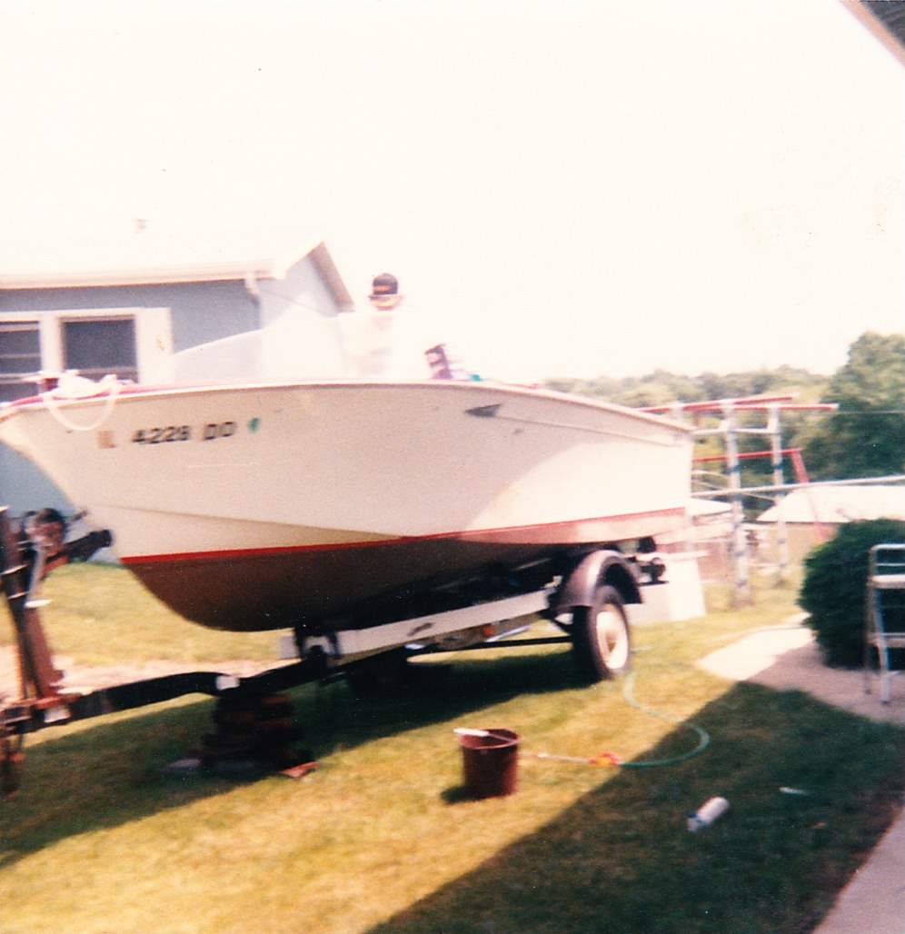

Re:Restoration 1962 Buehler Turbocraft Jet 35 13 years 1 month ago #84052
Don't have too many pics of back then, but I found this one, it's the first day after I brought it home to work on, the bucket in the photo got a lot of use. The second pic is of my 1973 Glastron V173 I just finished this project (except for building windshields for it) I send it along to give you an idea of what my completed work looks like, the Buehler was just as nice, except then I used paint the Glastron was re gel coated.

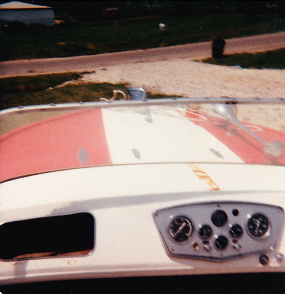

I believe it was late 60's like 68 or 69, if I remember correctly it was a turbocraft 200, 17 feet and really got looks in the shallows of some of the back waters where I used to prowl, some could not believe that big of a boat could nav in the shallows like that, most of the folks were sporting alum, fishing boats where I went with that boat, if I remember correctly I only needed 10 inches of water to float it. Never beached it, always made it through. If I found one today my wife would kill me cause she knows I'd do it in a New York minute, truth is she loved the sound that 327 made at WOT and even at idle. but like I said the bearing pack was difficult to keep dry, and gas was only getting more expensive by the hour back then, I think it was approaching 1.70 a gallon where I used to go, think about it 1.70 a gal is expensive, well it was at the time, found a buyer that fell in love and bought it on the spot in the water.
As far as pics are concerned I was never much for taking them until I noticed my mom getting old and sort of sickly, dropped my fork at the dinner table one night and went directly to the camera shop that night, glad I got some pics of her before, we lost her. But alas the boat was just a plaything at the time, I'll ask my brother mabey he has some, anyway here is one of the dash taken I think at the same time the other was.
Enjoy and don't worry too much about shallow water, that's why old man Hamilton made em cause the water in the rivers in New Zealand were too shallow for anything else.

Joseph, the more I look at your dash on the Buehler, the more I think it is early 60's.

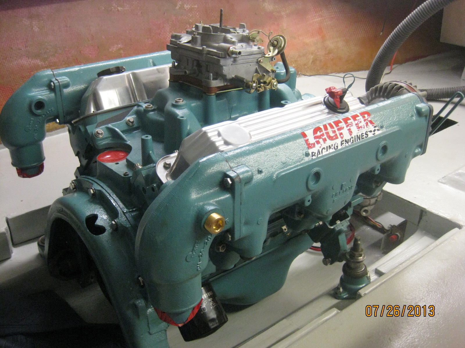

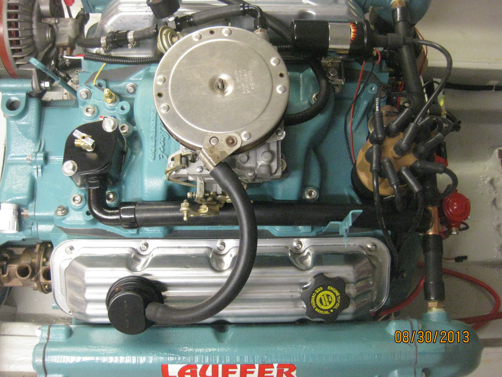

Here is another shot of the engine
This is a well Blue printed engine with lot of sound changes to the engine...This is a 0 deck height engine which requires a special piston for the Chrysler...I used the new EQ heads which you can use on the LA block...small changes to the oiling but you get a nice cyl head that won't crack and you can use the 8 bolt Magnum Valve covers.
Its Been honed with a plate and has a change in the intake dept for better low end.....thee are many more changes which could be a lot to list...questions are always welcomed.
Thanks John

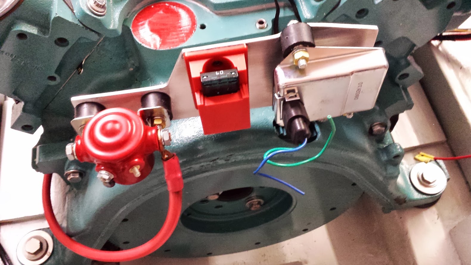

Start of the wire project......the stock Buehler electrical was a huge mess behind the engine...I upgraded and tried to keep it simple but effective
Re:Restoration 1962 Buehler Turbocraft Jet 35 13 years 1 month ago #84254

Thanks........I did not like the original marine Chrysler Starter for example and refitted the stock bell housing to take a modern day gear drive starter....These are the things that really make the difference. The average guy would have no clue about the amount of work and thought a boat like this takes......my problem......I live in Salt Water country and I cannot make myself drop in salt.....so if you know somebody that wants an extreme build Buehler with no shortcuts...it will be for sale when finished......or trade for a nice salt water center console.....

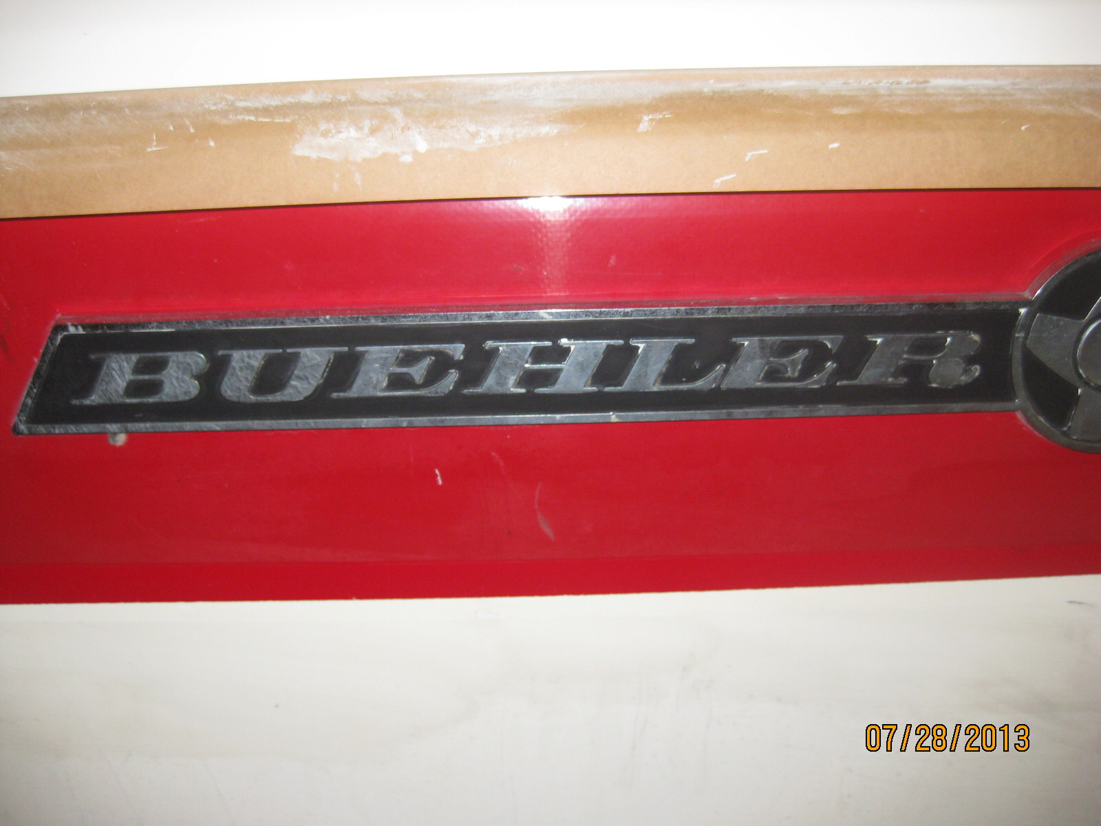

desperate need for 1 emblem...one was not on the Buehler when I purchased the boat.any condition

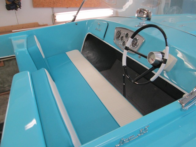

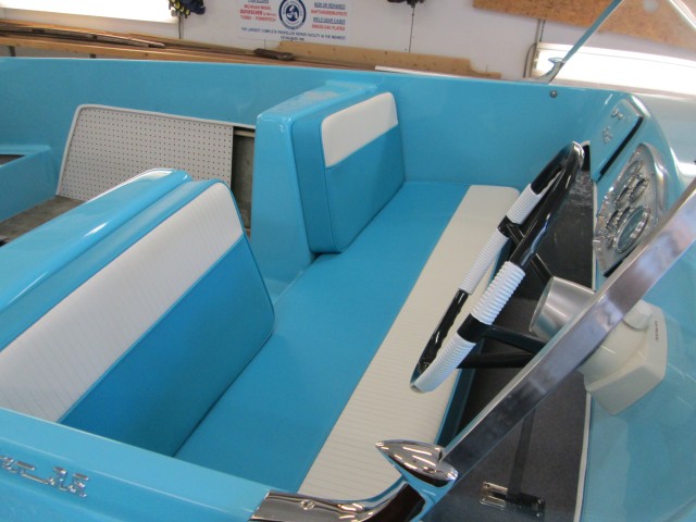

Still plugging away!

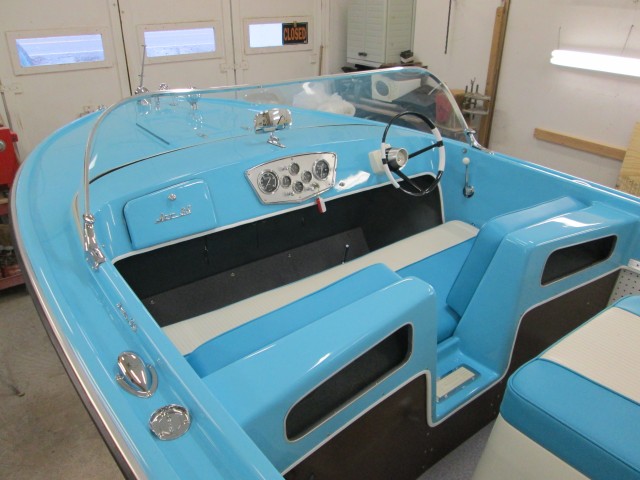

Restored Steering Wheel installed
Front seats and cockpit finished.

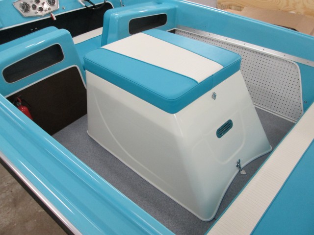

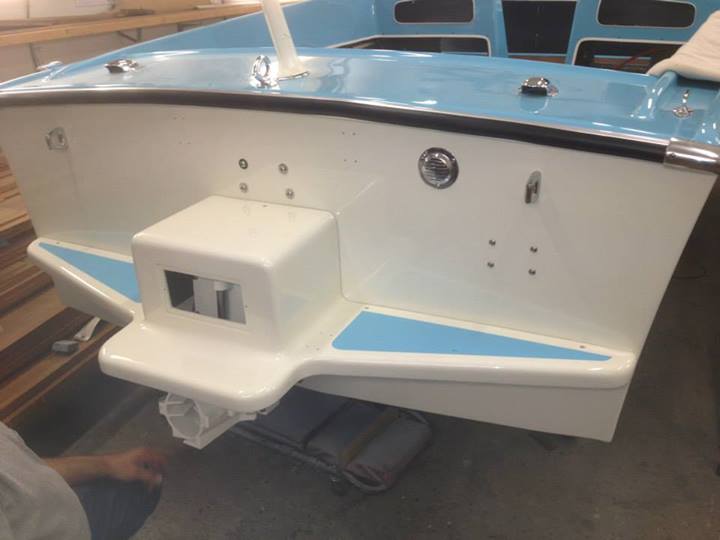

Re:Restoration 1962 Buehler Turbocraft Jet 35 13 years 1 month ago #84848
  • Shelby18
  • Posts: 436
  • Karma: 18

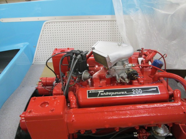

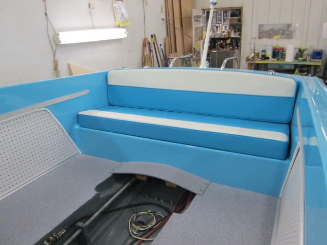

More progress!
View of new floor, aluminum trim, and interior panels installed.
Rear seat installed. We are presently designing rear seat back mounts so the seat can be removed to get to the ski rack.
Rick
Re:Restoration 1962 Buehler Turbocraft Jet 35 13 years 1 month ago #84851
Really looking beautiful.....tell me about those side panels? That cant be peg board? What is it?

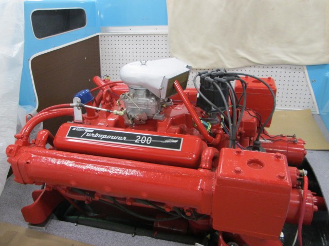

Re:Restoration 1962 Buehler Turbocraft Jet 35 13 years 2 weeks ago #85600
  • Shelby18
  • Posts: 436
  • Karma: 18

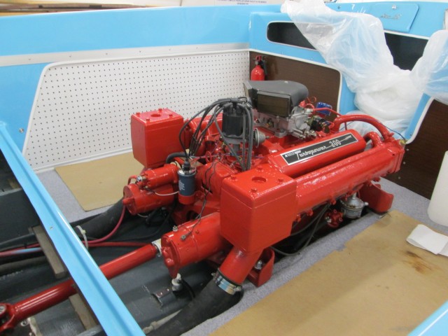

Engine is in!!
Rick

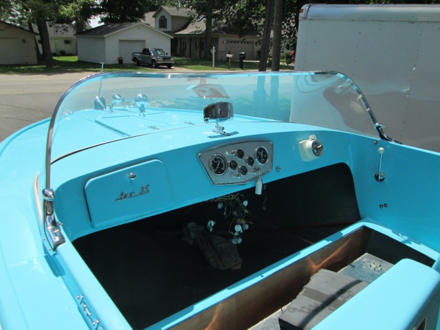

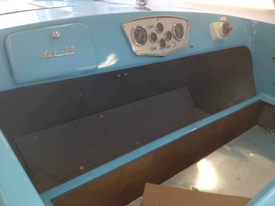

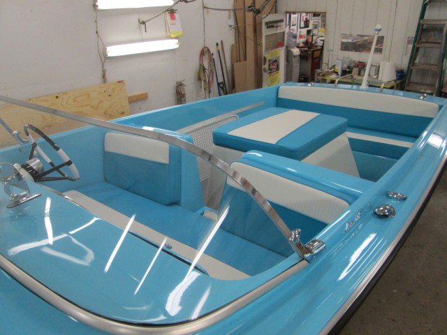

Re:DONE!! Restoration 1962 Buehler Turbocraft Jet 35 13 years 1 week ago #85936
  • Shelby18
  • Posts: 436
  • Karma: 18

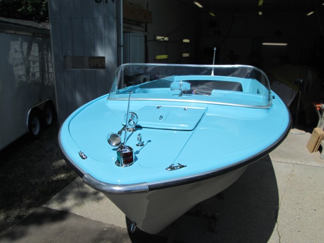

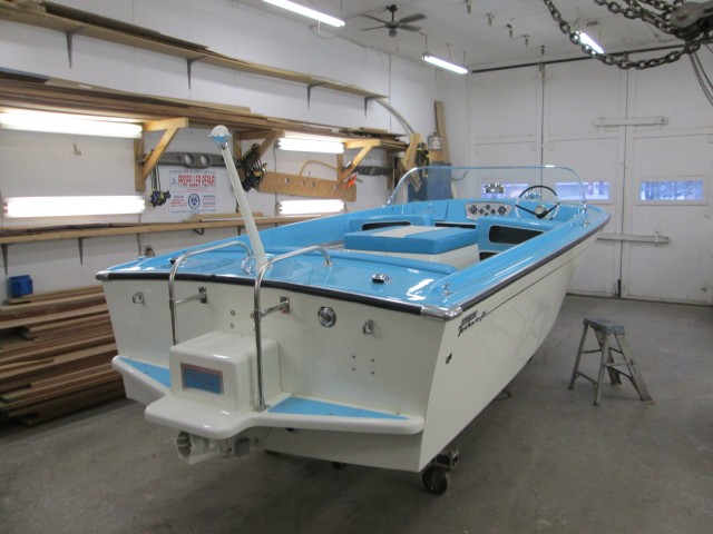

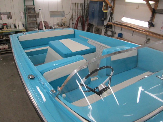

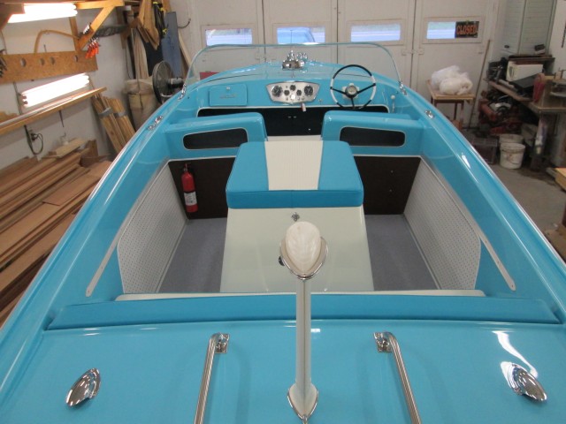

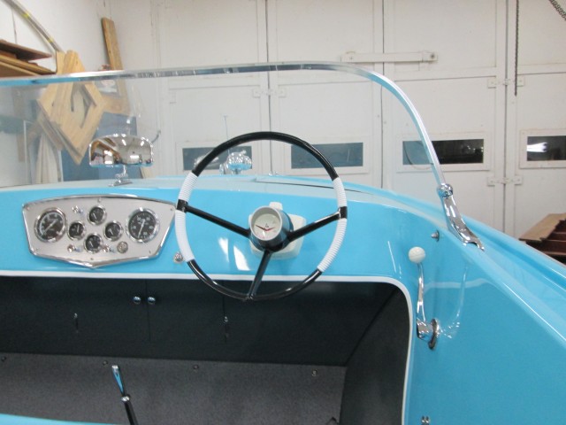

Finished except the top & cover.
I want to thank Dave & Scott Wrzesinski of Marine Services Unlimited for taking on this project and bringing it to completion. The care they took in every aspect of the restoration I think shows in the finished product. I wish to thank all on this forum who have given encouragement, help finding parts, showing other restorations, and best of all a gateway to making new friends.
Also I have been keeping the family that owned the boat since the 60's updated on the restoration. I thank them for selling me the boat, showing interest in the progress, and hope they are pleased with the outcome.
I hoped to have some water shots, but it might be next year before that happens.
Next project: Mostly wood, and using Marine Services again.
Here are the finished photos. ENJOY!
Rick

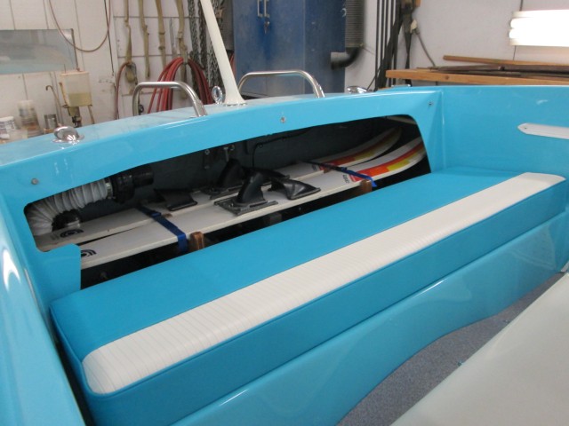

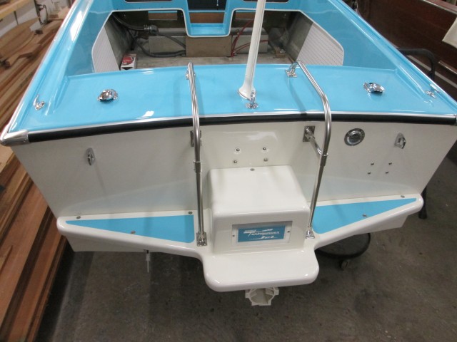

Re:DONE!! Restoration 1962 Buehler Turbocraft Jet 35 13 years 1 week ago #85937

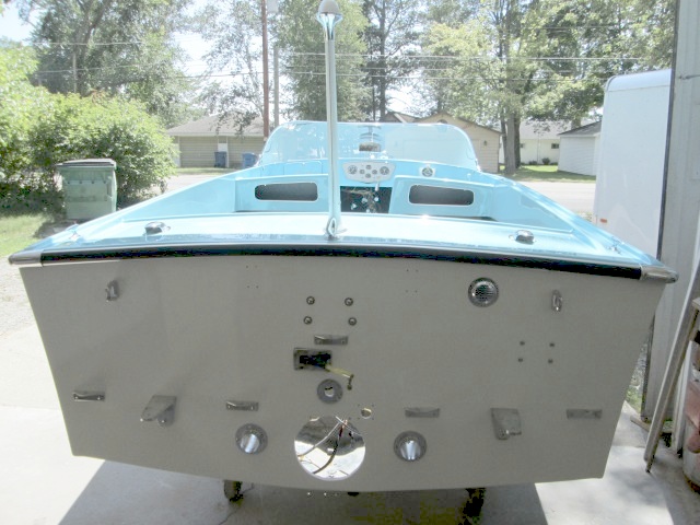

What can we all say......the Buehler is beautiful and I am sure John Buehler would be proud and sure like some of your small changes......aka improvements!
The only thing I would have changes is maybe moving the light over to the side so you don't get impaled as you get in an out of the boat!
I am not being critical, but trying to understand why you did not move it over since you were making some subtle changes anyway.
But the Buehler is real fine!
Re:DONE!! Restoration 1962 Buehler Turbocraft Jet 35 13 years 1 week ago #85938
  • Shelby18
  • Posts: 436
  • Karma: 18
Thanks John!
We didn't move the light because the whole unit unplugs. It will be stored where the skis are when not in use.
Rick
