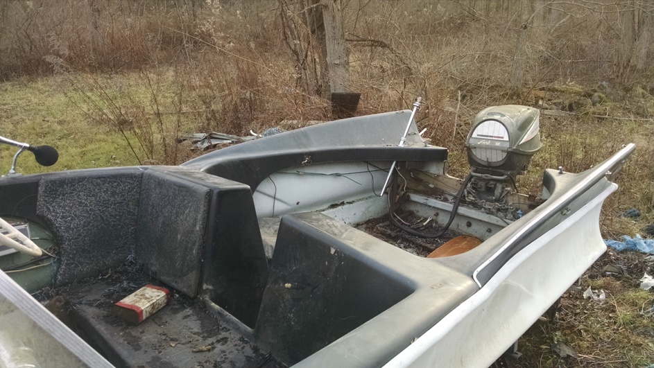

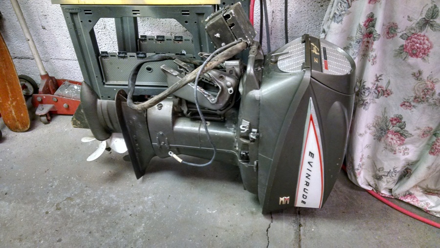

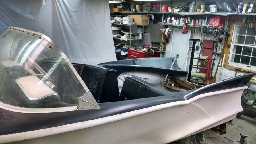

Hi, while I am new here I am no stranger to boats. I was raised on the Seneca river (Erie canal) in central N.Y. I am now 60 and still live on the river.
History aside I have been wanting to get a old glass outboard like what I used to see as a kid running up n down the river all the time way back when . Today I am going to bring home,trailer permiting that is what I think is a 59 Custom Craft. I cannot find a HIN or ID plate on it anywhere. Anyone have any idea how to truly ID one of these?

Ok, like I said newbie so I will try the pics again.

hi mark...welcome aboard....hin numbers weren't used until 1972....most older boats did have a plant number somewhere (maybe just a paper label)...more pics and closer would help...a lot of these older boats are identified by comparing them to old brochures, news paper ads and known similar boats....she does have the looks of a custom craft to me....there is a lot of info in the library here...you might want to check with whom ever titles and registers boats in ny to see if you can get the paperwork to put it on the water before you drop a lot of cash in her...she is a cool lookin boat...merry Christmas...john
Re:Newbie here with a couple prjects and questions. 10 years 5 months ago #118284
Welcome aboard cosmic12! I can't help you with identification of the boat, but it sure looks cool.
Re: Newbie here with a couple prjects and questions. 10 years 5 months ago #118285
cosmic12,
WELCOME ABOARD.
Are there any identifying trademarks, data plates or any other information on the hull OR in any paperwork that you got with the boat??
(There were many small-medium sized builders that copied the designs of other makers, some builders that actually bought other companies molds, etc., etc. ,etc.)
Absent such information, you may NEVER know for SURE who built your boat.
(SORRY but that's fact. = I have two hulls on the family farm that are NOT what the State registration identifies the hulls as being.)
MERRY CHRISTMAS, satx
Re: Newbie here with a couple prjects and questions. 10 years 5 months ago #118286
On some of the older boats there was identification on the back side of the dash, sometimes paper label, sometimes tin, sometimes stamped into the wood/

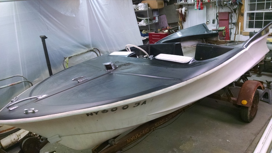

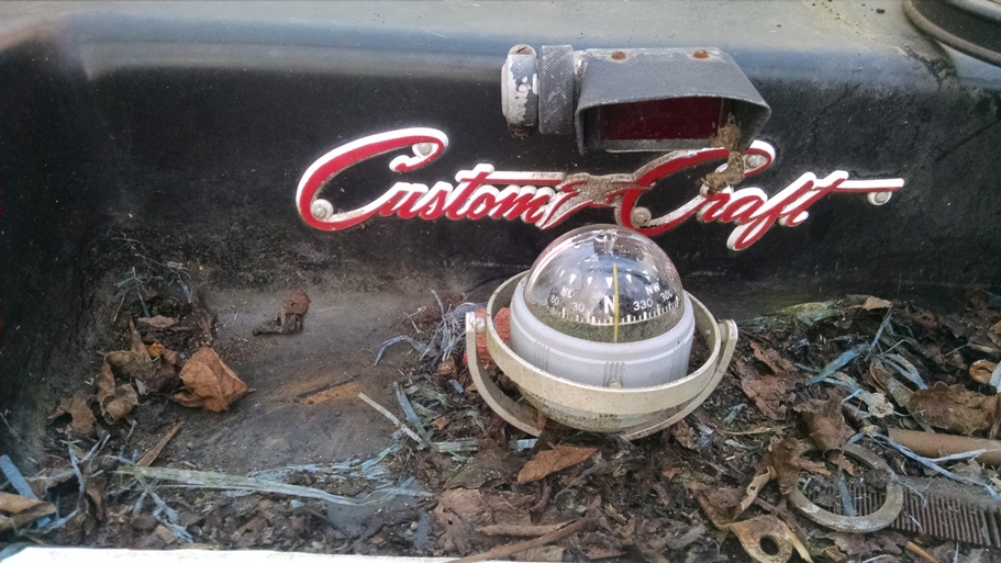

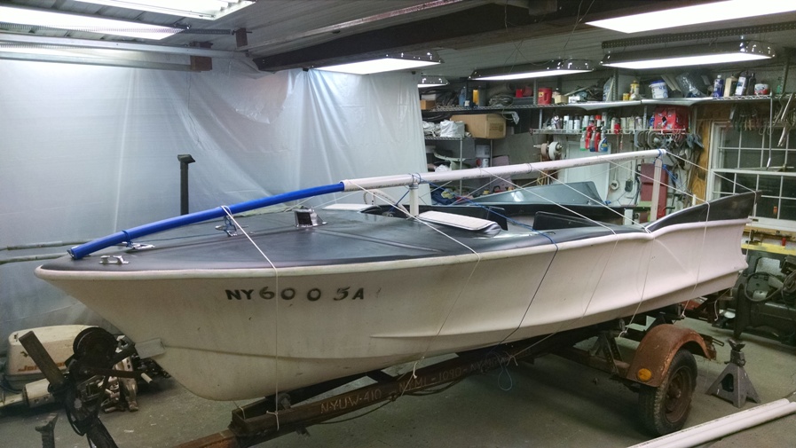

Thanks for the warm welcome guys. Today I went to clean it out and get it ready to move home I hope Tuesday. The guy I am getting it from is 83 yrs old and just a great guy full of stories about times his family had in it. He also offered me a Johnson engine of the same vintage as the Evinrude on it. Both are free and turn over but the Johnson has always been stored inside and has very low hrs. Ya, I bought it. He then handed me 2 old plastic bags that held all the orig manuals/tool kits/extra shear pins/sale lit/and promo stuff.
I am going to try to post some more pics but this site seems to have a different formart than I am used to so please bear with me on my learning curve.
Re:Newbie here with a couple prjects and questions. 10 years 5 months ago #118297
Cosmic, welcome aboard, glad to have you here. John (redfishpirates) is right. Early boats didn't have hin's. More pics from different angles and inside will help.
Re:Newbie here with a couple prjects and questions. 10 years 5 months ago #118299

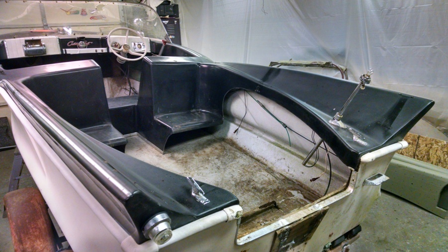

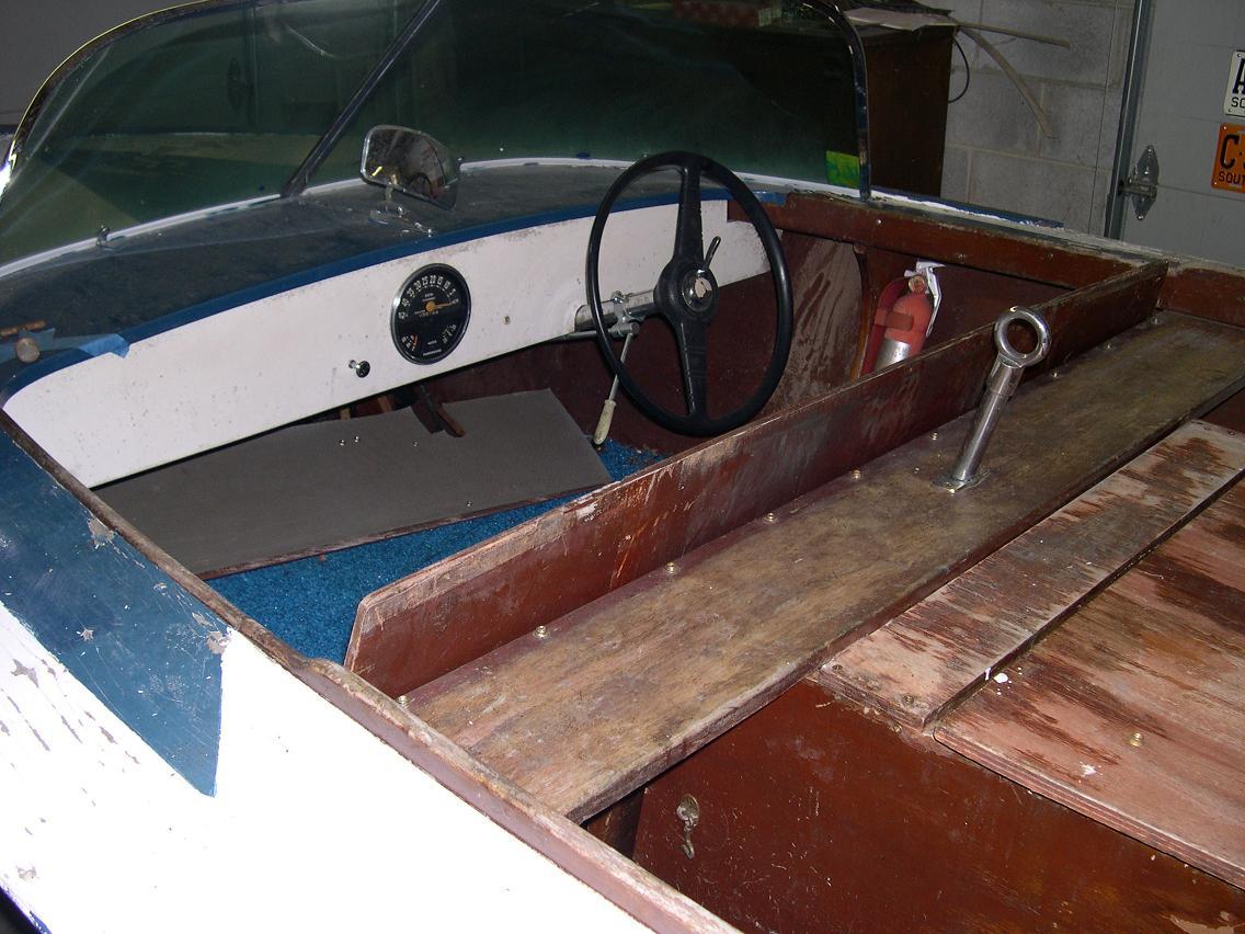

The only real clue I have about it being a Custom Craft is the script on the dash. I have done a lot of research and I am quite sure it is a 59 Custom Craft Sea Ray or that is the only thing I have found that seems to match. The problem is the aft section is completely open and the pic I have found on line all show more deck just in front of the engine. The seller has found the trail reg and it is a 59 Master Craft and the hub caps confirm that.

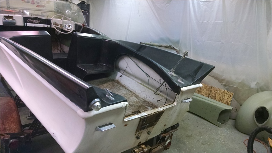

Dash

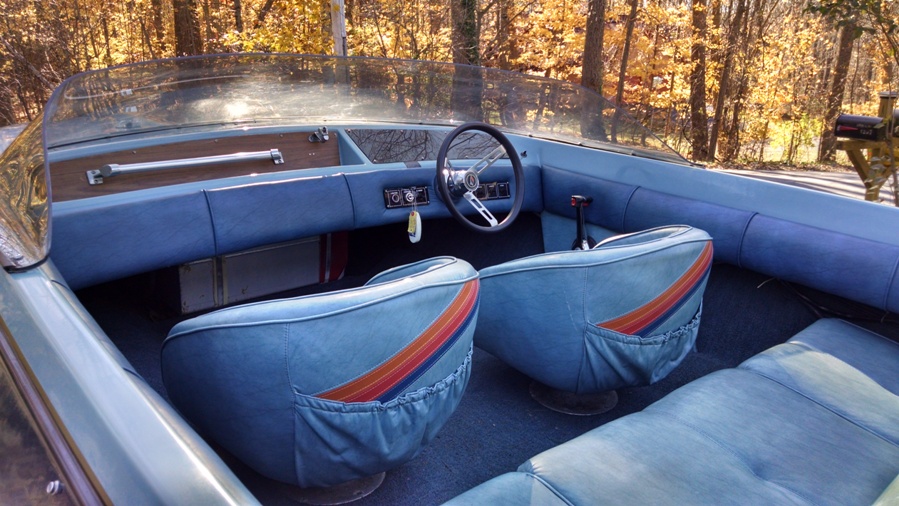

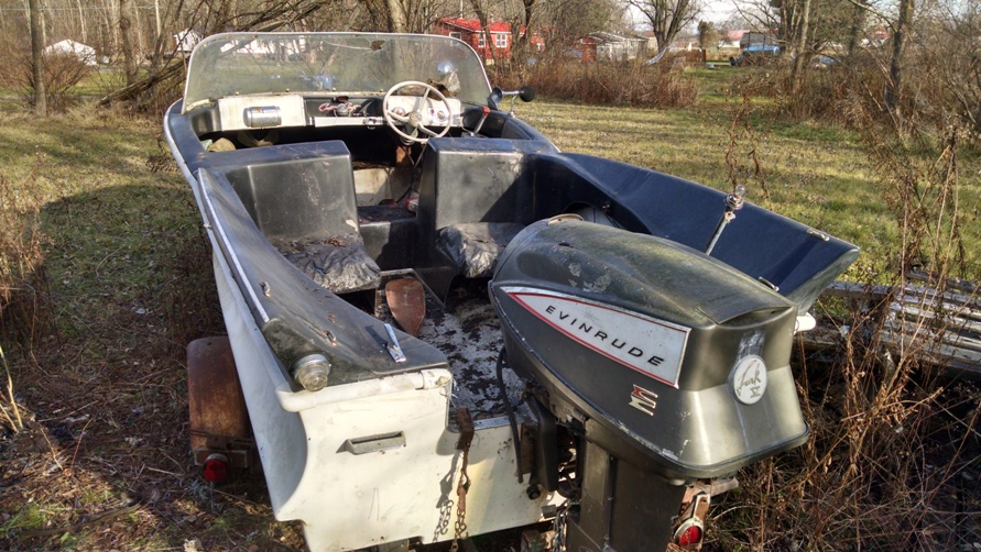

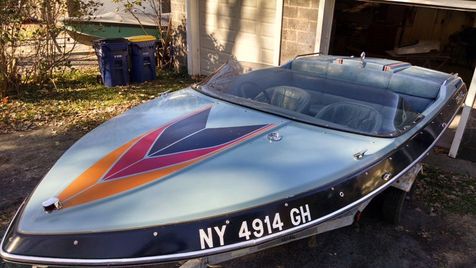

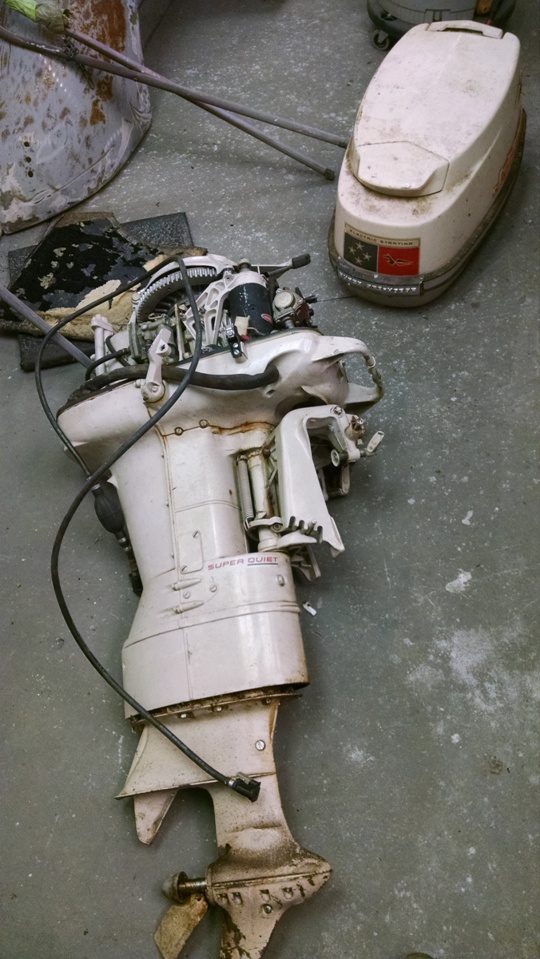

This is a 83 17ft Century Rivera I picked up in Sept. Was a nice barn find that wasn't supposed to run and trim didn't work so it was put away many years ago and forgot about. The hr meter says 436 hrs and the seller said he was surprised it had that much. It is all orig, totally.
Got it home tossed a battery in it and nothing na-da started looking at things and found the main harness connector was very green. Cleaned it up and bang! fired off and everything worked.

The big problem with this one is the OMC stringer drive and that giant bellows on the transom, but the rest of it is so nice I couldn't walk away from it.

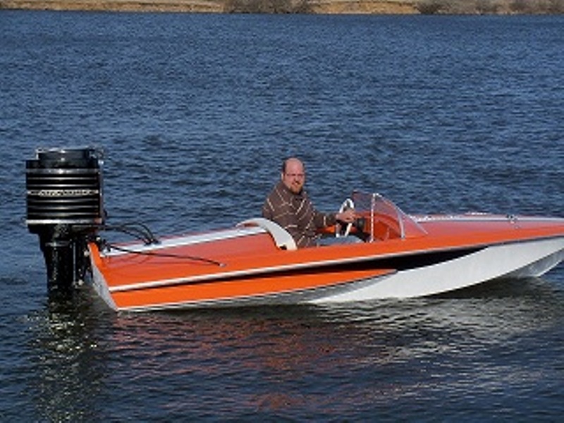

Even though that I'm FAR from sure what your finned boat is, I really LIKE it.
(I've looked until I'm blue in the face & have found NO finned FG hulls in TX. = We have a LONG boating season & the boats literally got worn out, "remuddled", crashed, etc., until there are almost NONE left.)

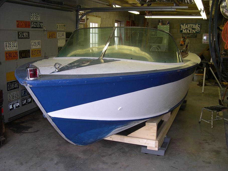

To add multiple photos to post, you have to go back and edit a previous post.
Looks like a relatively intact boat. Shame about the hole in the windshield. Expect that alone to take a couple of bills. The motor is a 1963, so a later addition to the boat.

Thank you, I will give that a try and yes you are correct about the engine it is a 63. The seller handed me a plastic bag yesterday and said your are going to love this. He was right!

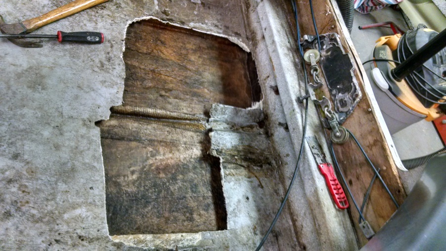

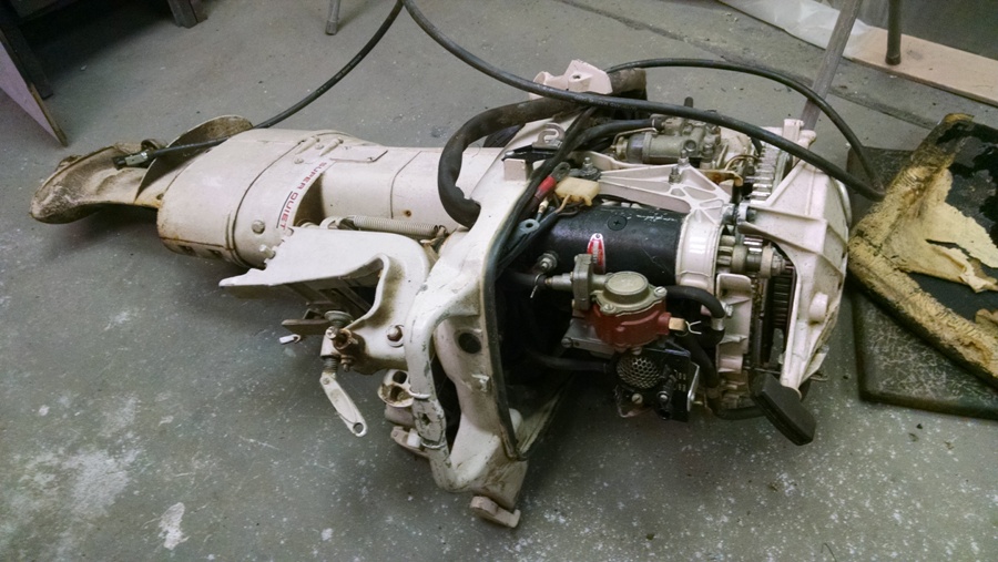

Today/night I cleaned and pickled the engine and got it off.
I opened up the floor to let it air out a bit and get rid of the rotten wet crap that was in there. The bottom looks very solid and dry so that is good news. The bad news is I have to stop and put it away for the winter, I need the shop back to pay the bills. Have a 37 Ford I need to build for a customer. But it will be clean and dry and ready to rip into it in the spring. In the mean time I will get all the materials together and be ready.

So now the hunt is on and the planning for the restoration.
I am thinking about using Divinacel for the coring, anyone ever use it? Also toying with building a 1/2 deck about 2ft up from the transom that is hinged in the aft section. Thoughts?

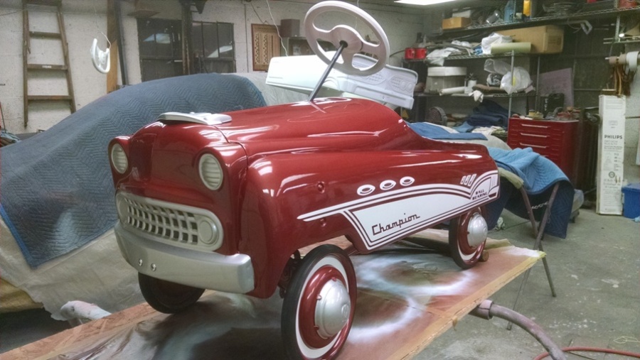

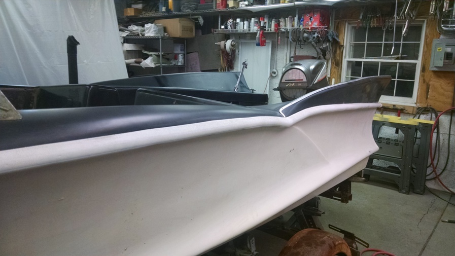

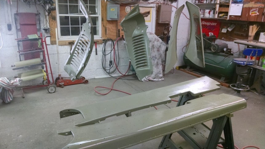

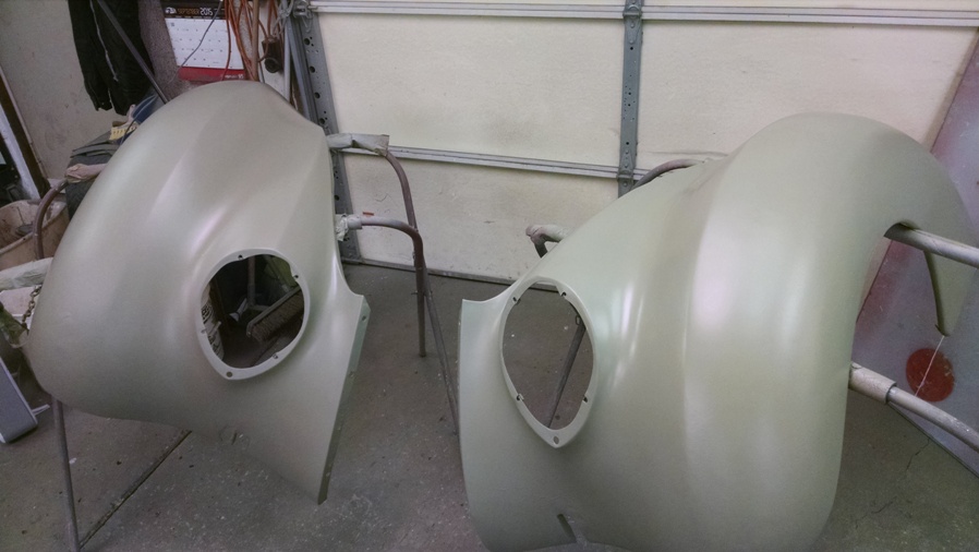

More 37 parts only in etching primer after media blasting.

yep...do her like you want her....if you are going to do a rear deck, be sure to do plenty of ventilation if you are going to keep the tanks or battery under it....same with the bow.....we don't want to here of your early demise...john

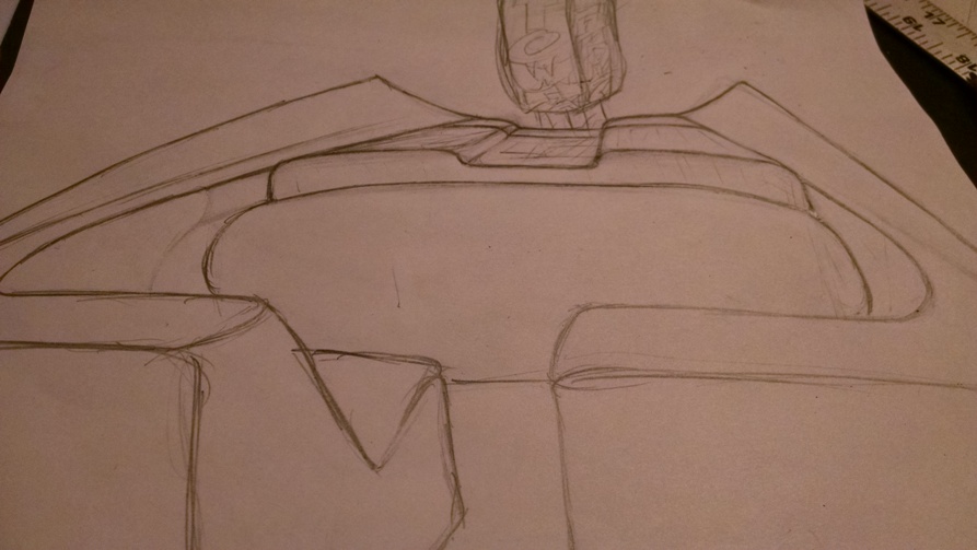

I am so glad there is no ill feelings about modifications. I belong to atleast one car site that if you aren't totally correct/traditional you get flamed bad so I really needed to check 1st.

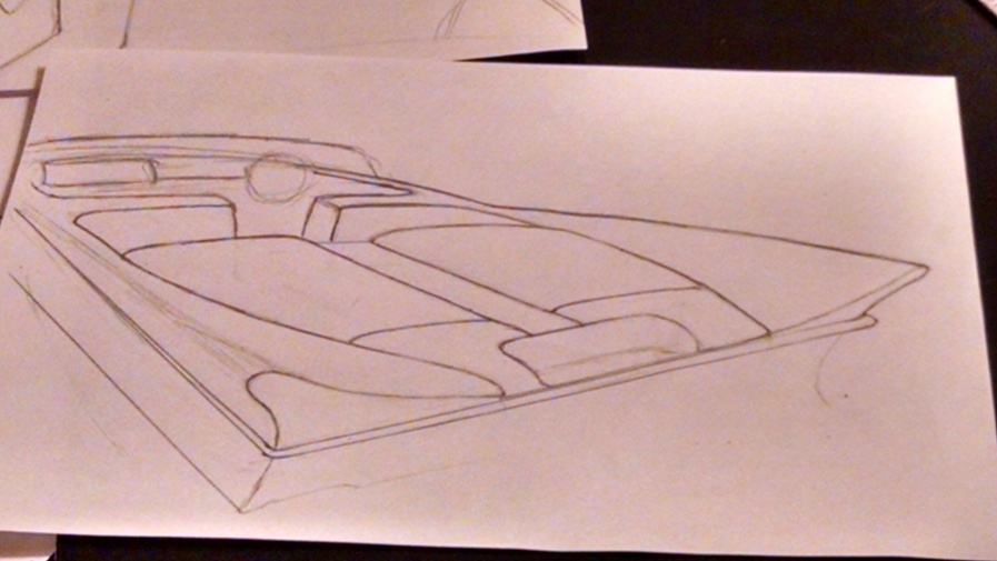

Here are a couple quick drawing of what I have in mind. I am not a artist by any means so they are rough. And yes vent's will be on it.
Re:Newbie here with a couple prjects and questions. 10 years 5 months ago #118457
wow...1st glance of bottom pic reminds me of a 59 t bird conv....love it!!!

Hi,, I saw your post on s&f, so it sounds like you want to put some hp,even not if you are going to put all this work in it,even though you might think it is solid ,put a new transom and probable a floor,then stringers and support,, it is like restoring a car with a bad frame,it will come back to bite you,also when you do this deck you might want to plan on a well or even enclose it for water coming in the back,,but you need to decide on the engine,,short or long, there is a lot more longs to pick from, good luck I like your plan here is a pic of one that My employee did for himself,,good luck Bill

Thank you, yes I put that over there to try to get a bit more info in the performance area. You are correct about the water issue and I have a plan for a well in the aft section that will be a fixed section with the doors forward of it. Also a gutter where the inside edge of the doors will lay. The center, between the doors will be a solid piece from the well section forward, kinda like H frame. Before I start I have to find the power and design around it.

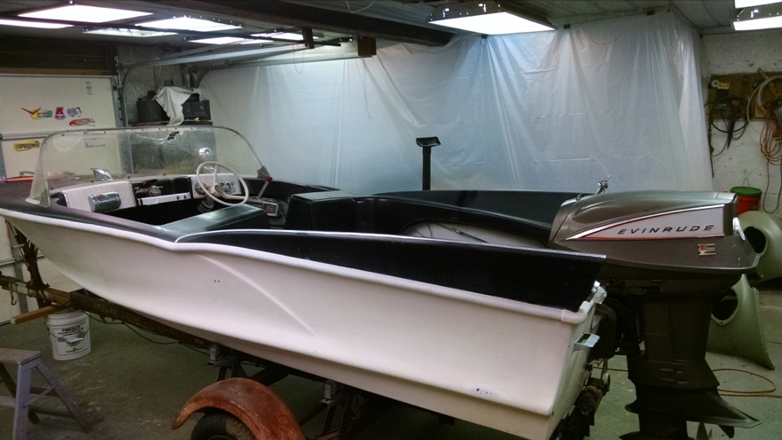

Finished cleaning it today and got the windshield off along with a few other odds n ends. I don't think a full windshield will go back if anything at all. She is getting very dried out now and cleaner than it has been in over 25 yrs. Built a back bone and covered her up foe a winters nap. Now I have to sell my Century so I can get the new power and start the build.

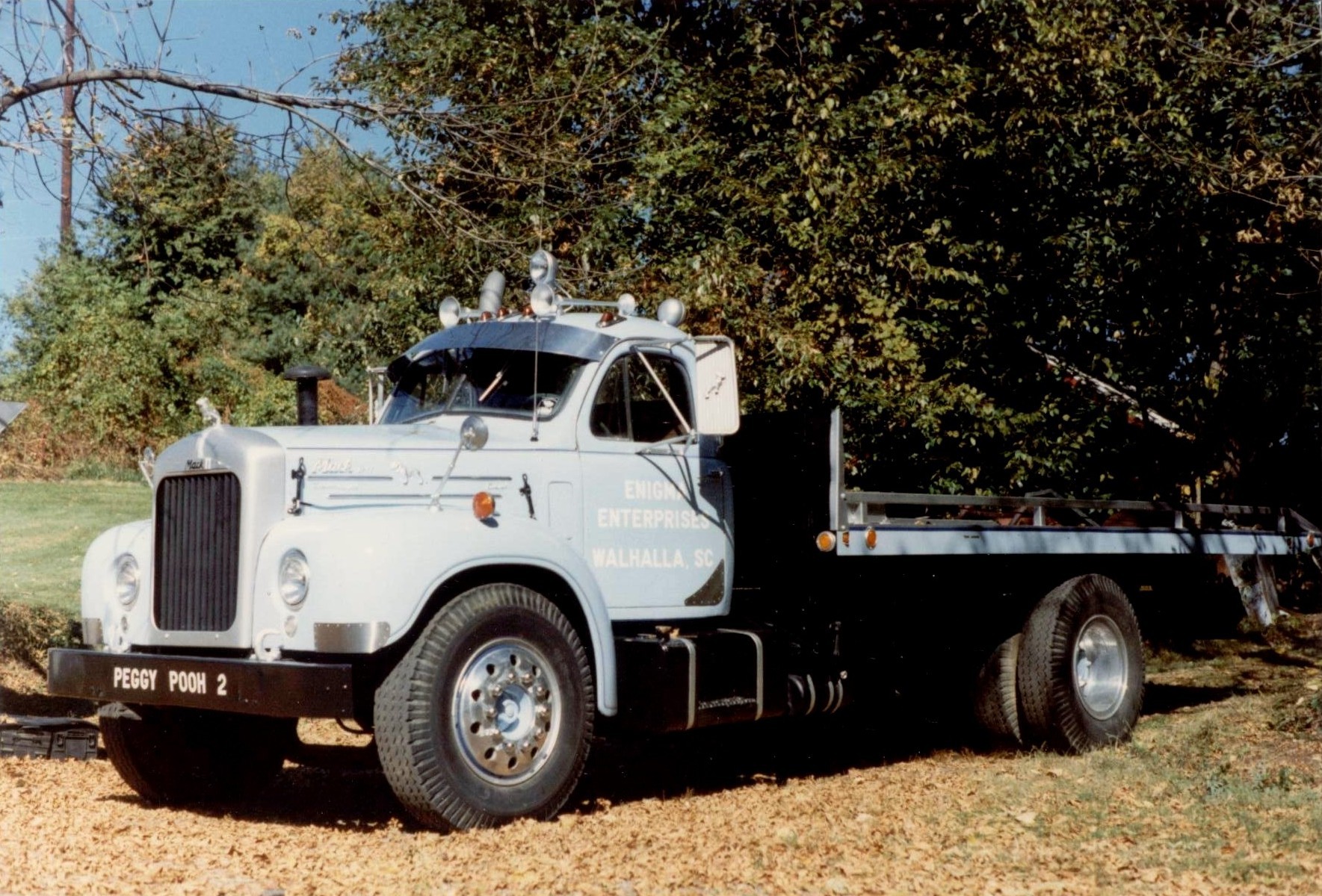

Love that '37 Ford. Before I got the "boat bug," I was an antique car/truck guy. Here are a few I restored. The first two were Hemming's Motor News cover cars back in the 1990s.
Mentor to the unenlightened!

Had great fun this fall doing 2 peddle cars for guys that wanted to give them to grand kids for Xmas. One the Copper/Brown one belonged to the guy when he was a kid. The other one the guy has a 56 BelAir convert and wanted it to look just like it for the kid.

Another question. I have the 2 engines that I got with the boat and I was wondering if anyone had any idea what they were worth? Gotta be something I would think. They are both free and turn over with what seems like good compression but haven't been run in a very long time.
40 Johnson is a tiller motor I have nothing more for it than what you see. The Evinrude is a 63 and I have all the wiring/controls and all the orig paper work. The guy said it was only used a couple hrs a summer for 4/5 yrs and that it was perfect when pickled.
I do not want to mess with them and would like to see them put to use so before I put a ad anywhere and maybe over price them what do ya think?
