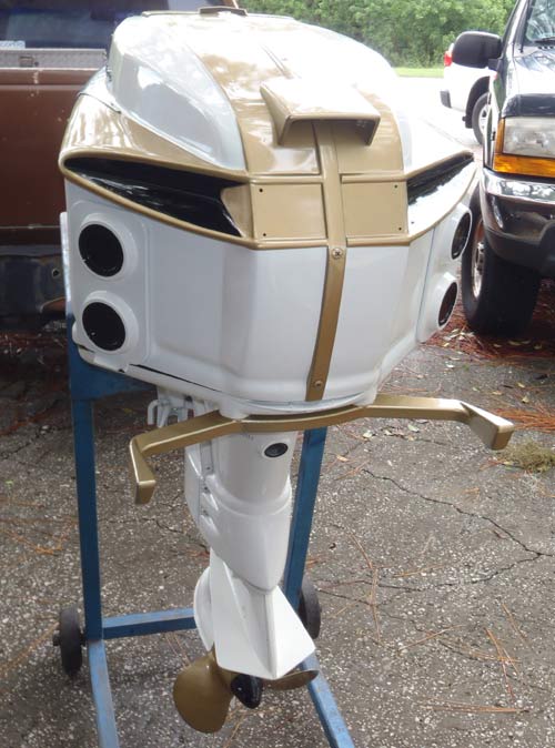

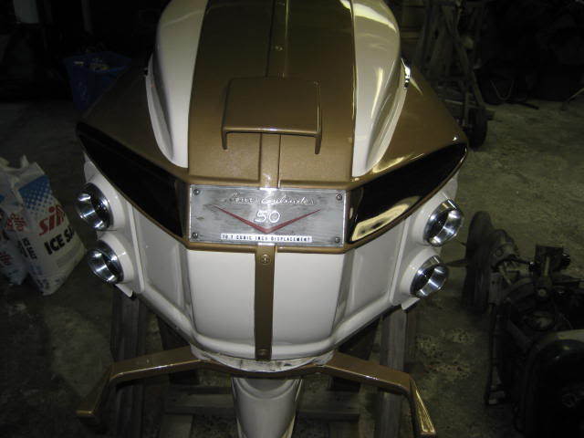

Been looking at engines and price's but still not sure exactly what I want but I have made my mind up that it will be a tall black Merc or if I can find a 1958 Johnson 50 super Sea King cowl it will be Rude/Johnson. So which ever comes first will make the decision for me.
Anybody know where I can get one of these?

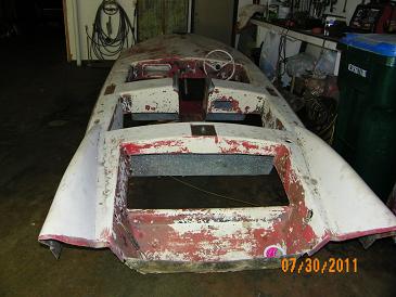

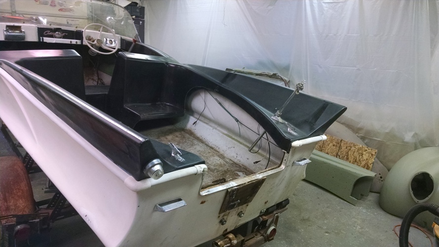

Although I have cleaned/covered and put the hull away supposedly to be outa sight outa mind I can't seem to make that happen. I started working on the 2-seater rendering and I really think that will be the way to go, besides 4 people in that boat would be to much anyway.LOL
So here is what I have sofar.

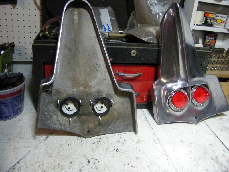

I thought about something for tail lights but not real sure yet. The Caddy bullets not so much, I have a real set of them along with about 30 other sets ( I build cars,custom/rods,ect) but not convinced it would work.
Re:Newbie here with a couple projects and questions. 10 years 4 months ago #118540
My own opinion for what it's worth, the '59 Caddie taillights are overused to the point that everyone thinks "ho-hum". How about a set of '60 lights instead that would be frenched into the slant of the fins?

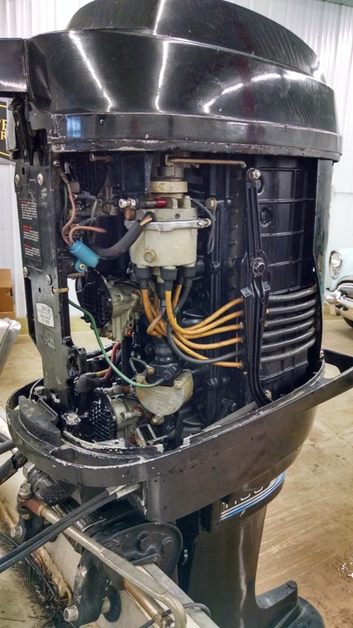

Came across this, 90hp 6 in a row Seems very nice but might be to much. Thoughts?

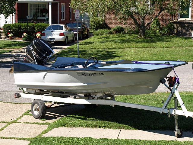

Yep, got a 1000 on mine, same hull (from the waterline down).
You might want to check this one out for some inspiration:
Sorry, I guess I don't have a very good picture of the "pod", but you get the idea...
Great! how does it set in the water? What year is the motor? weight? What do get for speed and how does it handle? I have looked at the Sport or as many pics I can find. Wish I could find one would save me a lot of work, but I don't want the square deck anyway. All the merc's I have been looking at are in the 300lb rage. I have now found a 1977 115 without trim that is very nice with what appears to be very low hrs but I have to buy the whole package, hull/trailer/motor and don't need another hull that's for sure.

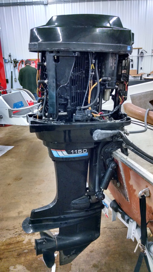

Well, I got a 1977 115. Haven't got it home yet seems to be in very good shape. Time will tell. So I now have a direction and know where I am going with it. Come on spring! Need to figure out the right X dimension for the transom rebuild and what I am going to use for it and the floor coring. Thinking Davinacell? (spelling) for the floors.

"115 is the same as the 100, just rated differently, 90 is the same block with different carbs from what I've been told."
The 1150 & 115 are '70-'80s model 99ci inline-6 Mercs, and probably a smidge heavier than the '60s 1000, which is a 90 ci inline-6 Merc.
There are 90ci 900 inline-6 Mercs that were produced in 1965 only, and are basically a '65 1000 with choked down carburetors.
Then for 1966-67 the 90ci was model 950, 950ss, and the biggest TIGER block produced was a 93ci 1100 & 1100ss.
The 'SS' designated solid state ignition.
Then, in the late '70s & '80s 99ci model 900 & model 90 inline-6 Mercs were produced. It is basically a 1150, 115, with smaller intake porting, and no boost ports - like the mid-late '80s 115.
If you are planning on running a short shaft (15" transom), the '60s short drive shaft housings (DSH) are much easier to come by, and although a lot of the '60s big 4 cyl and inline-6 Mercs could use the same DSH, be sure and post or compare part numbers, before investing.
If you are rebuilding the transom, and plan to run a Merc, the short shaft models do better on a 16" transom, and the long shaft models do best on a 21" transom. These are heights used for everyday boaters. High speed performance will call for higher transom settings, but can be difficult to plane off or pull tubers, etc.
Finding a short DSH for the '70s dual square port models can be difficult and spendy. The '73 thru '86 850, 80, and 75 4 cyl DSH will work under the 99ci inline-6, BUT you have to disassemble it completely and swap out the exhaust tuner so you won't restrict and consequently severely overheat the inline-6 exhaust flow.

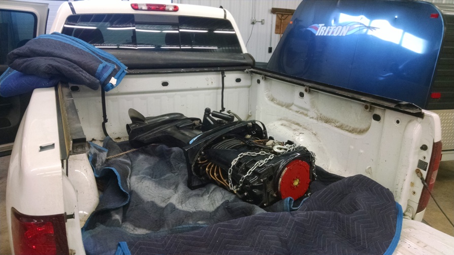

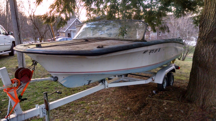

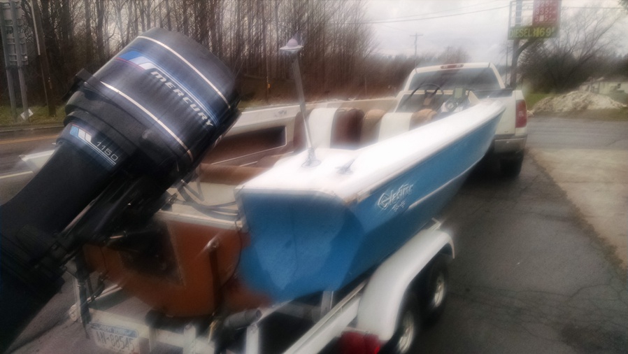

Hauled the doner boat home today. Engine/steering/controls all look real good. The trailer is great and it will be under the Custom Craft soon, minus the rollers,yuk,.
Re:Newbie here with a couple projects and questions. 10 years 4 months ago #118796
  • Dr.Go!
  • Dr.Go!'s Avatar
  • Posts: 1719
  • Karma: 19
  • Thank you received: 125
I love that tandem axle trailer look with combined fender. Wish I had that, but do not want to mess up my original package...though I will buy the best and highest load rated tires to help a bit.
Nice Tower Motor - best of luck with all. I am enjoying your posts and learning lots!
Dr.Go! (Mark)
Dr.Go!

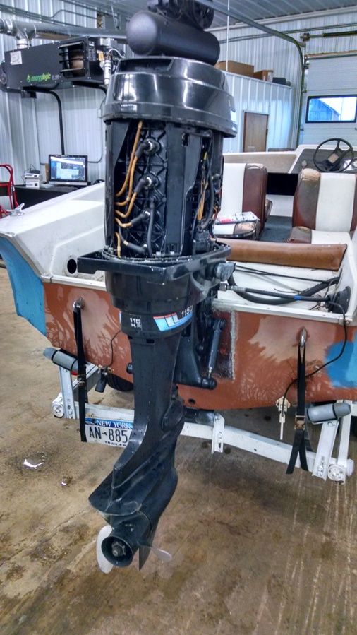

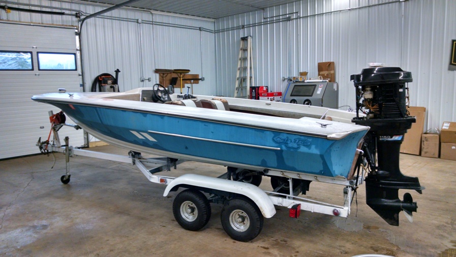

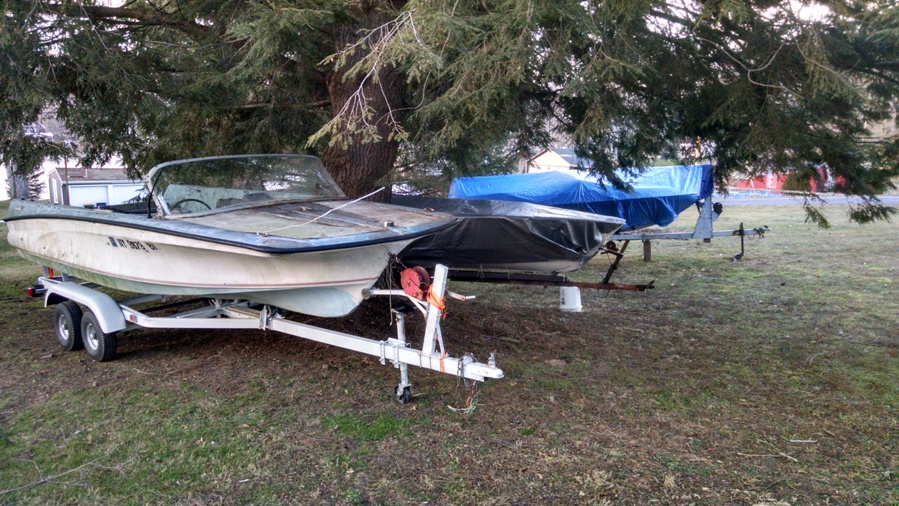

I got the engine and all the rigging off the Glastron today and then went and hauled another Custom Craft I found home. The fleet is getting outa control.

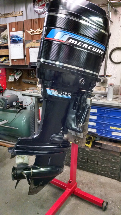

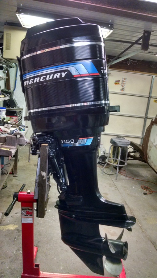

Made a adapter for a old engine stand and the 115 is ready for fitting in the now dubbed "River Rat" in the spring. It cannot come soon enough, I am chomp'n to get to work!!
Re:Newbie here with a couple projects and questions. 10 years 4 months ago #118839
  • bilnan1
  • bilnan1's Avatar
  • Posts: 900
  • Karma: 63
  • Thank you received: 14
Why you are waiting,, take a compression test on it I have had bad luck with the 6 cyl when it comes to compression,, but I still run and like them,Bill

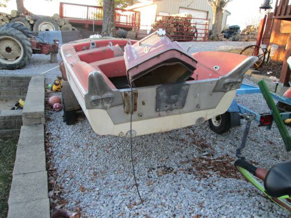

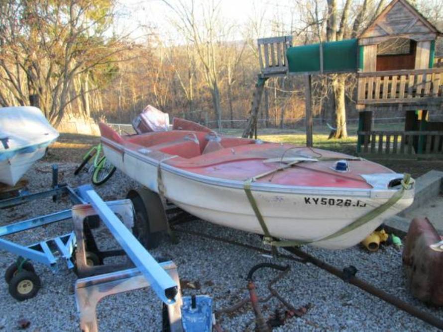

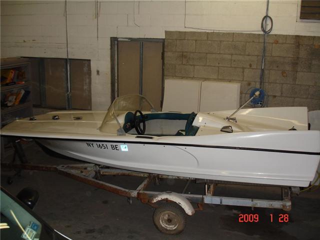

Ok, well I did it again. I just scored a Flying Fish. This one will have to sit for awhile so I can do the "River Rat" but I can't seem to say no to these Finns. I think I got a problem.

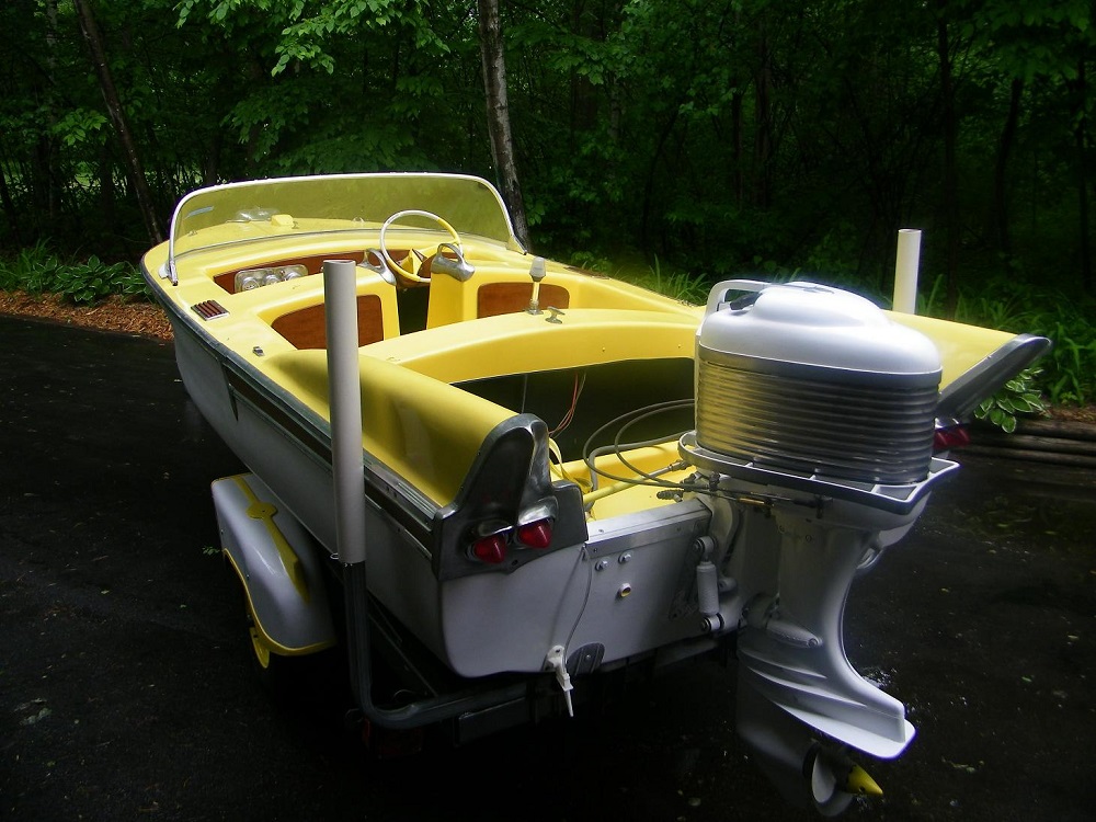

Re:Newbie here with a couple projects and questions. 10 years 3 months ago #119058

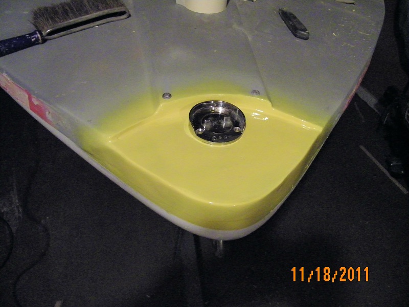

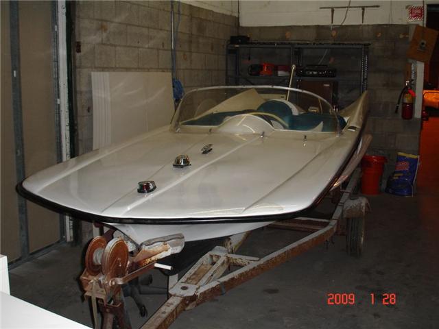

Here's something to think about...my project 5 years ago. Exact same model.
Had over 300 holes to fill. Put an inboard gas tank up front and put the filler under the bow light.
Re:Newbie here with a couple projects and questions. 10 years 3 months ago #119063
  • cosmic12
  • cosmic12's Avatar Topic Author
  • Posts: 484
  • Karma: 3
Very cool ride ya got there. What did you use for the tail lights? do the work? What year is the boat?
Re:Newbie here with a couple projects and questions. 10 years 3 months ago #119068
Can't put my finger on the exact year, I think between '57-'59. I sold it a few years ago to start another project.
The taillights I bought at a local truckers emporium where they sell all kinds of lights and chromy stuff. They are standard side/tail lights, come with the chrome rings. Had to enlarge the holes slightly for a fit but not any real issues. They do work and were put on a separate switch so they couldn't be used as nav lights.
I have lots of pictures of the build if and when you start.
