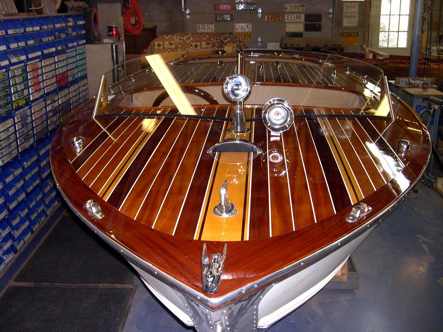

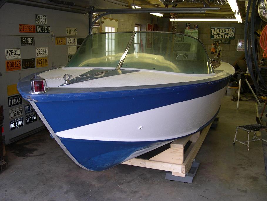

Here are some before/during/after photos of a Ski Dart that I picked up for $300. It was structurally solid as a rock, zero rot but butt ugly. Since I don't ski, I decided to change the configuration..."a little." Meet the "Bettie Page," the runabout Century never made:

OK...it won't let me load all the photos so I'll cut to the chase:

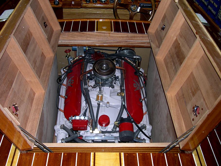

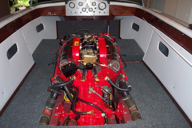

Engine compartment
Mentor to the unenlightened!

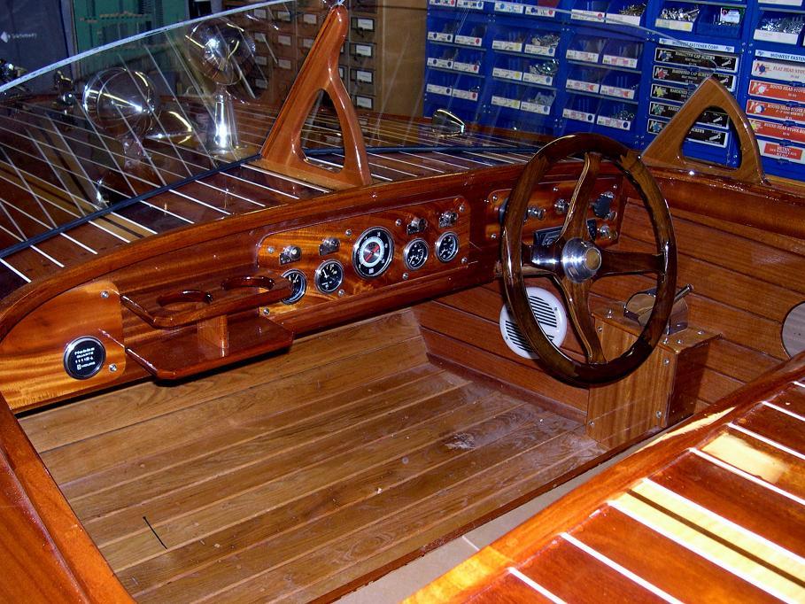

Front cockpit...needs cleaning!

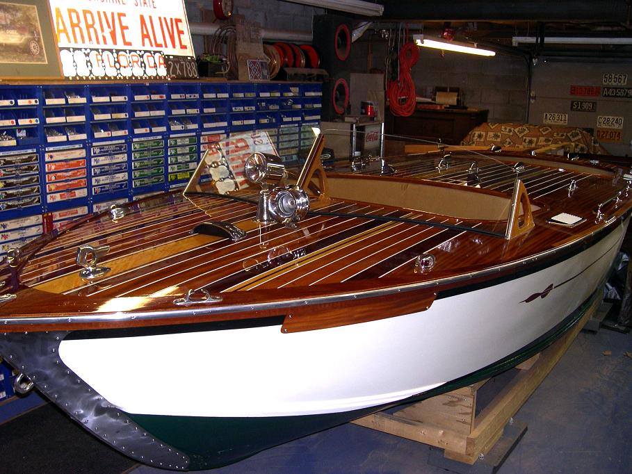

Quartering shot

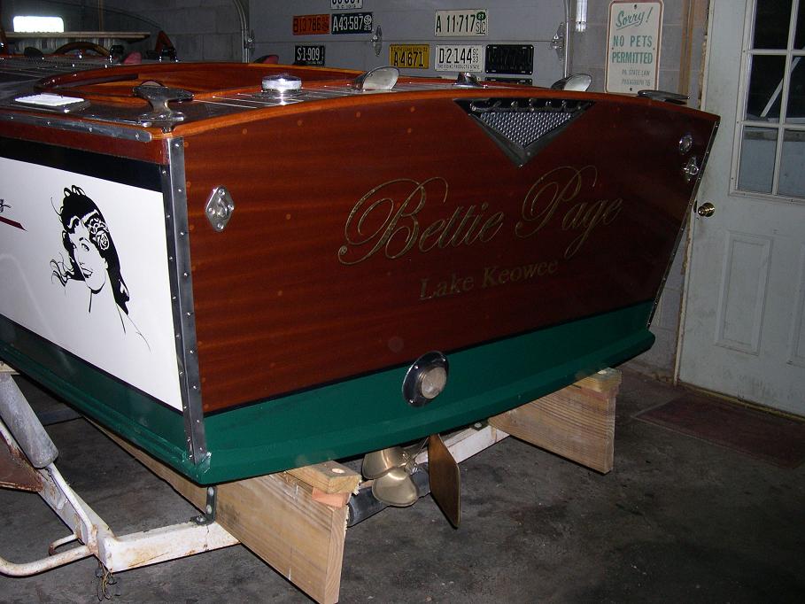

Transom in bad lighting...

I'll try to answer some of the questions.
Yes, I got an engine with the boat...original AMC based Graymarine V8...stuck solid. I replaced it with an identical engine...287 CID with a top-mounted 2-barrel instead of the single side draft carb. Don't ask me why I didn't use the opportunity to convert to a Chevy small block...I have no logical answer.
All of the framework and plywood was good but ugly. The hull was dinged-up and pitted...but solid. I covered the existing plywood hull with 1/8" marine meranti, using a solid coating of 3M 5200. I stapled it in place but the staples wouldn't go all the way in...perfect! They were easily removed after the 5200 cured and the tiny holes puttied-over.
I reframed the topsides using the existing curvature of the foredeck. The boat is quite wide so I built storage on either side of the engine, rather than waste the space. The side panels in the engine compartment can be easily removed with a few screws, making a lot of room for repairs, whatever.
The topsides use 3/8" ribbon sapele plywood, African mahogany, Honduran mahogany and fiddleback maple. The planks are individual pieces, all bedded with a dab of 5200 and two stainless steel screws at every frame. No stain was used...just 7 coats of Easypoxy varnish. The seams were filled with 3M 4000 after the varnishing was completed. The dash pieces are the fanciest sapele I had sitting around. The transom is 1/2" ribbon sapele marine ply over the original plywood transom.
Most of the hardware and gauges came from Ebay...where else? I designed/built the windshield frames...used 1/4" safety glass. The steering wheel came from a 1927 Marmon model 6-75 automobile. I made the adapter plate from aluminum. The cutwater is something I made from two pieces of stainless steel with a piece of 3/4" stainless trim running down the center.
I figure I have about $1,500-2,000 in the boat...and maybe 300-400 hours of spare time during last winter. The fuel pump died on sea trials and "some dumbass" had wired it so that the key wouldn't turn off the engine...both have been taken care of. She rides and turns well and probably makes turns for 30 knots...maybe a little more with a lower pitch prop.

P.S. Yes, I made the mahogany registration plates for the front. I forgot to mention that I bought the boat without a title and have been fooling around with the DNR since May trying to get it all sorted out. I still don't have it registered. If you live in SC, don't buy a boat without a title...it's not worth the hassle.

Re:1961 Century Ski Dart Conversion 15 years 14 hours ago #42466
You made the right decision with the engine. Those old AMC's are warhorses. I believe you have the 327 block which was pretty standard in the Centurys. Difference was carbs. Here's a picture of the 327 that I have in my Sabre, 225hp with the dual side draft carbs. Pushes the 18 footer around 48mph on a good day.
Cal
I can't see what you have for ventalation in the engine box but I would strongly recommend a blower and open screens. If you seal the engine in that box you are a floating firebomb.

There are four vents directly over the engine and a blower in the rear that pulls from the engine compartment and vents through the two rear vents above the transom. I believe that ought to take care of any/all gas fumes. If it blows sky high, I'll assume I was mistaken.
Concerning that AMC engine: I have the 287, not the 327. Also, in the photo you attached, it looks like you are still running the Leece-Neville alternator and voltage regulator.(?) Both of these items are impossible to find, aside from pulling them from junk engines. The marine fuel pumps aren't exactly readily available either, decent exhaust manifolds are scarce as are exhaust pipes, distributor rotors, caps, etc. If there is any good news about that engine, it's that nobody wants them so whole engines can sometimes be had for cheap...can't have too many spare parts.
