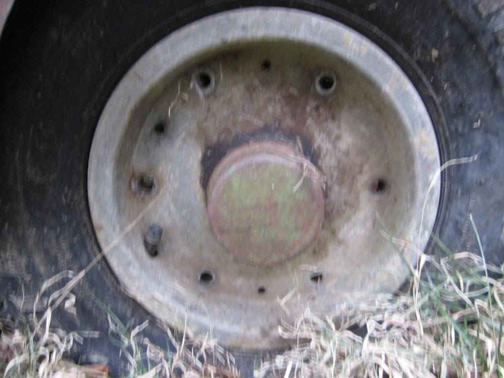

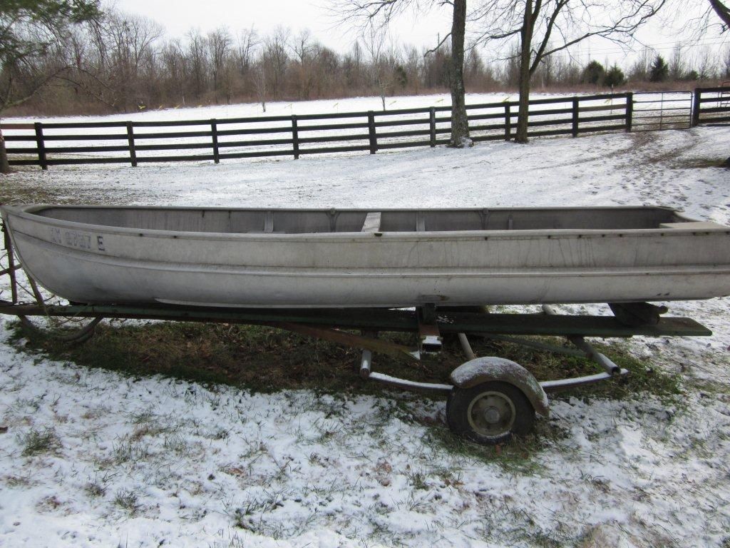

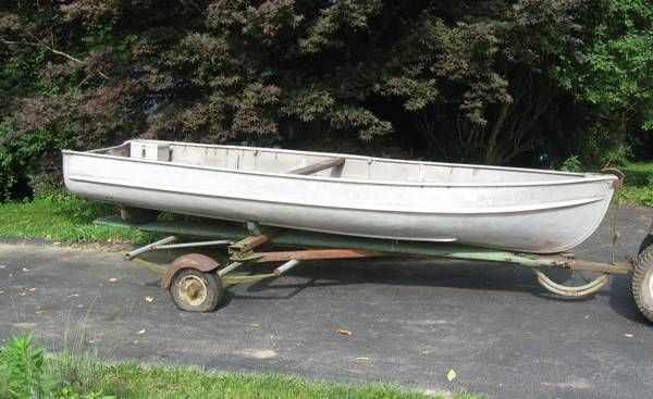

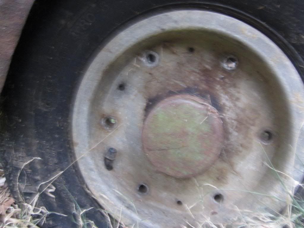

Has anybody ever seen a vintage trailer w/ 4.8X8 rims/tires like these:
Trailer:
I know it's not much to go on, but it's all they had to send.
Appears that the rim is 2 part, held together by the bolts around the outer edge of the rim's inner hub. The large center cap covers a castle nut & cotter pin on the end of the axle hub, NO LUG studs or nuts.
Until I get there Sat afternoon, just before dark, in the rain probably, I won't be able to pull a rim & attempt to fit a different rim to the hub or fit a replacement 4.8X8 tire to the rim, if I can get them to seat and find a 4.8X8 tube. I doubt I'll be able to find a shop willing to mount a tire on a 2 part rim, liability & all.
Not sure if the rim is held together by 'just' a bolt thru 1 side & screwed into threads in the other half, or thru bolted w/ bolts & nuts.
ANY help?
BTW: That's the strangest 'winch' post contraption I've ever seen on a boat.

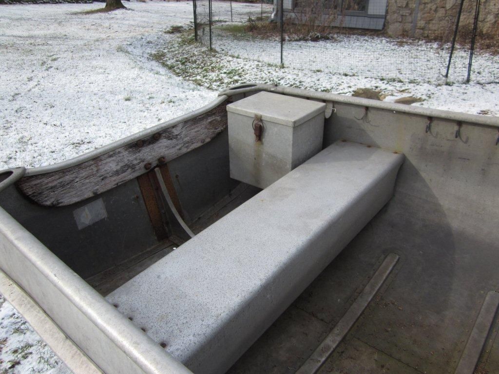

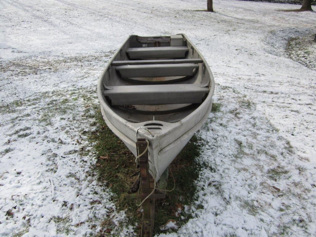

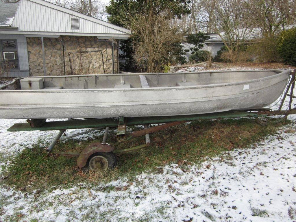

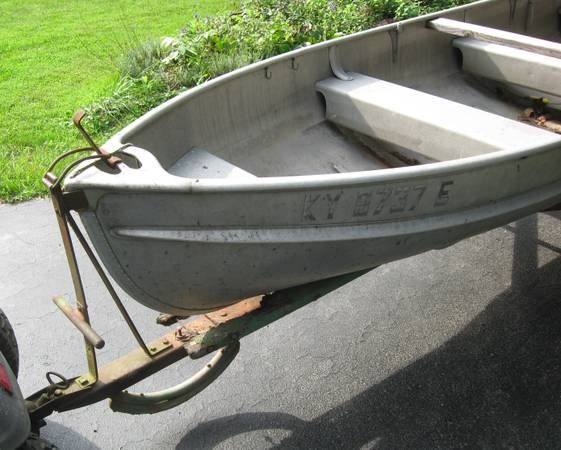

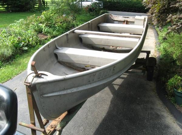

Oops, didn't attach the pix of the 'winch' post:

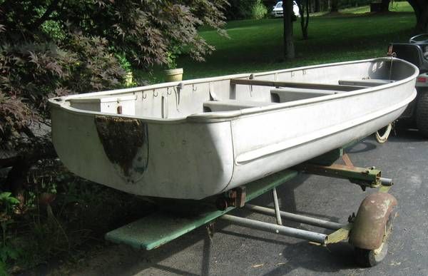

And anther couple of the trailer:
Re:Need help w/ a vintage trailer's axle hub & rims 12 years 8 months ago #88190
I'd say it's a two part. Maybe it's just me but I do not like that trailer.
Re:Need help w/ a vintage trailer's axle hub & rims 12 years 8 months ago #88203
That's a pretty neat old aluminum boat. 14 footer? I once had an older trailer with the no lugs setup where you had to remove the wheel bearing to pull the wheel. A real pain. I found a new lugless spare tire/rim that used the same bearing size and off I went a'boating. One day in the middle of nowhere I got a flat and tried to put on the spare. Wouldn't work because the space between inner and outer bearing races was different from the rims on the trailer. Castle nut would bottom out before the bearings were tight. Couldn't get the bearings to adjust up. It was a long walk to a parts store that had lots of fix-a-flat so I could limp home.
That said, if you can get the bolts loose you should be able to get a tire and tube on there and put the bolts back in. I would bring some penetrating oil along with the sockets you'll need, and maybe a handful of assorted bolts and nuts in case any break off when removing them. Good luck! I hope it gets your new boat home for you.

Tee Nee has rims something like what you have. Except there's are not split rim. I have rebuilt several of these rims. The bearings and race are part of the rim they did not use a hub for these. Napa will have the right bearing and grease seals. Those rims do not require a tube but I put tubes in mine because I have had trouble getting them to seal up
The real hard part is to find an extra rim for a spare

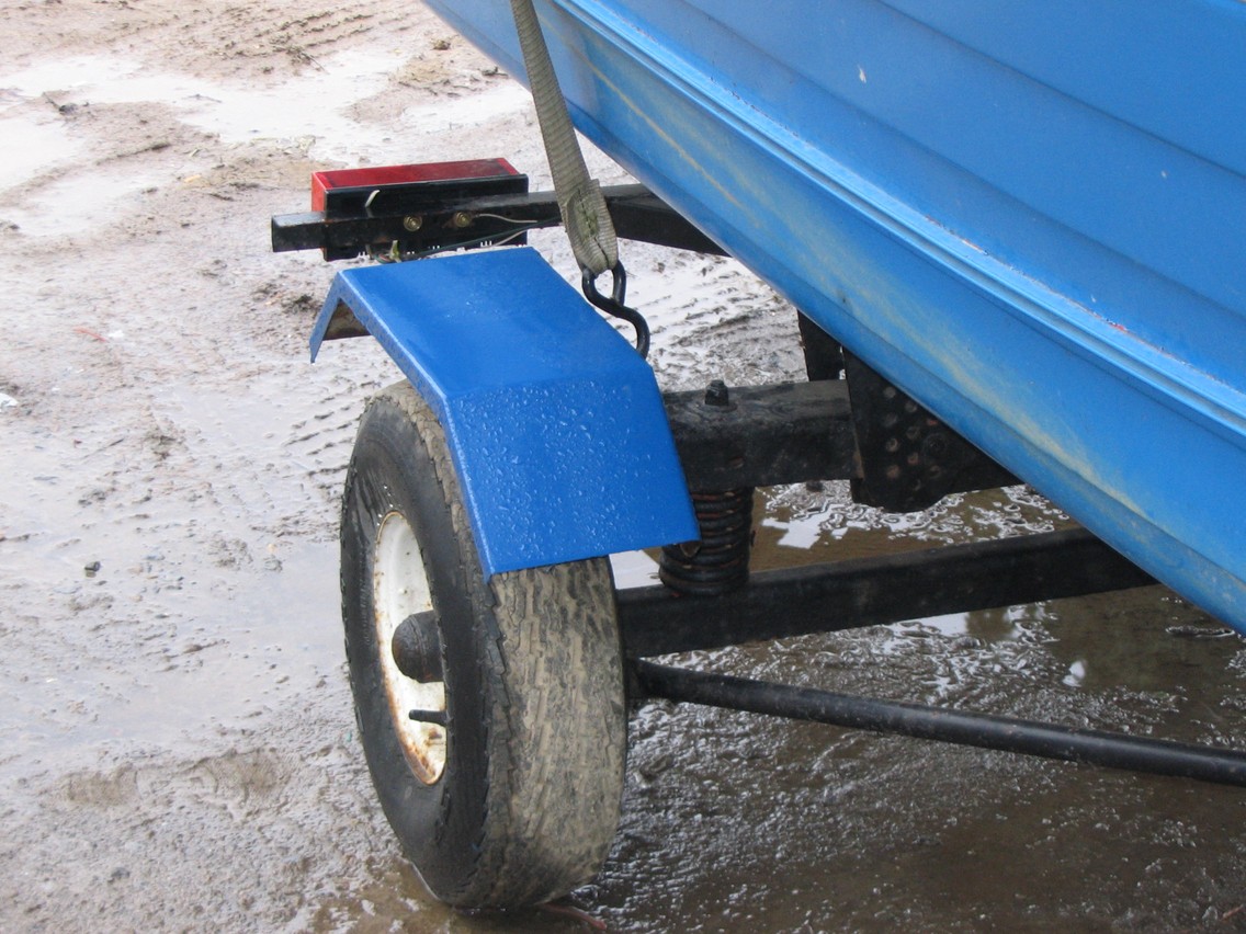

Here's 1 of your pix:
If I had some sheet metal skills & it was less then a third of the country away, maybe. It'd be a nice looking trailer to have under lots of classics.
I like the fenders:
Probably more then a gator's
