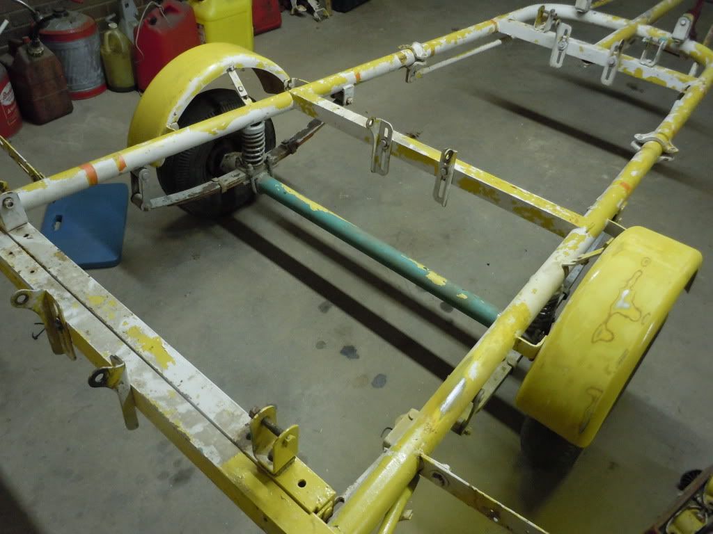

I got my gator stripped today and I think I'm going to get it sandblasted so it will paint up good.It's got about three coats of paint.I already have the bunks painted and carpeted.Do you guys think sand blasting is the way to go??
Re:Painting my gator...finally 14 years 9 months ago #51448
In my opinion, it is Jim, if you can afford it. I would break down the trailer as much as possible, (unbolt everything) to make access to the area behind/under brackets and such better, it makes transporting it tougher but will result in a better job in the long run. Just make sure you get all the media (sand) out of all the nooks and crannies when it's done. Just my two cents worth........ ;)
Re:Painting my gator...finally 14 years 9 months ago #51454
I'm with Mark, if you're looking for a quality job, blasting is the only way to go.

yes jim, sandblasting is the best way to go. as mark said get all the sand cleanded off before painting. it will seem like it cost more to have it blasted but in the long run it will save you time and grief, plus the cost of matterals like sand paper and such do add up. and the finished job will last alot longer cuz all the old paint and rust will be gone. i think you will be happier getting it blasted. it sure is going to be a nice trailer when your done. great job so far. frog

Thanks Mark,Bill and frog. I'm going to find out ASAP the price. I have an old smaller blaster, But I think I'd be better off getting a professional. And I still have to redo the winch so it'll come together hopefully soon. Bill, your Tee Nee is spectacular!!

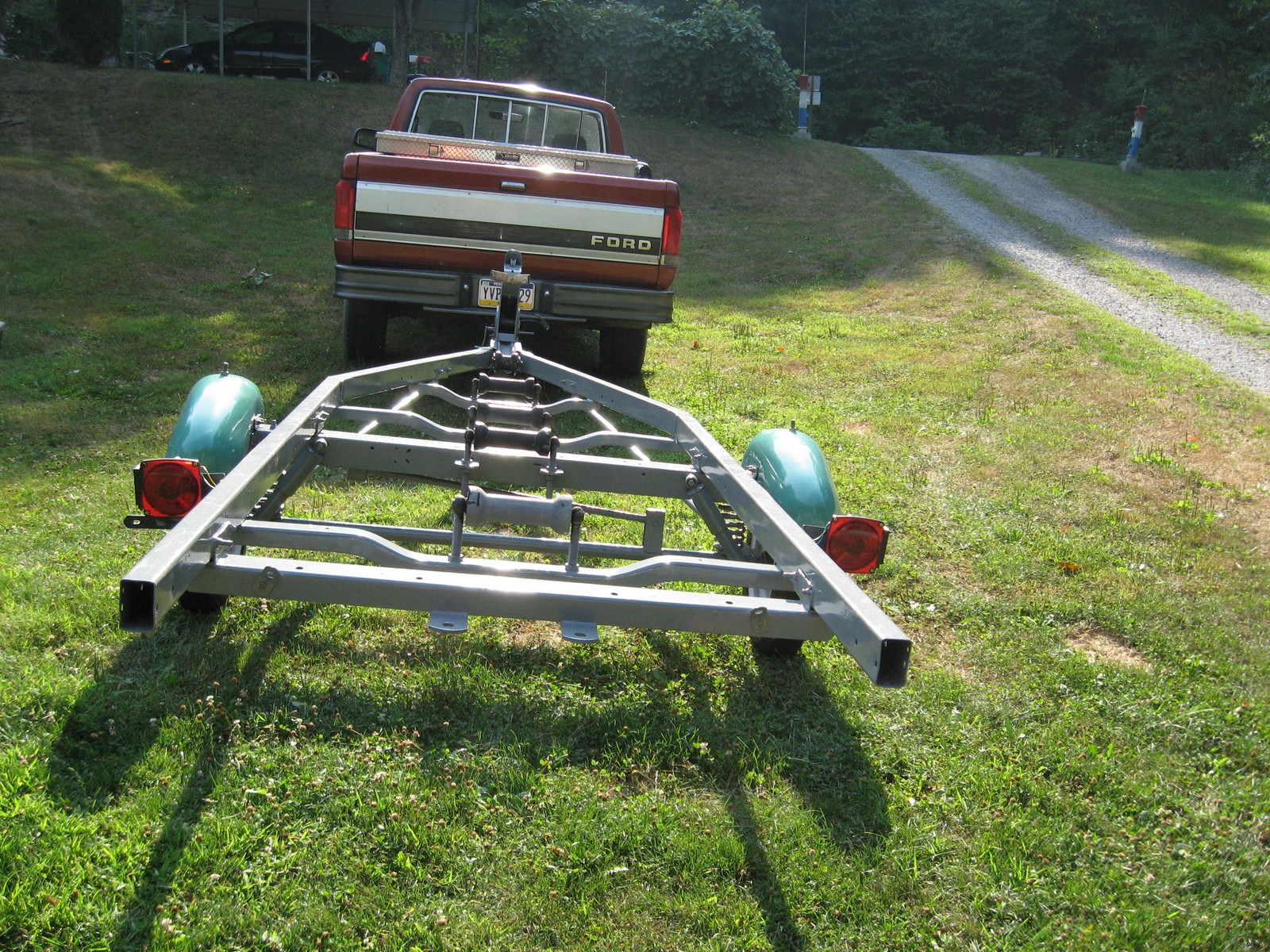

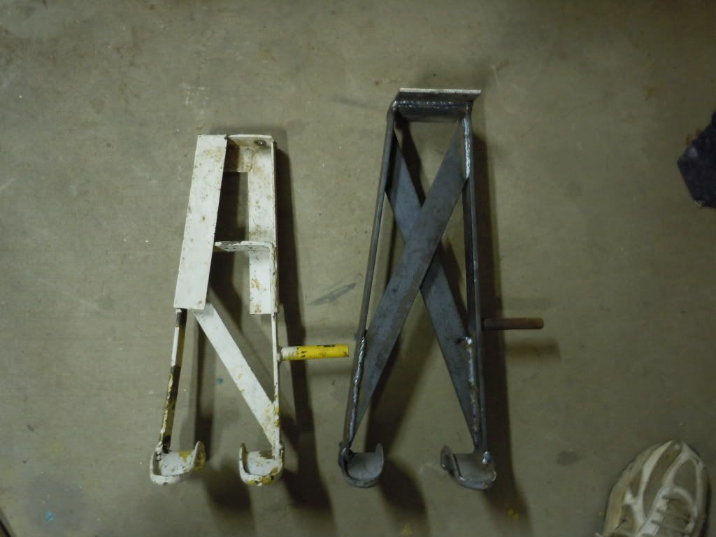

Sandblasted my trailer today. A friend who is a welder made me a new winch stand so I'm getting closer. :)
Re:Painting my gator...finally 14 years 9 months ago #52053
I noticed the pic in the decal thread, looks like the trailer turned out pretty darn nice Jim. The winch stand looks great too! ;)

Thanks Mark,I did it myself with my little bucket blaster, but I used my welder friend's BIG air compressor. WOW, what a difference! Took two bags of sand $16.00. Yes, he did a great job on the stand. It's stronger than the other one. jim

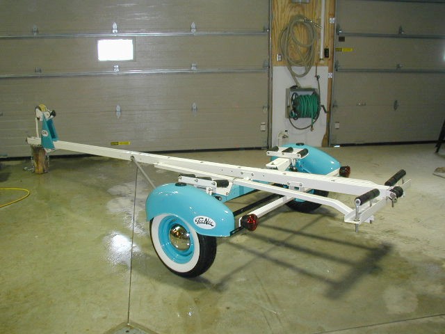

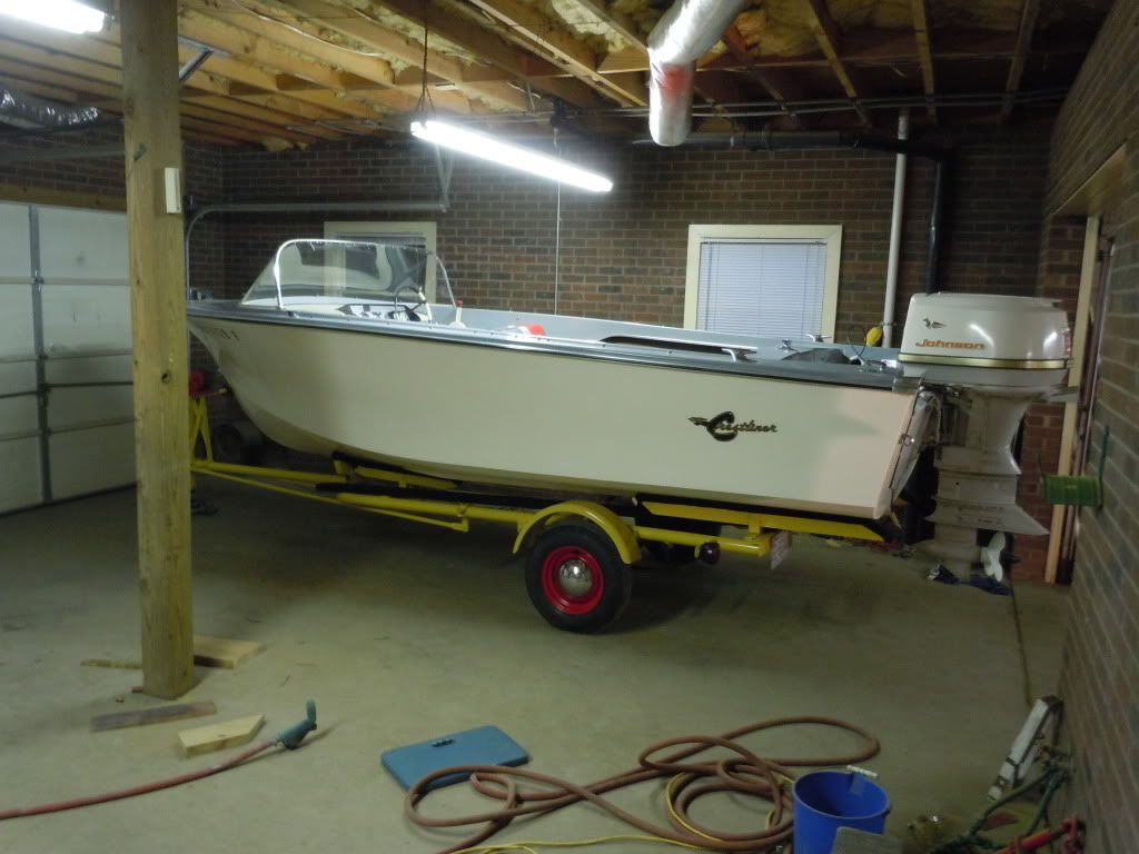

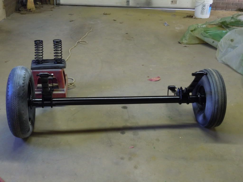

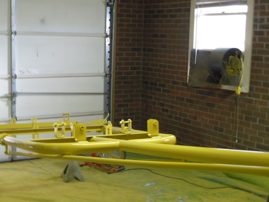

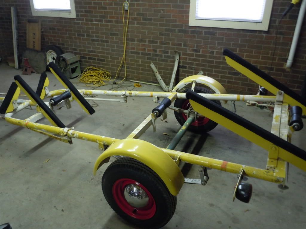

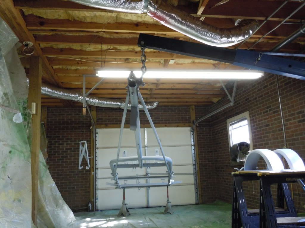

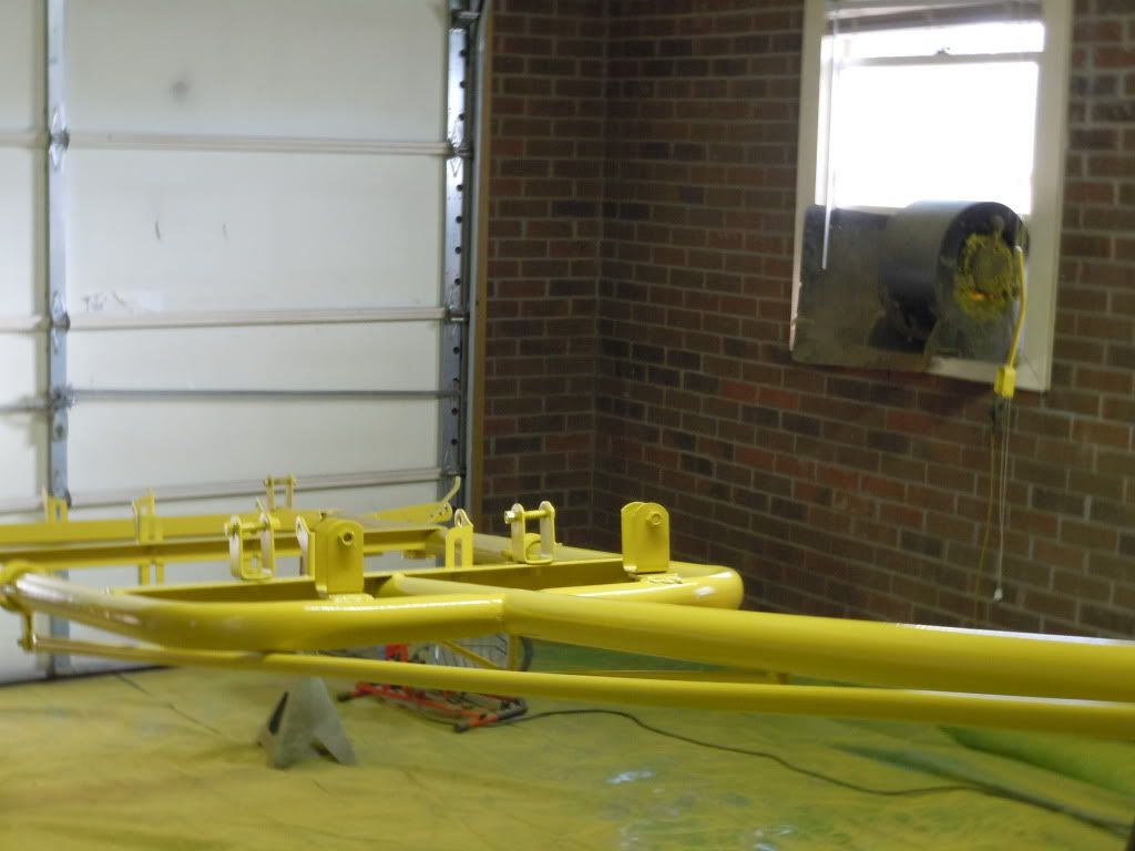

Thought I'd share some more pics of the fun I had and the finished trailer. I got done this afternoon.I think it turned out decent,but I had to paint the fenders twice to fix a couple of runs :P . Now I can clean up in here :laugh: .

There's nothing nicer than a beautiful boat sitting on a beautiful trailer. Big thumbs up!!!

jim, you did a great job on your gator. now were do i send my elgin trailer to for you to do? lol. good work, looks like new. frog

Your Gator trailer looks really nice Jim. Great job on her. Love these vintage trailers. I second Shelby18.
You'll find that the extra long leaf springs gives it a softer ride too. Enjoy your newly restored Gator.
