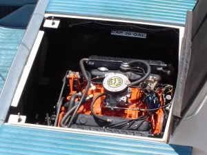

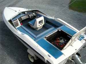

Nice boat my friend. Your top pic looking down seems to show that interior is original. I'd need to see a close up to tell you for sure. The back sun panels are usually the first to go but look nice on your as well.
I think the hull's been repainted and they pretty much stuck to a few colour schemes. And you have the Volvo leg which is preferable. I have the Chrysler 300 Stern in mine which is rare but the Volvo is more dependable and easier for parts.
That 340 is called a Super Vee (Sweet eh!) and drove both the jets and the Volvo legs for 73.
Your dash looks awesome and dark as well.

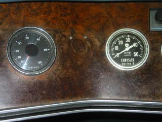

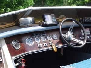

Bill,

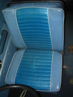

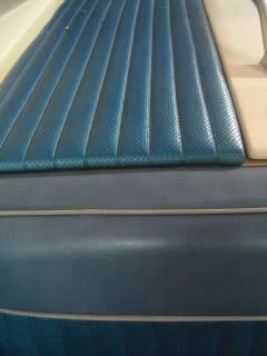

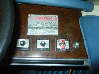

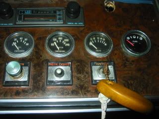

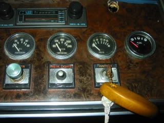

I just took these closeups of the interior and the instrument panel.
Also, of all the boats like this I've seen on the net, they all have blue interior..except yours. What color options were available?
I'm no expert on fiberglass, but I don't see any evidence of paint on the white parts of the boat. It looks like just the gelcoat. Is that possible?
I know the blue stripe was repainted at some point, incorrectly it seems, but other than that, I don't see any obvious signs of paintwork.
Re:newbie with '73 Chrysler Conqueror S-III 16 years 4 months ago #9554
Pretty pristine interior for a '73 Guy, somebody must have taken really good care of it. Nice!
