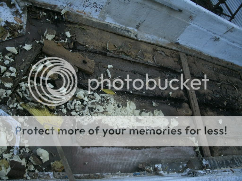

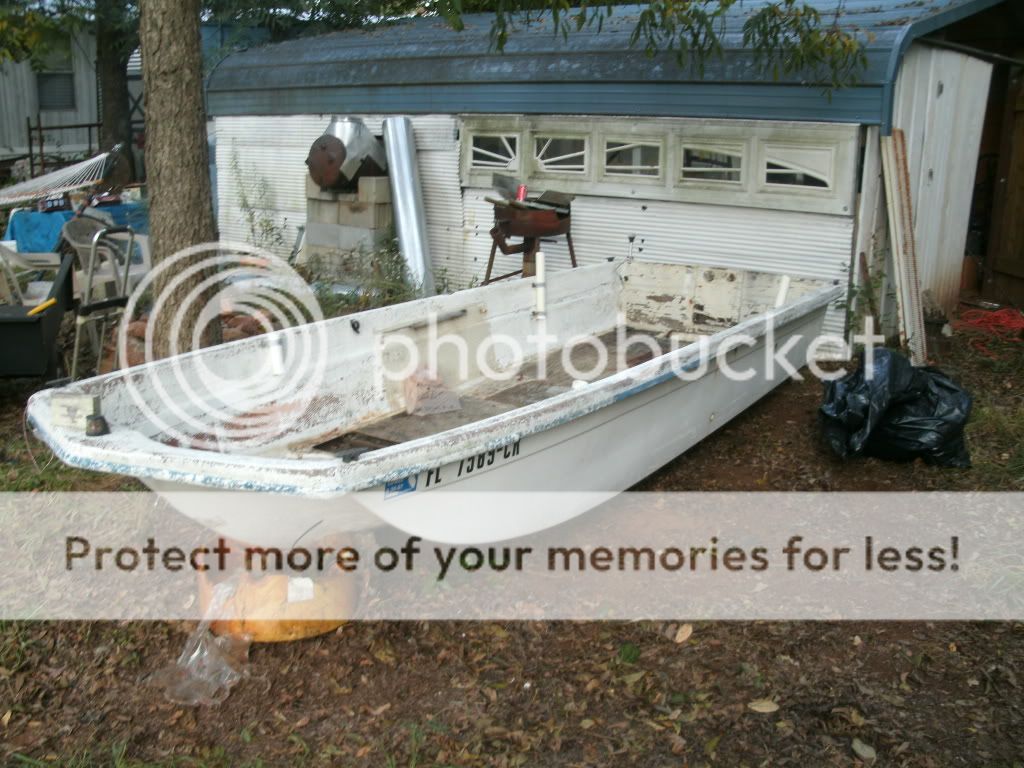

I know this isn't the most stylish of boats but out of the 3 i have its the most strait forward to repair. If every thing goes well ill have it out on saluda river fishing my day away this coming spring.

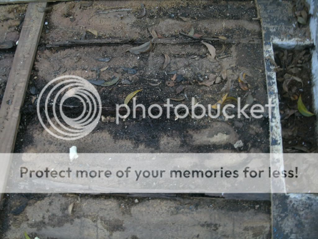

I cut what was left of the floor out, and found as i was expecting all the stringers are completely rotted.
I am getting all the old foam out. its kinda slow going. i have found 2 tools to make it easier. An old cheap garden shovel and a Black and Decker project-mate using the scraping attachment.

"Ataboy" for getting started on her RB, take your time and document (with pics too) everything on placement, size, etc. as (before) you tear her down. You'll love the oscillating (multi) tools, they're great!

Finally got an oscillating tool had to go to HF for one. Looks like tractor supply is on back order for them. I finished cutting out the floor leaving about an inch or so of fiberglass that went over the floor. I have scraped out 99% of the foam not much of it left except right around the stringers.
I was thinking and let me know if I am on the wrong track. I want to take some foam and cut it to fit under the lip of fiber glass then glass it in making a sturdy lip for the floor to sit on. Just don't know if its a good idea or not.
Re:Started my first prject 15 years 1 week ago #49555
I think that will work. I thought about doing something similar on my Glastron but after replacing all of the stringers, I figured that the bond between the new deck and the inside walls would be very strong and I didn't put any support there.
