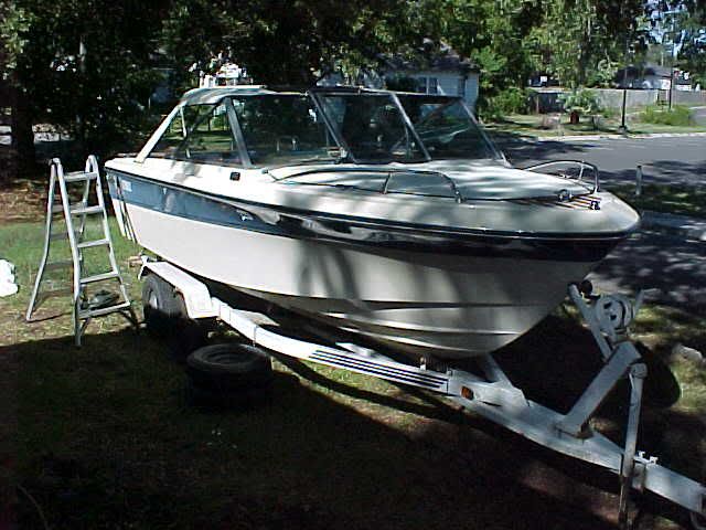

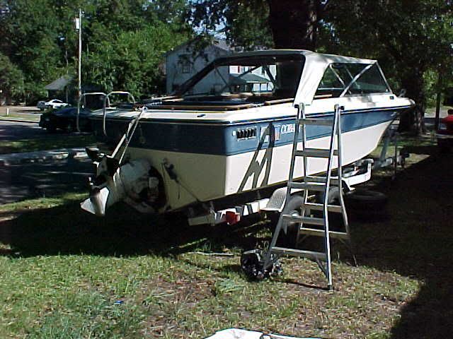

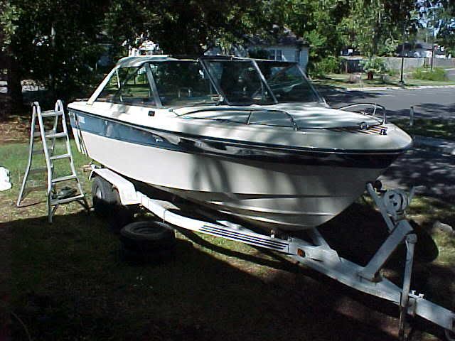

I just got home with my first boat, a 1977 Cobalt 19BR. It has the OMC 235HP (Ford 351 Windsor), and the Hobbs meter shows 377.1 hours. The floor is solid as a rock, and the interior is in good condition (albeit with some fading). There are a couple of spots on the port side where someone has done a spray-can touchup (I suspect from hold-downs on a road cover), but the hull is solid and should buff up nicely. It'll probably take me all winter to clean and oil all the teak.
This boat is a big departure from what I started out looking for. I wanted a boat and trailer package that weighed no more than 1500 pounds, so I could get it out of the water with my car. I also really wanted something with tailfins. Unfortunately, I couldn't have what I wanted and take the whole extended family out too. I'd been admiring a Cobalt locally for a couple of years, so when this one came up for sale, I jumped.
Here's the fun part. I asked the seller for 6 weeks to pick it up, and he agreed. He lives about 750 miles from me, so it was going to be a trip. As it turned out, he was going to be in southern Missouri, 250 miles from me, this weekend. He brought the boat along for $100 to cover the extra gas, and it turned it into a day trip for me.

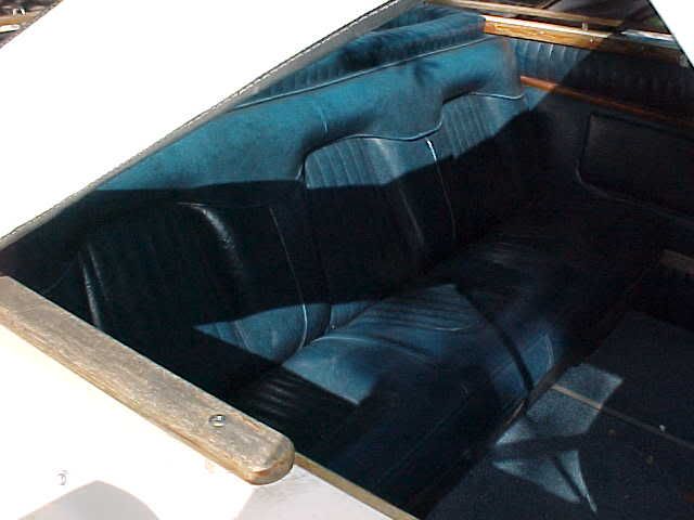

This Cobalt has the optional seating arrangement, two captain's chairs with a rear bench and sundeck instead of the two small rear buckets and the back-to-back lounges. The rear bench is very comfortable, and plenty roomy enough for 3 adults. The bow will also seat 3 comfortably.

I played with the gelcoat a bit the last couple of days. The white will hand polish to a mirror finish with just the Meguiar's fine-cut cleaner. I'll have to work some of the deeper rub marks a bit, but aside from some rash from a tie-down on one side of the deck, all the topside gelcoat will be beautiful.
The blue stripe is a different story. I'll have to color sand it to bring any depth back, but it'll be worth the effort. As for the spray touchups on the bottom of the port side, I'm going to leave those alone for now. Once I have the rest detailed, I'll probably order some factory-matched gelcoat and touch those up right.

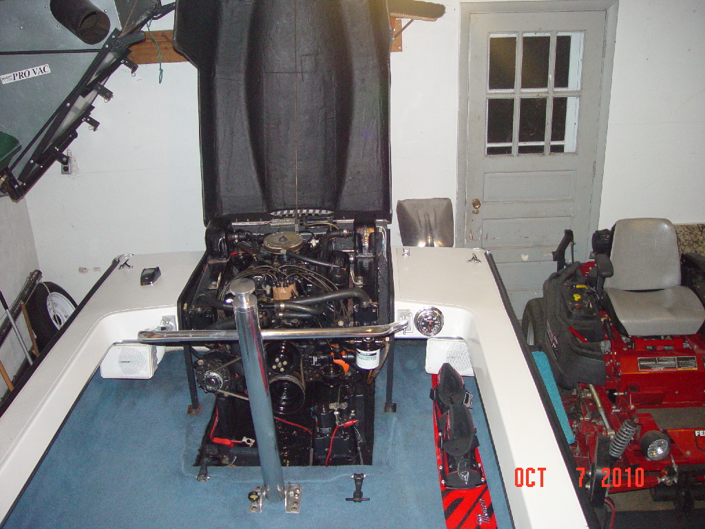

Mercury Marine Had a very short run (1976-77) on a mercruiser 351 cid. "marine" block that had similar sized heads as the Ford 351 windsor, but it is by no means an automible engine so I'd refrain from the term "widnsor" for marine speak; unless it was transplanted from an auto which can come with a host of challenges.
If it is a mercruiser 351 cid, it should be rated at 233 hp, not 235 unless som modifications were made to boost it. A pic of my engine is attached which should match up.
Cheers!
Kevin-
Re:High Class Disco Glass! 15 years 8 months ago #25517
Opps, Here are the pics. When I purchased my 1970s Hydrodyne Tournament skier +14 years ago, I ordered the engine shop manual through Mercury Narine (Fond du Lac, WI) upon purchase. They had some difficulty tracking it down due to the short production run of the engine.
With it's stock two barrel Rochester carb, it is a mieser on fuel. However, mine (and I assume yours as well) requires premium 93% octaine. Don't forget to purchase and use a leaded gas addative (CR-12 or something like that) as these heads are built with soft valve seats and will shread with unleaded fuel.
