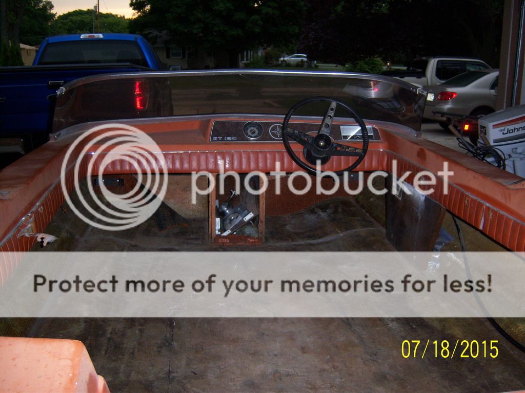

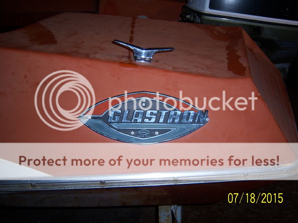

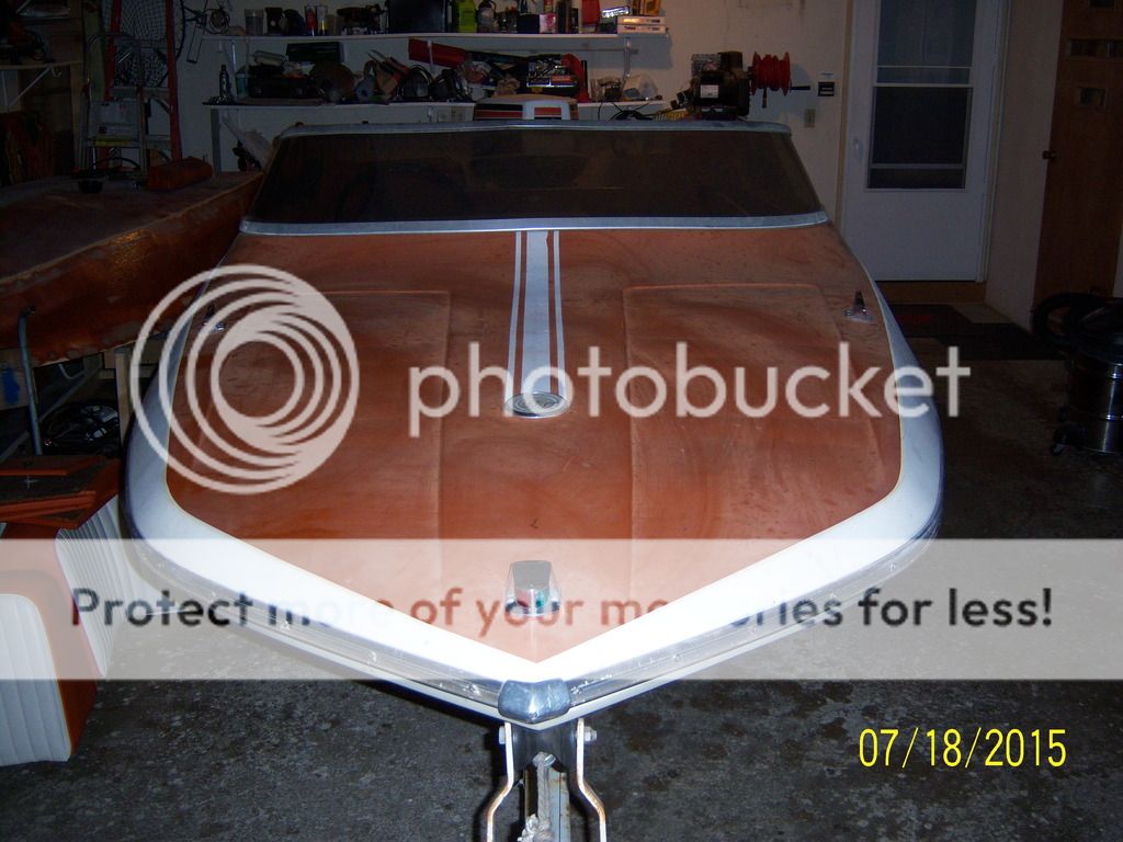

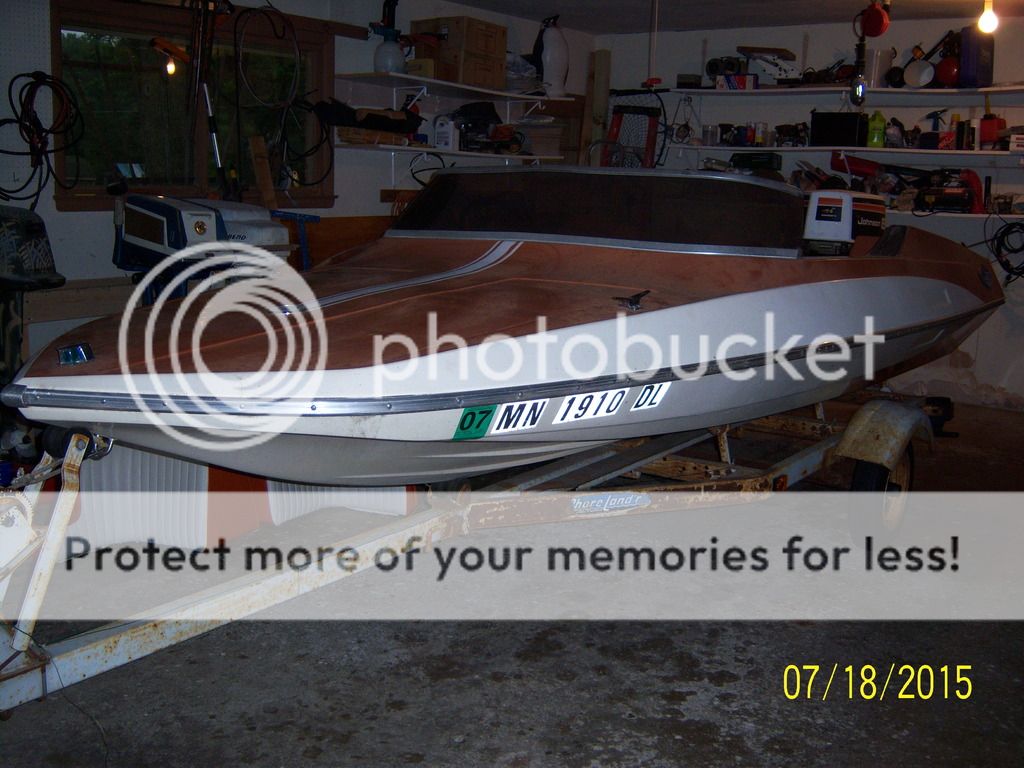

Got her home!! Sorry guys, I jumped the gun a bit and started disassembly before I got the camera out. Ripped out old nasty carpet, started to take windshield apart. The windshield is tinted and MINT!! Check out my new girlfriend!

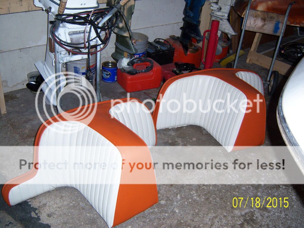

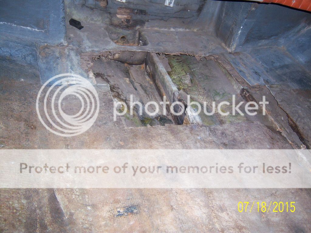

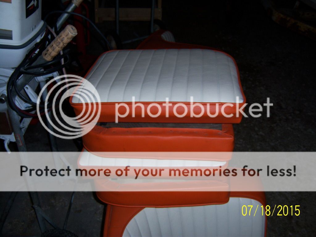

Here's the best part. The last owner had the seats redone in the original colors, orange and off white. The are SWEET!! That alone will save me a huge chunk of change!
Now the ugly.. needs stringers and floor as well as a transom.
Compared to putting new floors and a transom in a 22' StarCraft islander this little sweetie should be a walk in the park. I'm going to work on popping the upper half off today. Supposed to be 92 and really humid, so I don't know how far I will get but theres nothing like a new love in your life to keep you motivated.
