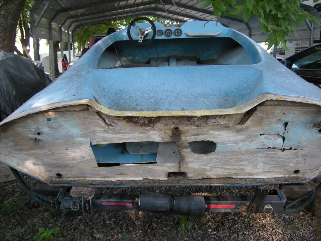

I finally brought my Challenger home from Texas. It is going to need a transom. I took off the rub rail and find the shoe-box seam glassed together from the inside, SO...looking under the deck it sure looks little under there, I am trying to decide whether I want to try to cut the glass from the inside to release the deck from the hull, or just take a sawzall to it, cut the joint and glass it back together afterward. I'm a little concerned with hull distortion once the deck is off if I just cut it apart.
Opinions? (Not looking forward to cutting the glass under the deck to release the shoe box joint...I've inhaled too much fiberglass dust already...)

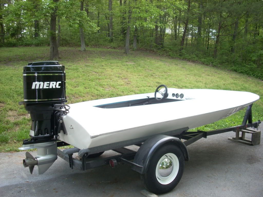

Well its been a while....
First off, I was wrong, this boat was a Contender, not a Challenger. I was able to rebuild it and get it back on the water. I was pretty stoked about the BP mid it came with but it was really just noisy. Turned out looking pretty cool though, Here are before and after pics.
I really didnt like the flat bottom and sold it off to some guy who came through town for the NHRA drags and he took it back to Indianapolis. I put a jack plate on it before I sold it. I never really got it dialed in for speed, but IT COULD'A BEEN A CONTENDER!
