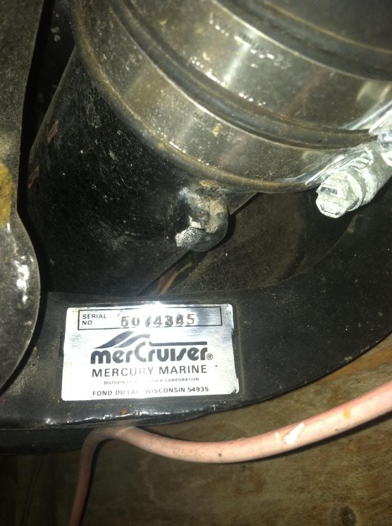

Just obtained a 1962 Thompson Bros. lapstrake boat with stern drive! The engine is a 6 cylinder. A tag indicates Mercury, Kiekhaefer Corp, serial number 1631704. Cast into the block at another location is: CM (might be GM) 377127.
Wondering what year this is? Is it 1962?
Pic of tag on newer outdrive:

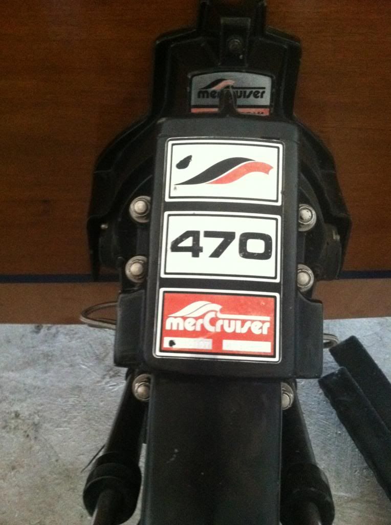

The outdrive is much newer. MerCruiser serial number 5074345 and on the outside it indicates "470" and numbers 6030107 1-84R
Andreas

The engine is a 1962/1963 194 CID 140 HP. If it runs, use it & treat it carefully, be sure to winterize it well.
The drive, transom plate & trim system is late 70s to 1981 vintage. From the serial number, late 70s. 1.84:1 ratio was the standard ratio for a 170/470 engine package.

Serial number breakdowns for MerCruiser inline 6 engines:
140 HP 194 CID s/n 1538930-1725960
150 HP 230 CID s/n 1666495-2048043 notice an overlap with above
160 HP 250 CID s/n 2048022-2770031 notice an overlap again
165 HP 250 CID s/n 2770032 and up
