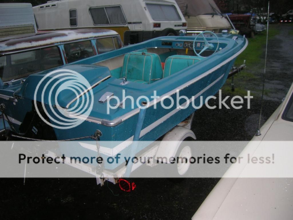

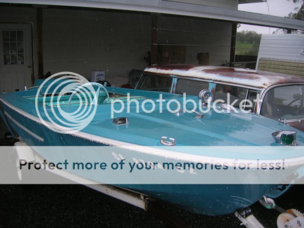

Could not pass this one up. The last project has been done for a couple years. I saw this one three years ago and it was not for sale, but it just popped up and I just HAPPENED to be looking at adds.. So-- NOW I got it.. BUT it has the Merc 80 stern drive. With a water pump problem.
I have not looked at it even a little-- Just brought it home and am busy with other stuff.. Can I get parts for this? I was told the engine is OK.. The outdrive lower has been removed, I HOPE all the small parts are in the boat.
Will also be looking for windshield hardware.
Yes, I would be open to changing the Renault out for a 153 Chevy 4 cylinder if a donor boat came along and there were no other realistic options.

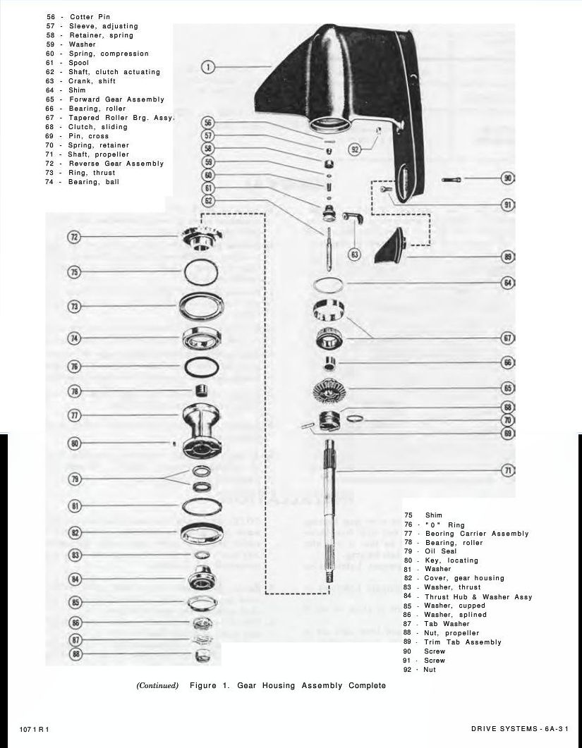

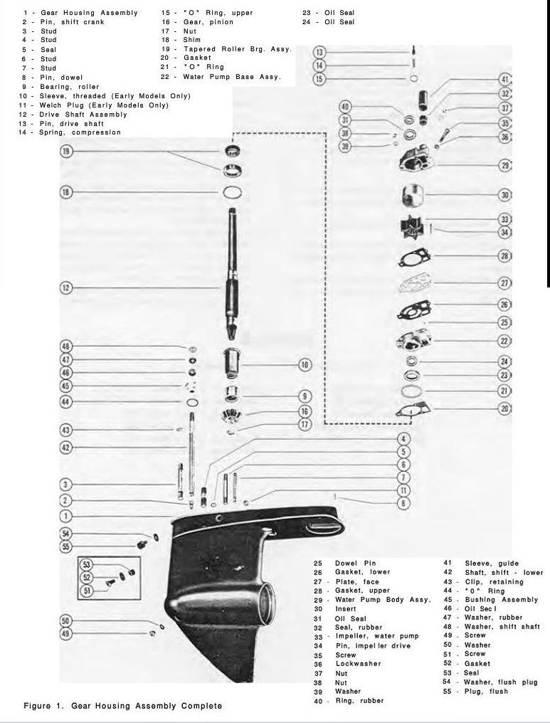

Following are a few diagrams from a MerCruiser manual. If your sterndrive is disassembled in pieces, you will likely need to locate a replacement/donor unit.

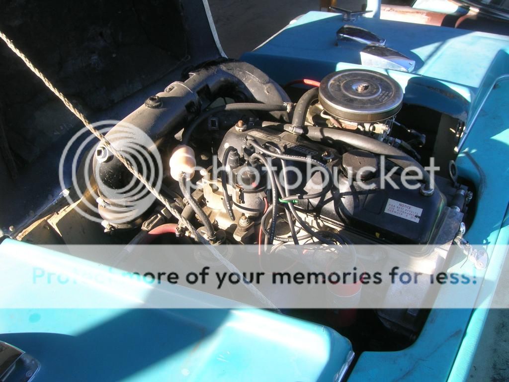

Hi Rod,
I hope that I can make a few comments that you will find helpful.
From the pictures:
(1) the lower shift shaft has pulled out of the gear housing assembly (lower portion of drive unit). This almost always requires that the propeller shaft be removed to allow the reinstallation of the shift shaft into the shift cam.
(2) the "Oil and Water Adaptor Assembly" (it is not a water pump housing) is badly melted, likely from being started briefly without water supply to the cooling system. It is very likely that any of the rubber or plastic components in the exhaust system will be damaged and need replacements also. The water pump is in the top of the driveshaft housing (upper portion of the drive unit), and will very likely also need total replacement due to lack of water.
The posted Mercruiser breakdown pictures are not really correct for the view of a Mercruiser 80 unfortunately.
