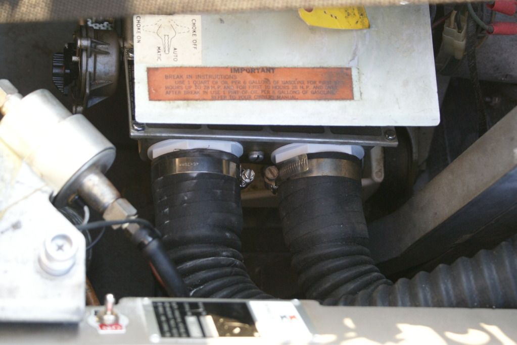

...well at least I hope so. I'm building an intake muffler for my 1965 OMC DU.
So far it involves 2 flexible rubber 2-1/4" radiator hoses and a large PVC, pipe in pipe, muffler.
I took the Aluminum spark arrestor off the parts boat and drilled 2 large holes in it. I capped off the top with an aluminum sheet. The two intake nipples on the spark arrestor box were made from toilet tank flapper valve seats.

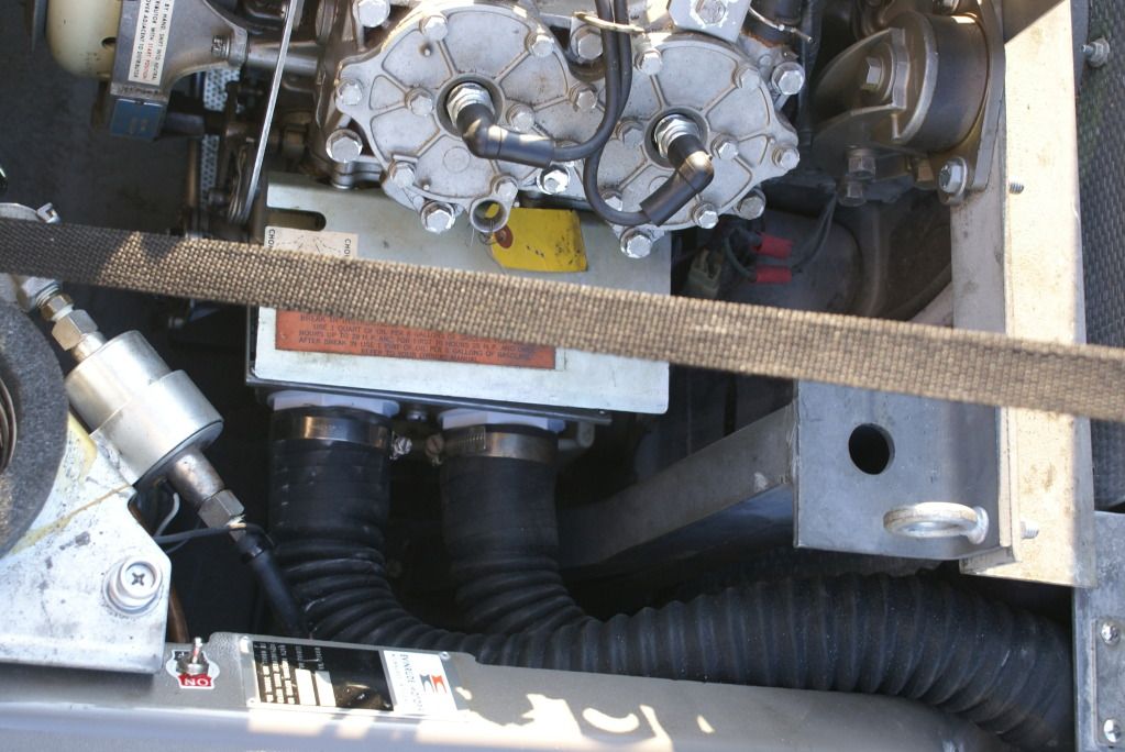

I decided to go the easy way first. I just piped the carb intake to the rear engine compartment vent with flexible rubber radiator hoses. They are corrugated both inside and out, so they should really knock the noise down.
Re:The silencer 14 years 4 months ago #63638
  • jepstr67
  • jepstr67's Avatar Topic Author
  • Posts: 649
  • Karma: 13
Well, the easy way...
did not work.
However: It did capture all the noise and aim it out the back. Plan B will be to incorporate the muffler and air box.
Also you can see along the side where I added a toggle switch for the fuel pump. It has a valve to shut off the gas to run it out, but the pump runs dry then. I figured, not only will it save the pump, but if I forget, and leave the key on after the gas runs out, it won't kill the battery.

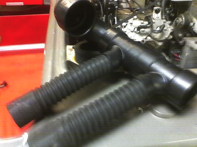

OK here is the next phase.

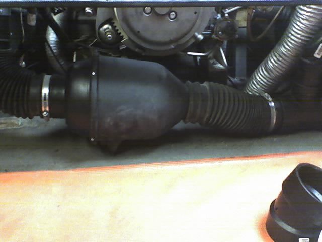

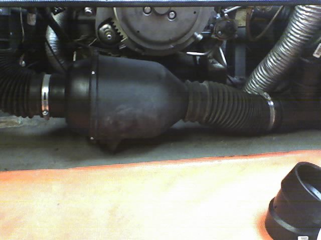

I'm using ABS drain pipe for the manifold. The rubber radiator hoses attach to the custom spark arrestor box as shown above. The 3" elbow connects into a Chevy V8 pickup intake silencer. It comes out as a 2" elbow and adds back into the main 3" intake pipe. From there it will go to big cone shaped intake silencer off a Ford. I'll pack the 8" Ford air cone with coarse stainless wool. I capped that with a ABS plastic floor drain with a 3"pipe as the intake. There it will elbow up to a 4" in line bilge blower fan (to offset all this pipe resistance) and then to an intake port in the hood.
I'm having fun. I should be able to test next week. I'm not gluing anything until I hear how it works. There sure is a lot of space back there for all this pipe.
Re:The silencer 14 years 3 months ago #65874
  • jepstr67
  • Posts: 649
  • Karma: 13
OK well, I hope to test this out tomorrow!
Here's the Ford air cone.

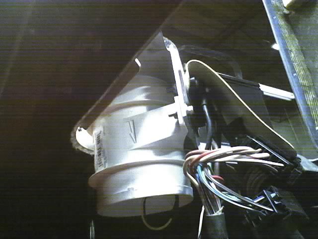

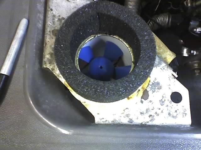

This is my bilge blower I added to keep the whole intake matrix pressurized so the motor doesn't have to work for air.
From the top here, it will suck from a vent in the engine hood.

However I was concerned that I did not want my boost blower running at idle. Then I noticed the mercury switch that cuts out the starter when the throttle it too far advanced, has 2 other contacts. I tested the other contacts and sure as shootin' they connect as the throttle moves ahead of the start position. So I ran my wires to the mercury safety switch. Now my boost blower comes on as I open the throttle past the start position but not at idle.
