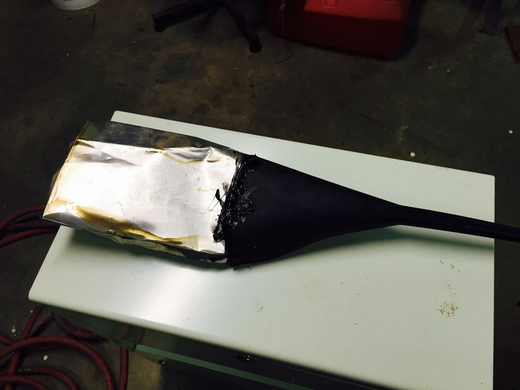

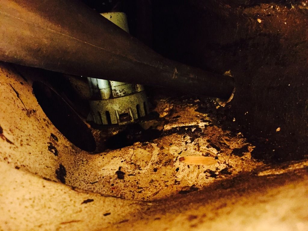

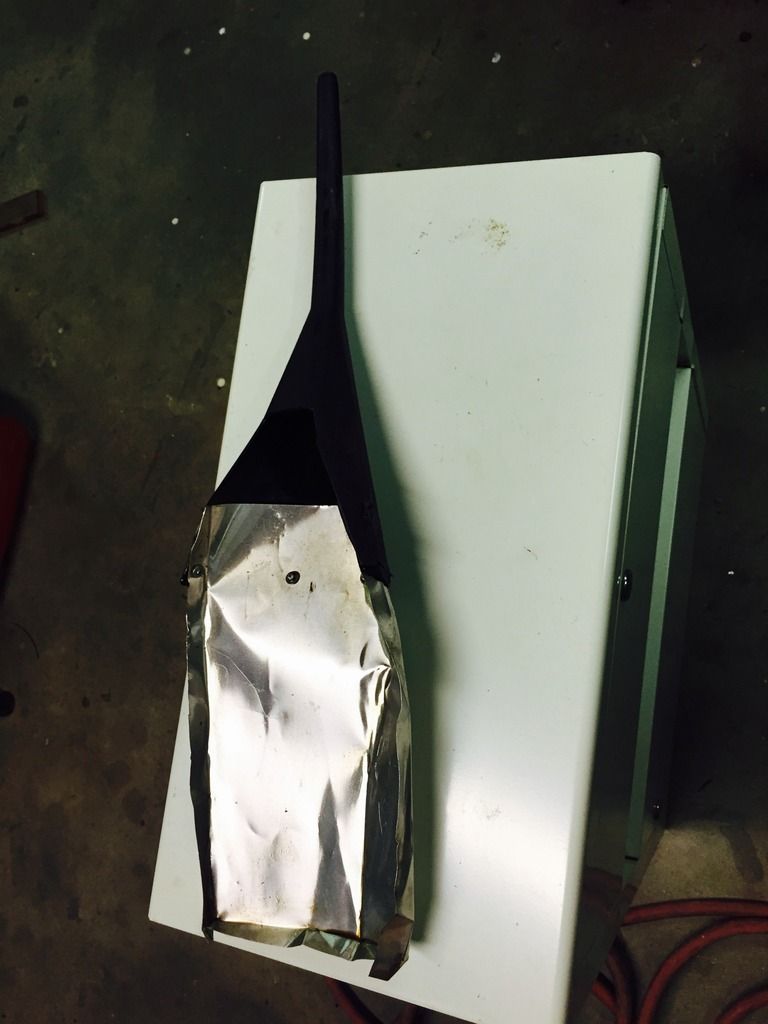

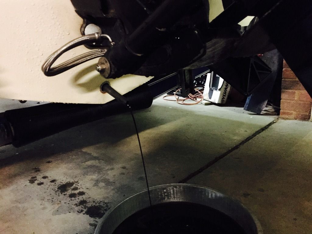

I know this thread is long dead,but I said I'd post some pics of my po man's oil removal device. It actually worked good.

Yep, as a little ingenuity can solve anything!
