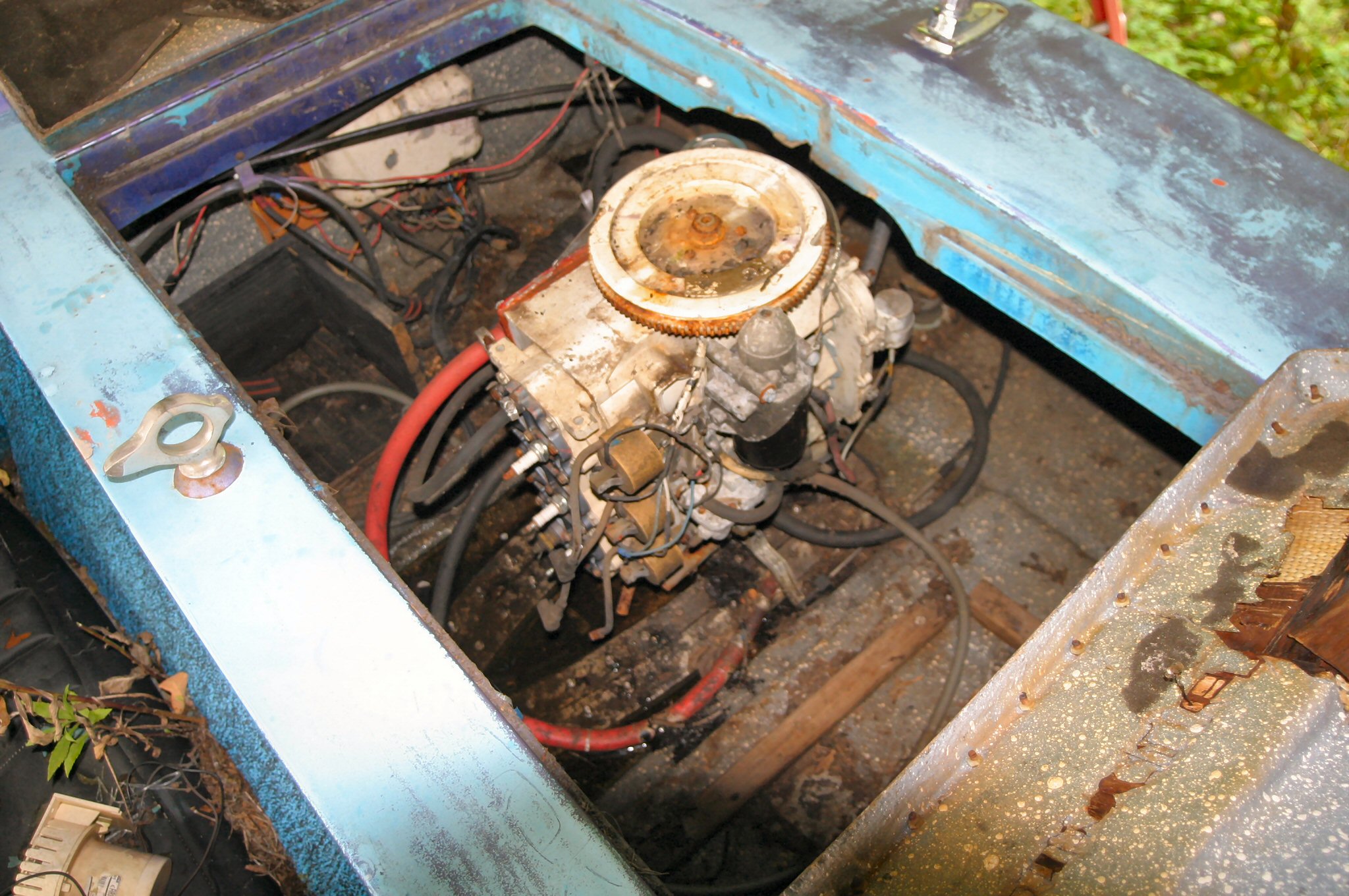

Re:Looking for info 1961 Rambler 14 years 2 months ago #68789
Here is an engine picture. How do you add multiple images to the same post?

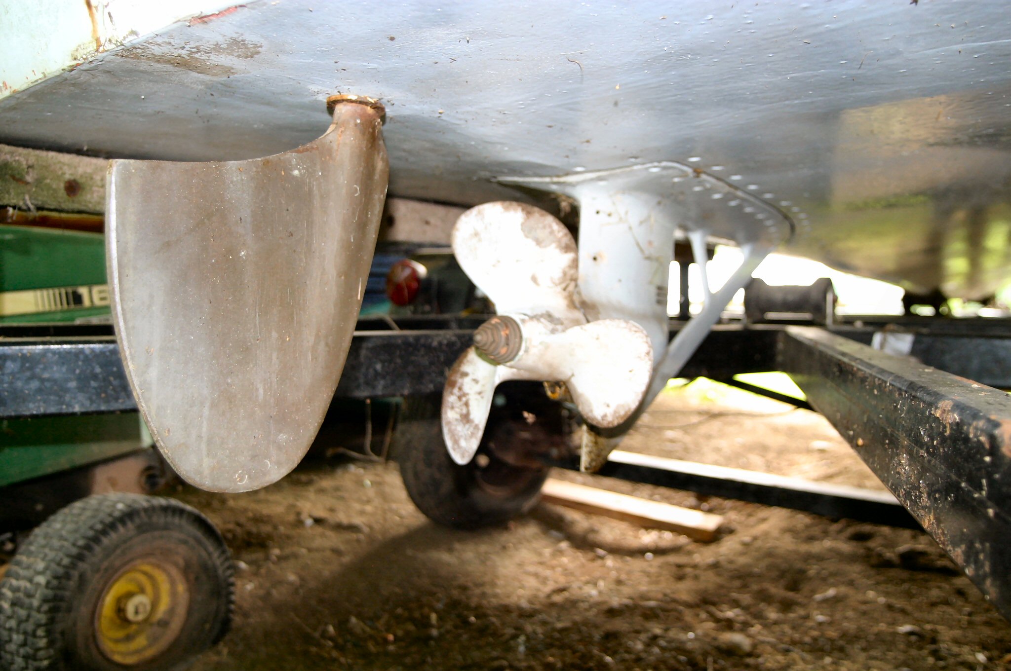

Re:Looking for info 1961 Rambler 14 years 2 months ago #68790
The lower unit and rudder.

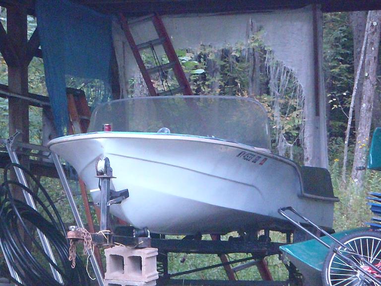

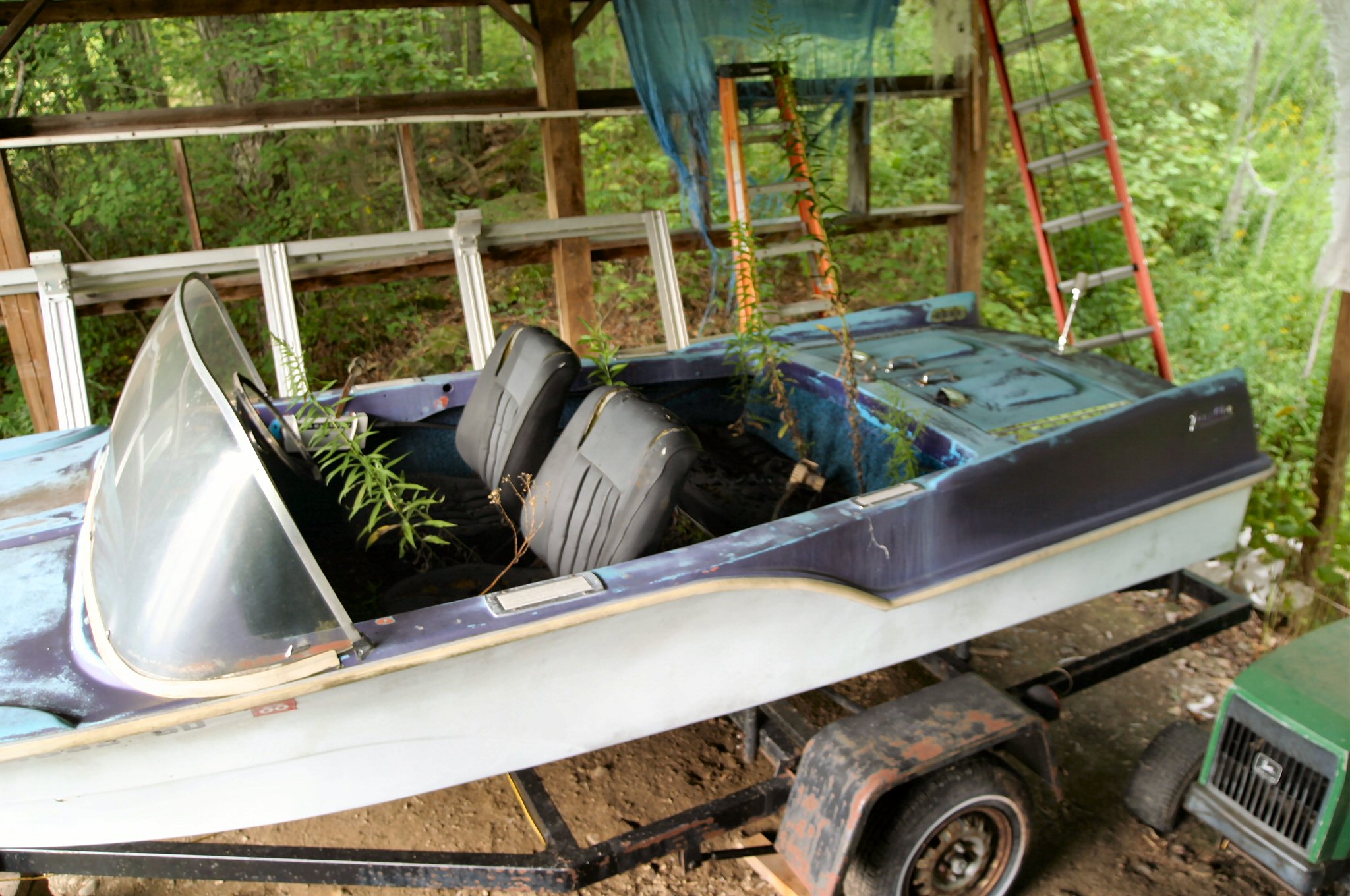

Hello Everyone, Well I baught this boat tonight, Just too cool to pass up. The boat will take a total rebuild. my real question is.. What is this Scott Motor? The Serial on top of it is : 332 - 3197.
I couldnt find a number on the lower unit, but it doesnt look at all home made, any one have a clue as to who made that? Well here are a couple more pictures of the boat. As there are a bunch up top I will put some from the other sides.
I Know nothing about Scott Motors... So any info would be great.

Re:Looking for info 1961 Rambler 14 years 2 months ago #69185
It is probably a 1958 60 HP. The large generator was used on only the 1958 and 1959 model 60 hp. There are some lower unit parts that look like scott atwater parts ( cap, prop nut) The lower unit casting is not familiar.

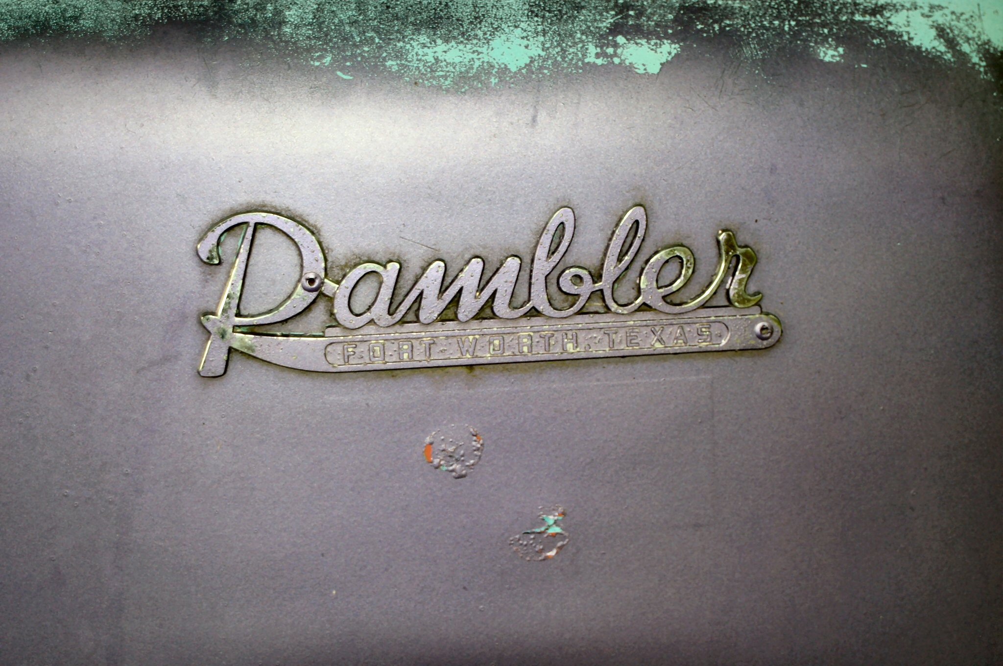

  • Karma: 25
Well In cleaning out the leaves and taking out the totally gone floor we found the hull ID tag, it says. RAMBLER Serial R 6076 Fort worth TX. So doesn’t tell me much more than Rambler is the Manufacturer Not the Model. Sorry for the bad pic.. used my Cell..

  • Karma: 25
Well Dove into the powerhead last night... Its pretty stuck... Looks like it may have been a 40 Horse Scott inboard that some one converted a 60 to fit.. So I may be looking for a new powerhead, 40 HP up to 75? I dont know much about these Scotts do the 40's and 60's/75's share a common drive shaft spline? and prop shaft size? Well if you have one in the Albany NY area I can use for part. Thanks for any help.
