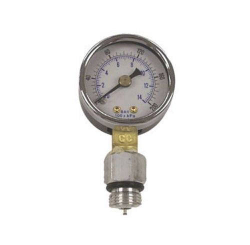

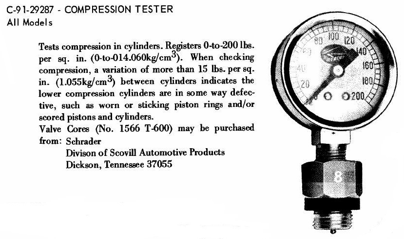

BTW the only compression gage that screws directly into the bottom cyl of the Inlines is a "stubby" like the old Merc tool. I've attached a pic of the Sierra equivalent. Although I've used a flexible-hose-type for years.
But the Doc has an original Merc gauge, Very Cool!

Found a pic of the original!

That looks like my stubby I just bought from John McIntosh (the merc guy from Hayward who has the Merc Decals.

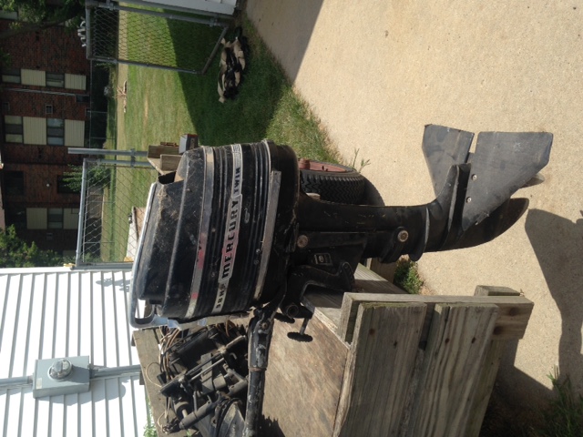

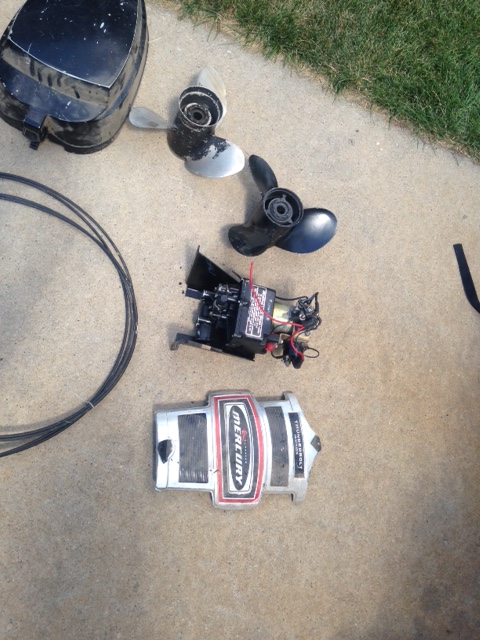

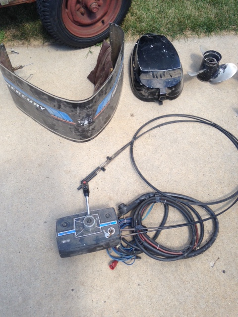

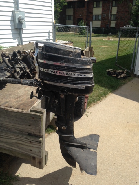

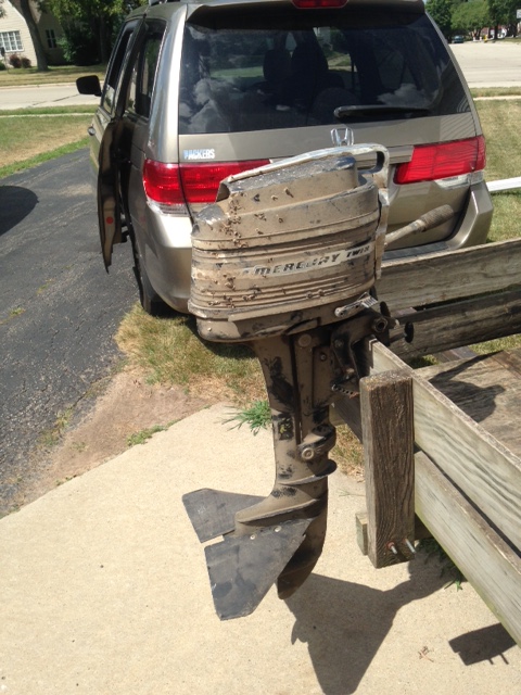

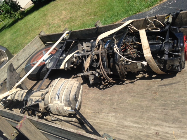

Made the trip yesterday to look at the Merc 1500 and talk to Skeet about his toys. Turns out he was an 80 year guy who figured out he had too may projects. Lots of Mustangs and a couple boat prospects. Spent a few hours there looking at the Merc and skeet was quite the talker!!! Ended up picking up the 1500 and a bonus Merc 110 for $450!!! Feels like a great deal for everything that I ended up with.
Safe at home.
Guess which side it was sitting on????
Merc 1500

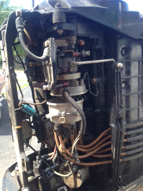

Yes, it does have the biodegradable wiring included

Looks like a project! Lots of nice extras, too.
1st order of business: pull all the plugs, spray some oil in the plug holes, spray some in the carbs, too, spin 'er over with the starter, then do a compression test. Or were you able to get that done before you bought it?
Looks like he might have had some trouble with the distributor, once you get the wiring sorted and a switchbox mounted/hooked up, there are tests you can do to check the switchbox & coil, and see if the distributor is working.
Congrats, looks like you got a decent deal.......ed

I was not able to do a full compression test - no time and I didn't want to figure out how to hook up the controls and battery on the fly. I did put a ratcheting breaker on the crank and turned it a few times after soaking each cylinder with WD-40. Turned like silk, and I did not see anything that would suggest one cylinder was noticeably different from the others.
I will try hooking it up and spinning it this week. put the muffs on it to protect the impellor?
