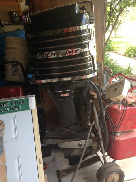

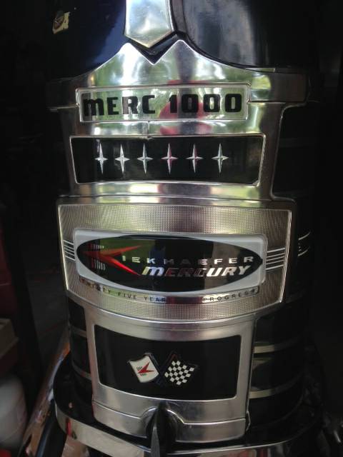

Speaking of "25th" anniversary Phantom Black Towers of power, check out this beautiful one for sale in the Chicago area:
chicago.craigslist.org/sox/boa/5726151851.html
$350 is a Steal! It even has controls and 2 tanks! And the faceplate is in very good shape except for what looks like a small dent.
I'd snap it up immediately if it were here in the PNW.
