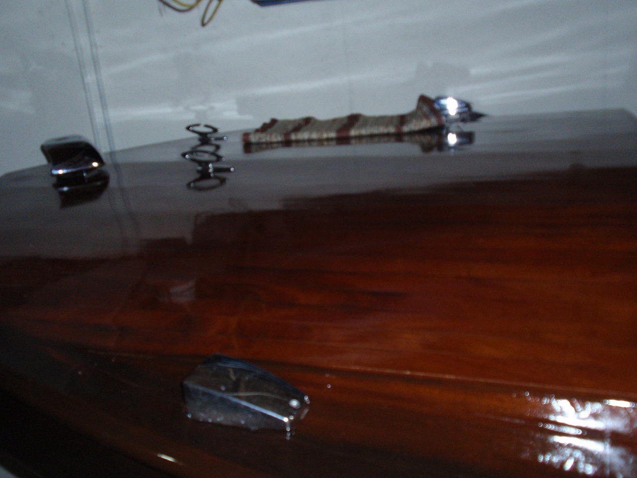

Mark, I've been using that stuff for years on my boats. Don't let the purists know you're using it, shame be on you. The stuff is great. I put 17 coats on my Century in '07 and never had to touch it since. I have 3 coats on my Shell Lake project I'm working on now and you can shave in the reflection. It's hard as a rock also. Here's my top deck. I used Minwax stain and then the Helmsman poly. Did some sanding in between coats.

Great looking finnish there Cal. I have used this product also and have allways been happy with the results.

I never thin the stuff. I find that if you put it on too heavy on a vertical surface it will run. A couple thin coats work best with light sanding in between. I brush a small section and then brush another section feathering the new into the previous before it "sets". Don't try to get a smooth glossy finish when brushing, the stuff flows to a gloss by itself. If it's lumping up you're waiting too long to feather into it. A second coat requires it to dry completely, at least a day. Don't rush it.
Try different techniques on some scrap wood.
The above pictures of my wood deck has I think 3 coats.
Good luck.
Cal
