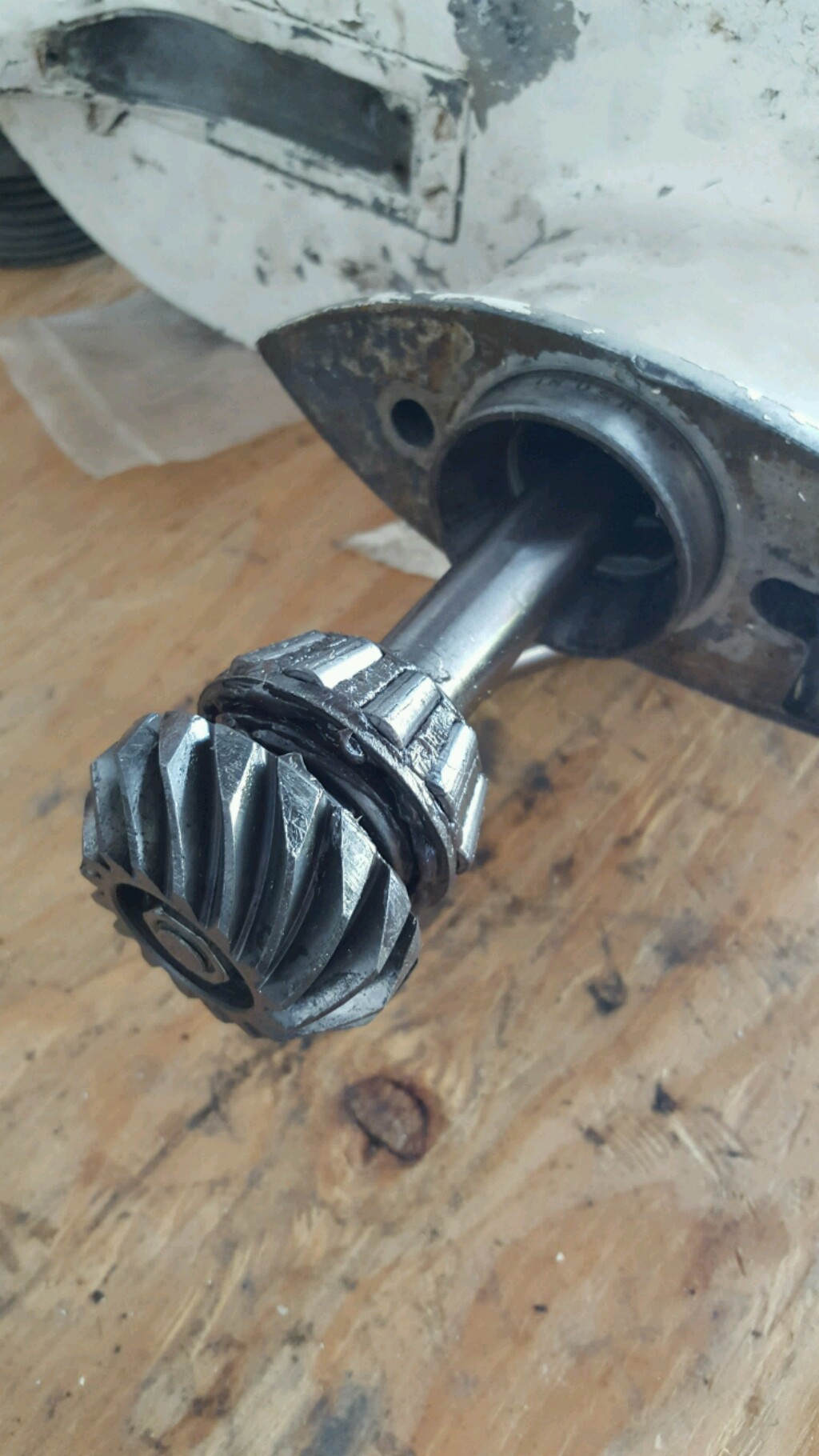

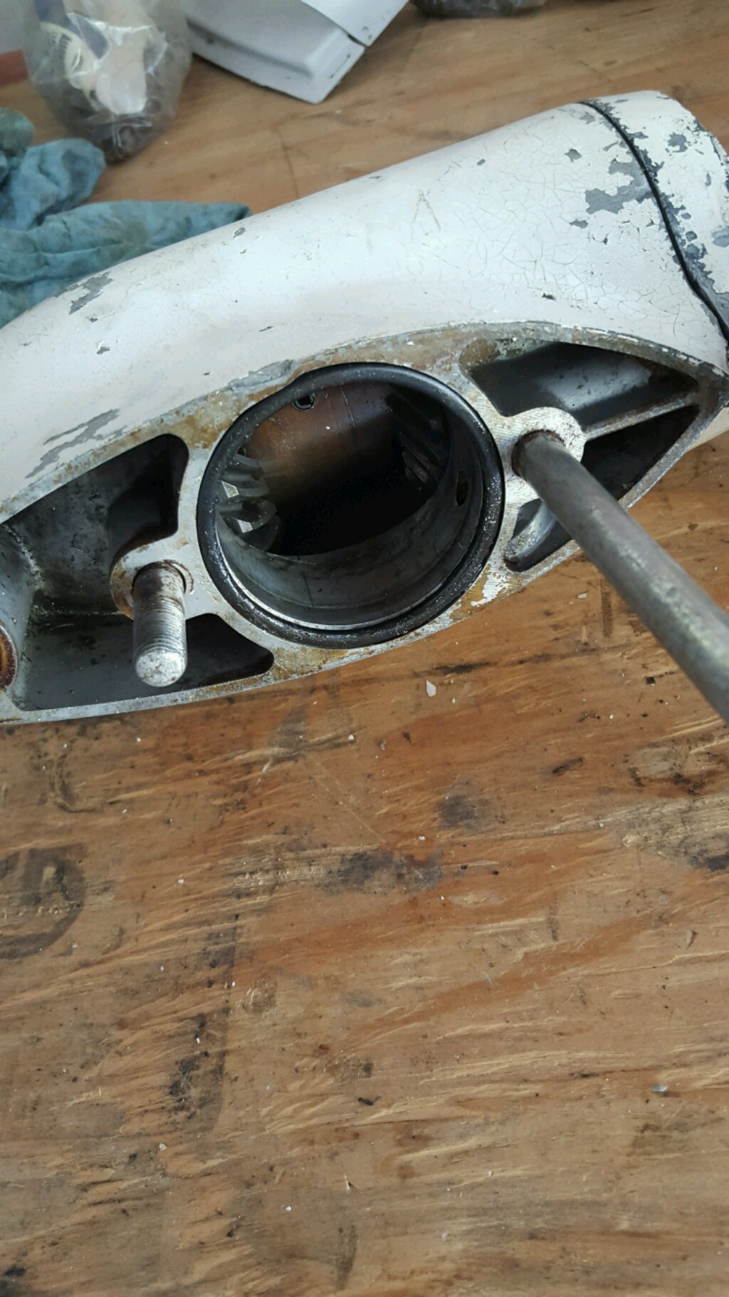

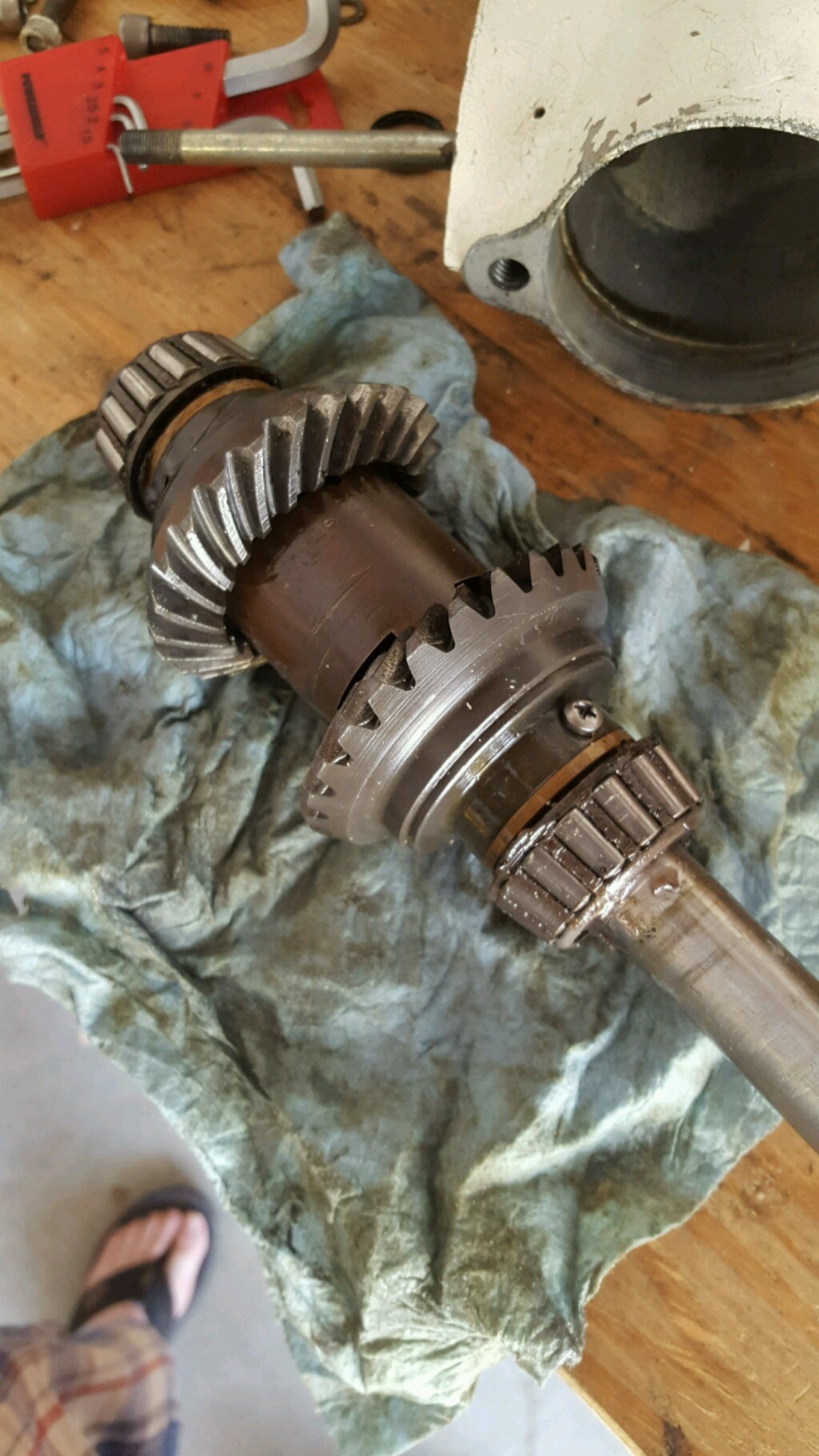

Hi everyone,
On my 75hp scott motor I can't seem to get my lower unit to fully meet up to the housing above it. When I attach the two, the bearing cap on the shaft is holding it up about 1/16". I have the gears and the shaft cap on it. I can tighten the two pieces but afterwards I can't turn either the shaft or the gears. Any idea why?
Thanks
Tyson

Re:75hp flying scott lower unit 11 years 5 months ago #111482
It appears the bearing is not all the way down touching the pinion gear
Re:75hp flying scott lower unit 11 years 5 months ago #111483
Yeah I noticed that too, and the width is about the same, but the pinion won't go on any more. Can I tap the bearing down a little or will I bust it?
Re:75hp flying scott lower unit 11 years 5 months ago #111495
Tap down the bearing. hit only on the portion of bearing next to the drive shaft. It should bottom out on pinion gear
Re:75hp flying scott lower unit 11 years 5 months ago #111508
Well I tapped down on (what I guess is a bushing inside the bearing?) With no luck, then I put it in the housing and tapped up with no luck. I can't tell if it moved at all. It seems like the gaps are smaller but I can't tell.
Re:75hp flying scott lower unit 11 years 5 months ago #111531
Is the race for the pinion bearing going down into lower housing enough? The bearing probably would not move if every thing was free when the lower unit was taken apart. Is the bushing on the bearing making contact with the pinion gear?
Re:75hp flying scott lower unit 11 years 4 months ago #111903
You were right, the bearing and the bushing were not down far enough on the shaft. It took a strong punch on it to get it to slide down that 1/16 of an inch but now it went back together.
