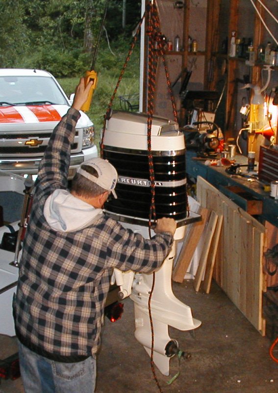

use the lower rail on the bottom cowl. make a rope from the 2 rear corners and a similar loop from the front i use a a screw driver in the hole for the steering. lift from these 2 in the center of the top. no need to remove the rewind.

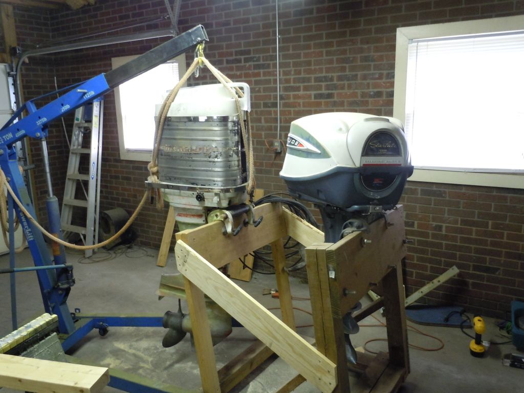

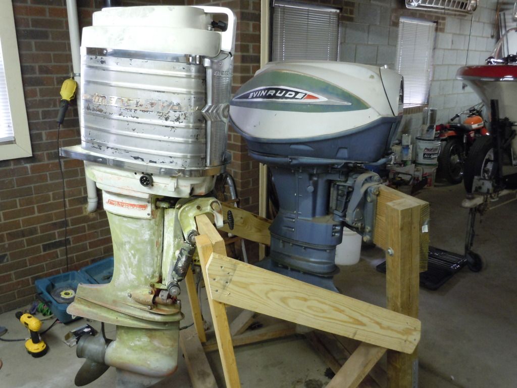

Worked like a charm, Dave. I just needed to get it on a stand and out of my way for now, but later when I get to working on it,I'm going to get a lift ring for lifting and pulling the flywheel like Bill suggested. Here's a couple pics. I just decided to have a motor stand built for two.Please forgive my blasphemy . :laugh:

I've used both methods.
I installed my motor using ropes around the lower rail as you used, worked fine... this '63 (and earlier) motor has a solid connection to the mid-section. Later year Mercs have a floating cowl assembly so you dont want to do this to them (i think '65 on?).
