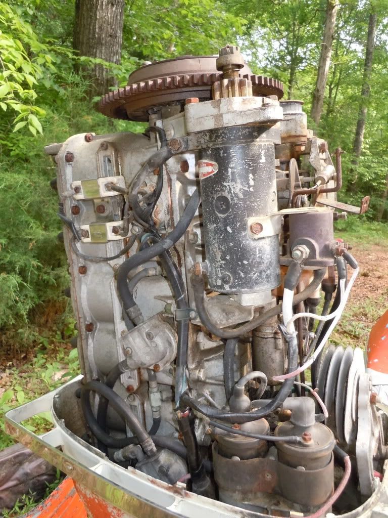

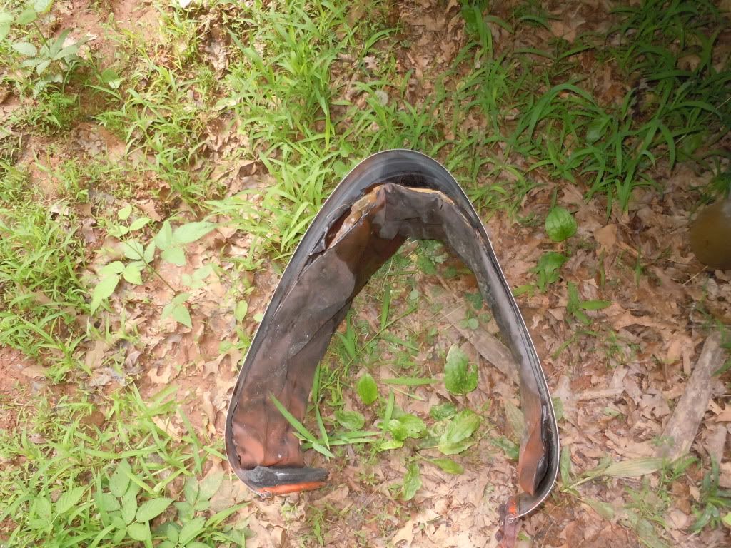

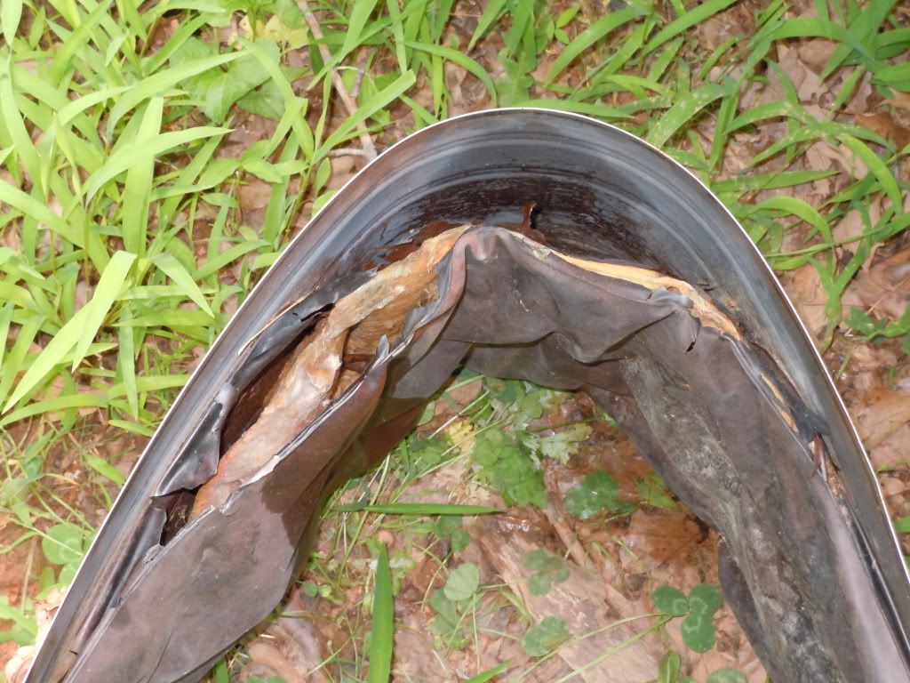

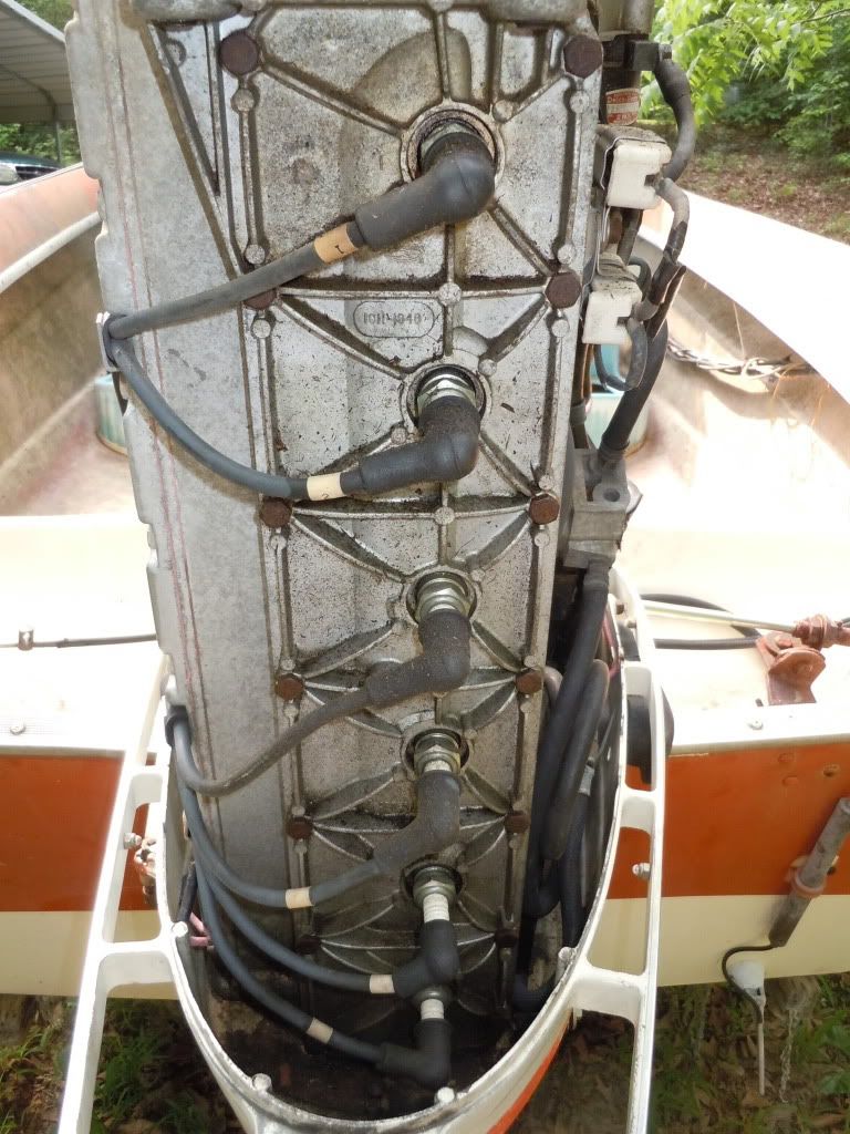

Jim,as far as the charging system' I don't see one. So you tell me,I could be missing something on this. You asked me the other day about the cowl insulation being melted from overheating so here's some more.. Why are some people so stupid as to leave an engine outside with the cowl off for a long time? dumb arses
Re:A couple of questions on a '62 850 14 years 1 month ago #60402
yes it has a charging system on it. round rectifyer in the front and the stster under the flywheel tith the green covered wires coming down the side to the rectifyer.
