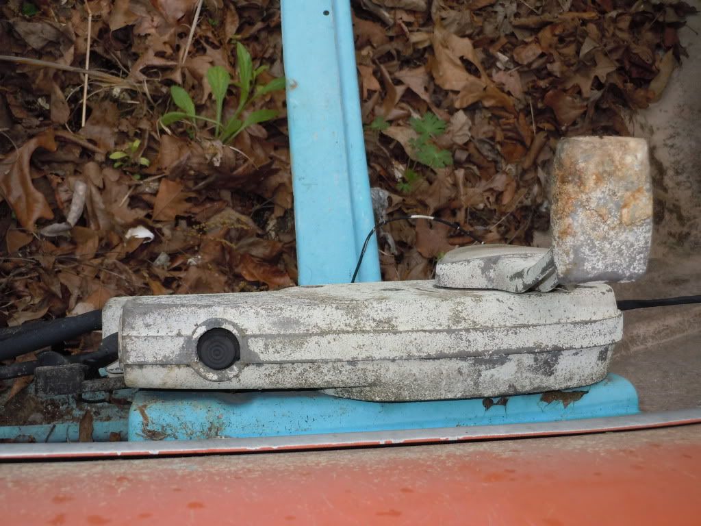

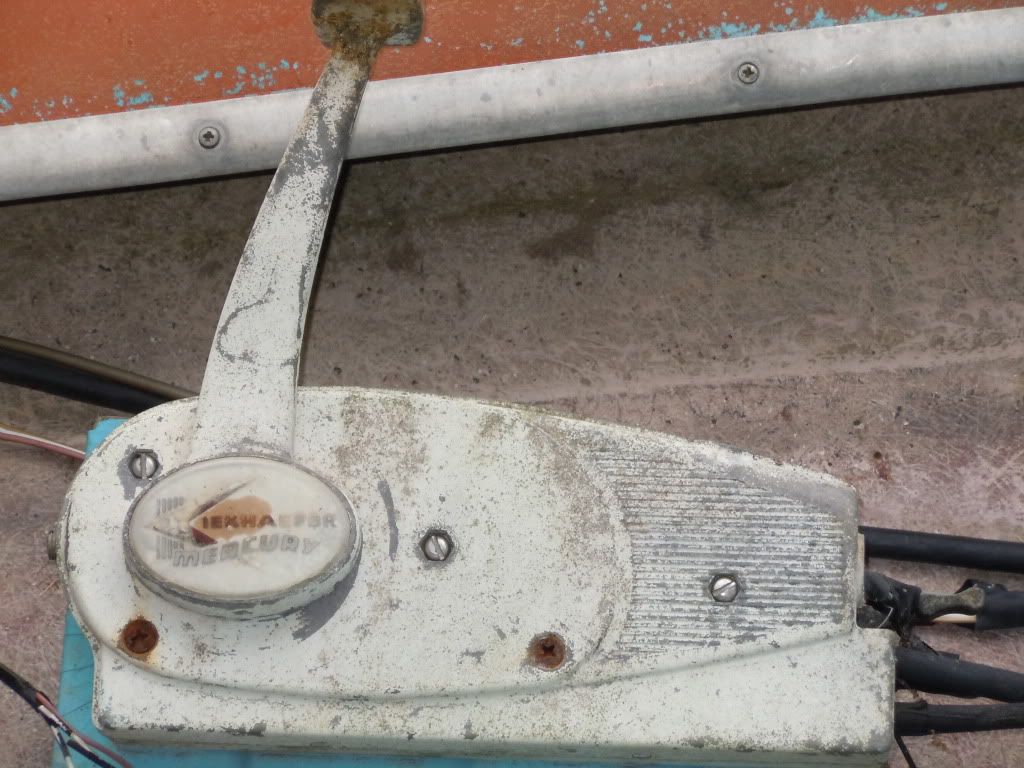

A '63 850-6 would be a Full Gear Shift (FGS) model. It should have a "tin" sheet metal wraparound under the lower cowling, fastened by 2 panhead screws each side at the front.
You'll note (2) arms sticking out the Port side of the lower cowl, those are for shift and throttle.
The shift arm goes all the way back for Fwd; Reverse is all the way forward, with Neutral somewhere in between.
Your single-lever control should have a shift and throttle cable, an easy way to tell them apart is to raise the fast idle lever and watch which cable moves.
The control cables have threaded ferrules so you can properly adjust the cables; on the throttle cable adjust so there's a bit of tension pushing the distributor against the "idle stop" screw, at the front of the dist. Adjust the shift cable so it'll consistantly shift from Fwd-Neutral-Reverse then back to Neutral without any 'clicking' in Neutral from the lower unit gears being partially engaged.
Note you can shift without running the motor but you'll need to rotate the prop a bit for Reverse, otherwise the Reverse clutch dogs may bind.
Mix is 50:1, plugs are J4C, points gap .008"-.010" but the dual-point dist really needs to be set up to the proper dwell to make things right. If you get into it that far, we can help you along, it's not like a JohnRude!!!! ;)
Count on changing the impeller before you run it on a boat, these are not as forgiving as most OMC impellers; the short blades take a set then don't pump well if at all. Impellers are inexpensive and dropping the lower unit is pretty straightforward (no pesky shift couplers to mess with!).
Welcome to the "Dark Side" & have fun with your "new" Tower of Power!....ed
p.s. post a pic or 2 when you get the chance!

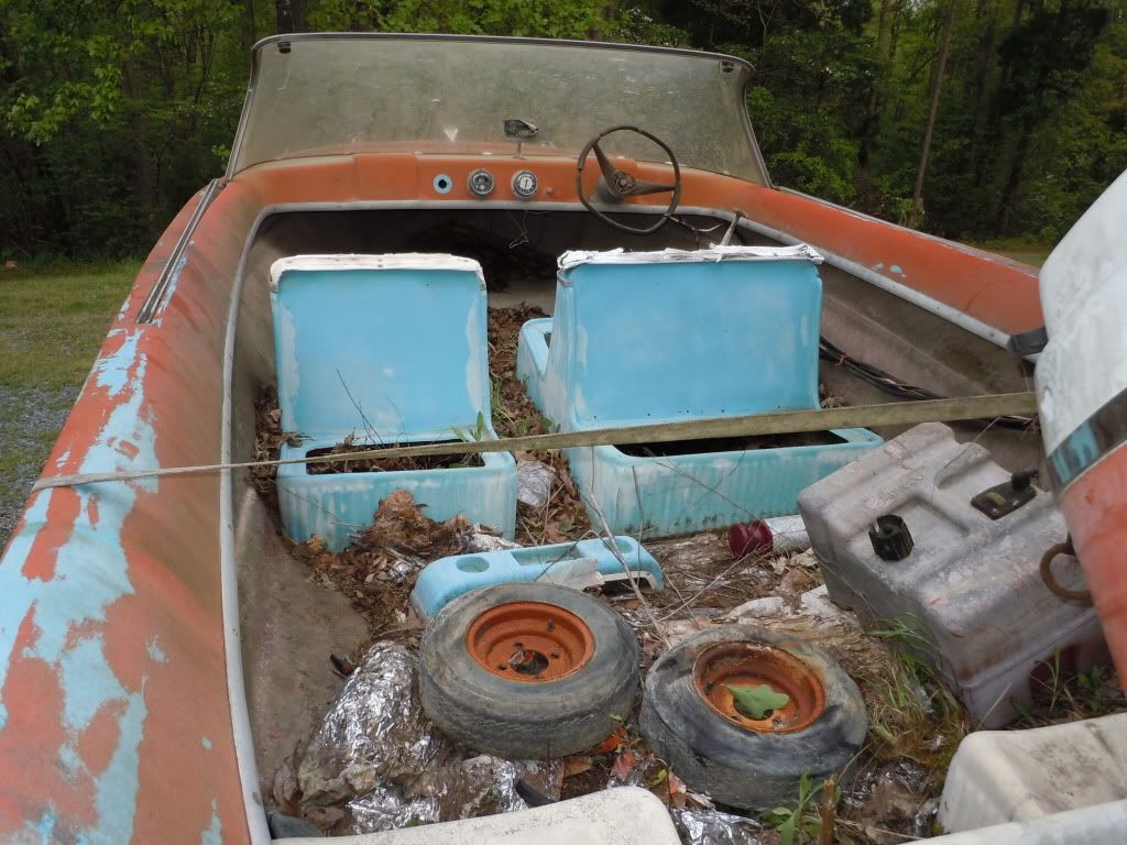

It's a friend of mines. He just bought it. It's on a 61 aristocraft still on the original Wesco trailer. She's been neglected (outside), but I think the motor could run again cause I got it to turn just a little.I really like the look of the "albino Mercs". I'm gonna see about trying to talk him out of it. Boat needs a transom and complete redo.Some genius shot red primer on the blue & white boat and motor,but the trailer is in decent shape. I'll try to get some pics.jim

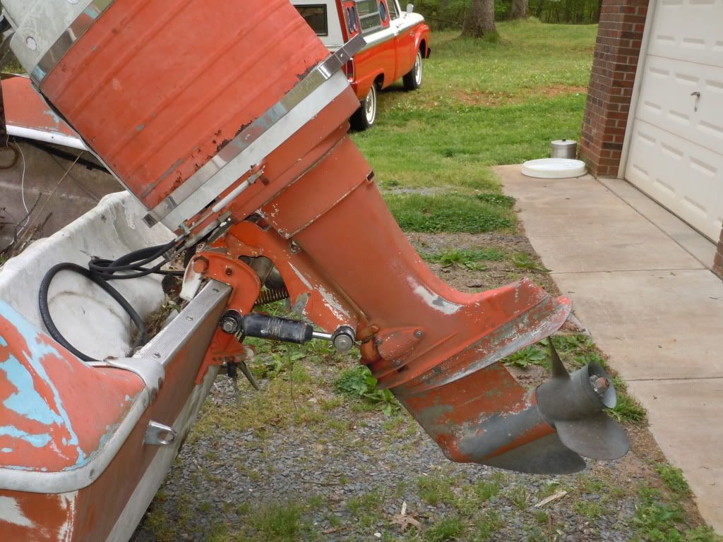

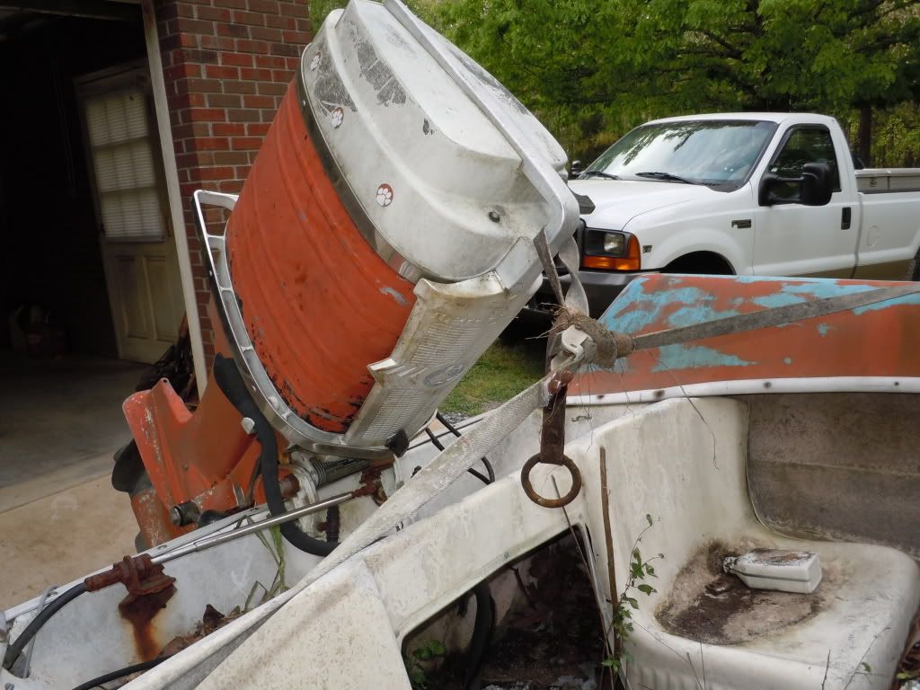

I brought the boat to my house this afternoon to check compression and clean out the forest and dump in the floor. The compression from top to bottom reads 110#,110#110# 100#,95#,95# with oil added to the cylinders and being pulled with the pull rope. Plugs were still oily when first taken out.Wiring is in bad shape.LU shifts as explained here,(thanks ed). Some pics

I'd say 110-120 would be pretty good for one of these old beasts. Pretty hard to tell, though, pulling it over with the recoil starter. Maybe you were getting tired on the bottom three!
The most accurate test would be with the electric starter. Be sure to open the throttle butterflies fully.
Most important is to have even compression readings or less than 5 psi difference between; usually if there's than 10 psi difference between cylinders it's indicating internal issues. The values you got with the rope are certainly good enough to try running it, maybe you can clean the haze off the points, hotwire 'er and get 'er crankin'!
Once running and warmed up, do a Seafoam carbon-cleaning treatment then check compression again. I'd wager the readings will improve.
Just gotta do something about that orange paint, makin' me queasy!!! :S
Cheers..........ed
