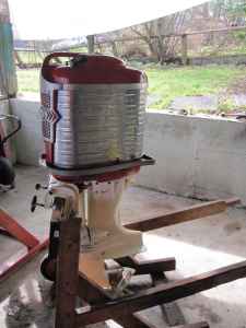

I fire up the Merc 600 for the first time since 1970 and she ran very good.I would like to use this engine on the U-2 but it is a long shaft and the u-2 is a short transom.1-i can raise the transom but that might not look as good but it is to do.2-it is possible to take the lower unit from the Merc78/75? and put it on the merc 600.i also try to fire up the merc 78 but the controll didn,t work so i use the controll from the 600 and it work but the start only spin and it did,nt catch the flywheel i don,t know why.The bad new is later my motor and stand all tip over and broke the facew plate,screw that hold the top cover on,broke the tighten clam.because as you can see my stand is not that long in the front. www.fiberglassics.com/media/kunena/attachments/legacy/images/pic_on_vacation_252.JPG [/img]

okay,i will not start it anymore and built a better stand before i do i more damage.
