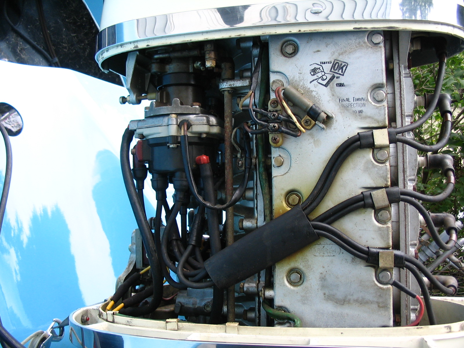

Re:Mercury switch, where does it go? 15 years 7 months ago #29070
heres it is on my 62-700. ron

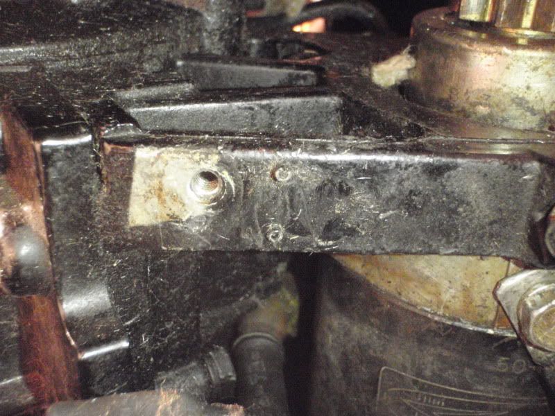

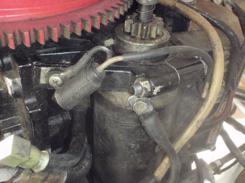

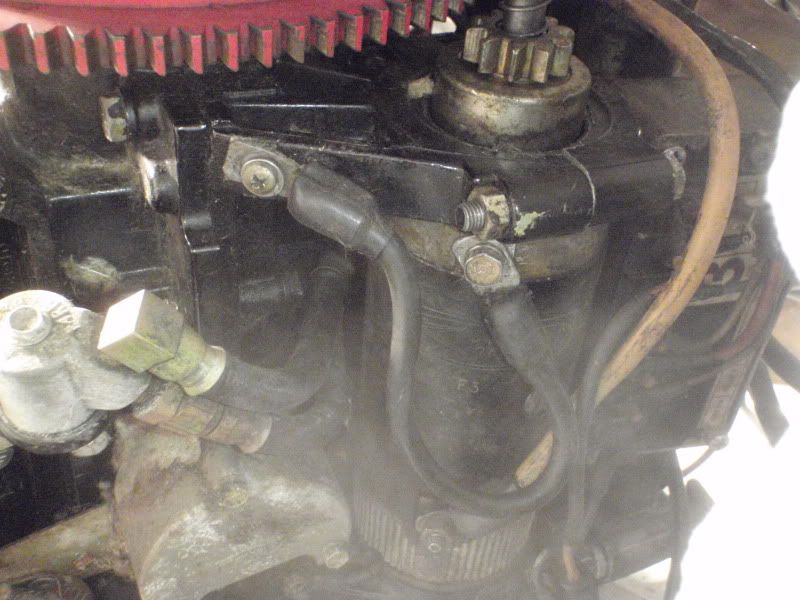

Answer is that the switch belongs on the starboard side just aft of the starter on the upper bracket. Why did I not see this before? Because the PO had put the starter ground there, instead of to the lower case mount as it should be.
As it was
look what I found
As it should be :lol:
