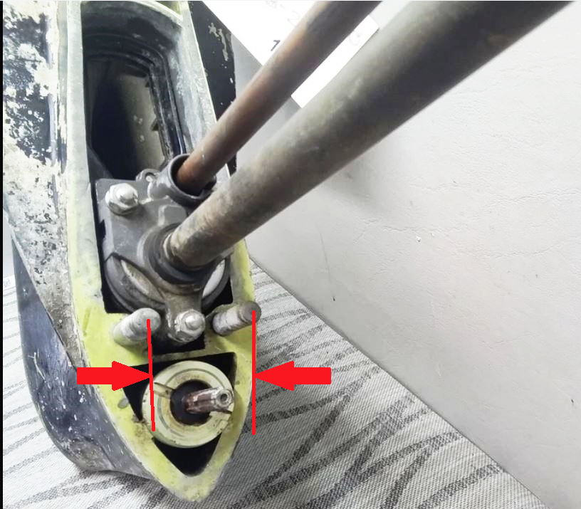

OK, so the engine with ser # beginning 18......... is a 1965 model. Your 2089974 is a 1966 model. So I'd expect it has a black cowling with silver band and black "MERCURY" letters.
The 65' thru '69 lower units should all be the same. That's starting with ser # 1744799 in 1965, and starting with ser # 2487558 for '69. You might find that similar-year 500's would also fit.
One big change that Merc did sometime in the 70's (IIRC) was to widen the distance between the 2 upper front lower unit mounting studs.
So a good thing to verify is that any lower unit you consider buying, has the same width between those 2 studs. The wider-stud gearcase won't properly fit an older exhaust tower without undesirable mods.
Attached is a pic of the top forward part of a 1968 350/500 lower unit, you're measuring the distance center-to-center between the 2 studs that stick straight out of the gearcase.
Best thing is to wait until you get the gearcase apart. If you're gonna just buy another lower unit, I'd unbolt and remove your lower unit , so you can see exactly how the driveshaft, water tube, and shift interlock cams are configured. Some of these are different from others, so you need to make sure everything about any lower unit you're gonna buy is the same.
