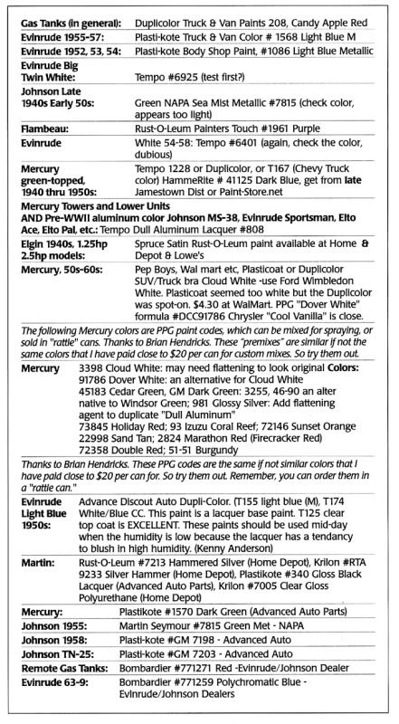

Hello
Does anyone have the paint code for cloud white so that I can get the correct shade for powder coating.
Many thanks

I prefer the 1992 Volkswagen "Cashmere White", PPG# 3398

Many thanks for the replies. I will investigate with the powder coaters.

PPG Concept #3398, also.
