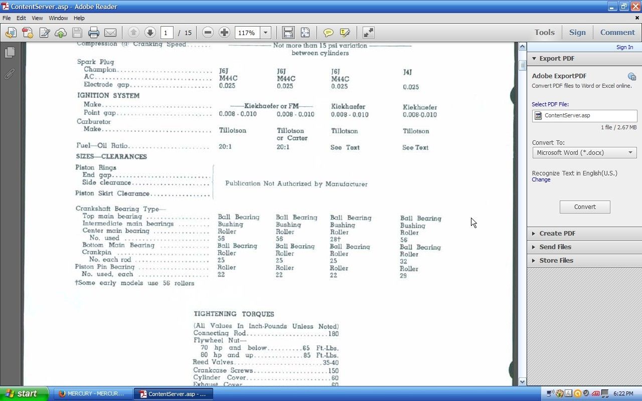

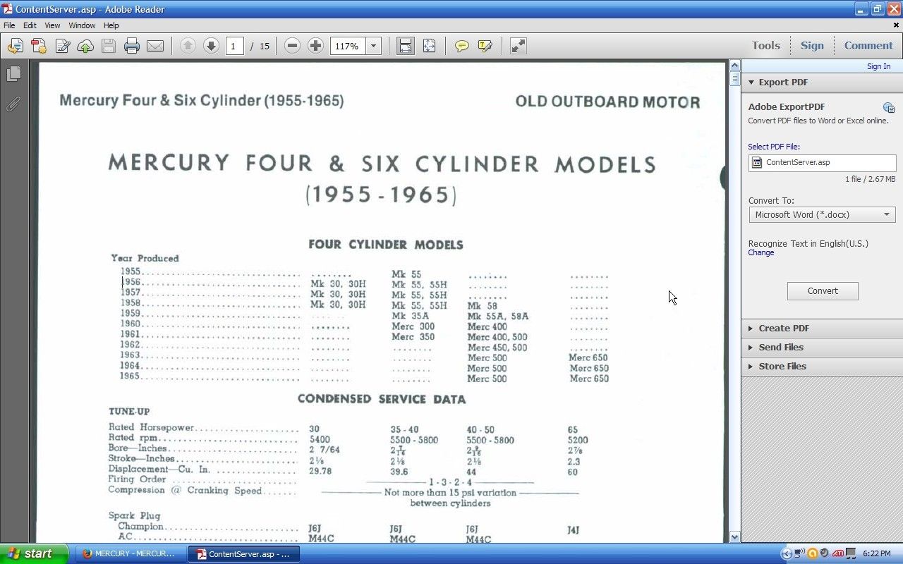

i'll take a picture of it.. but my book says .008 to .010 gap for points..for that motor just sounds a little low to me...

Re:Need Help - Merc 400 Points Gap 11 years 2 months ago #114329
hope that helps you..
Re:Need Help - Merc 400 Points Gap 11 years 2 months ago #114330
definitely is .008-.010, dwell 48 degrees. I do service on them if sent to me.
