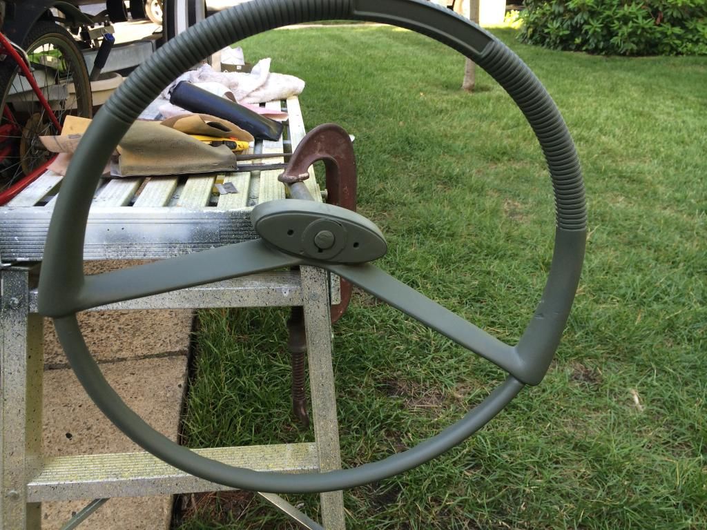

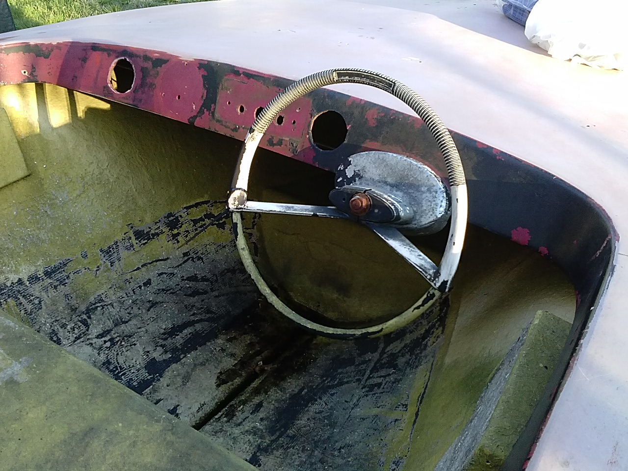

I know this was posted, it was a while ago but I'm going to do it anyway. I am getting really close to putting the etire Aristocraft in prime and wanted to show the awesome steering wheel off.
It was pretty well cracked in a couple of places, but at least its all there.
Started by digging out all the cracks to about 1/8" and filling them with a 2 part epoxy.
After a couple rounds making sure nothing recracked and everything was filled, it got primed
That's where its at right now, today is a little filler and more sanding then she gets the base coat of antique white.
-Brian

Sorry for not replying, I haven't checked this thread in a long while.
Here's an update- The wheel has been painted along with the throttle handle. I think I'm going to paint the little notches, much like Nadeem did on his wheel, only in gold...PICS!
I'm kinda pissed I couldn't make the original Attwood mount work because the chrome would look awesome, but the bump out in the dash is too narrow.
-Brian

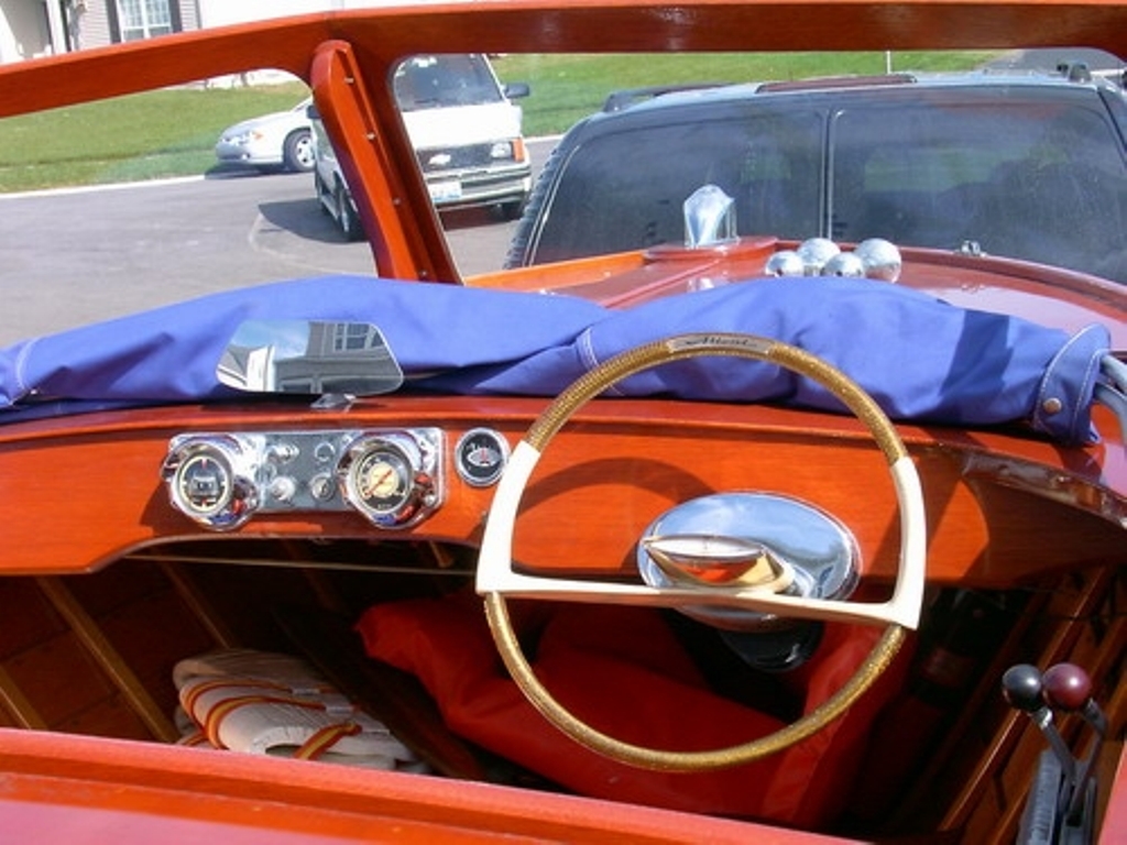

Do you know exactly what year your wheel is? Its very similar to mine but mine has a metalflake paint on it. Mine came as original equipment on a '60 Thompson so I'm guessing it is a 1960, or maybe a '59 from the dealer's stock.
Verne
Re:50s Attwood steering wheel Resto 11 years 6 months ago #108507
Verne mine is on a '60 Wagemaker and it looks just like Brian's, all white.
