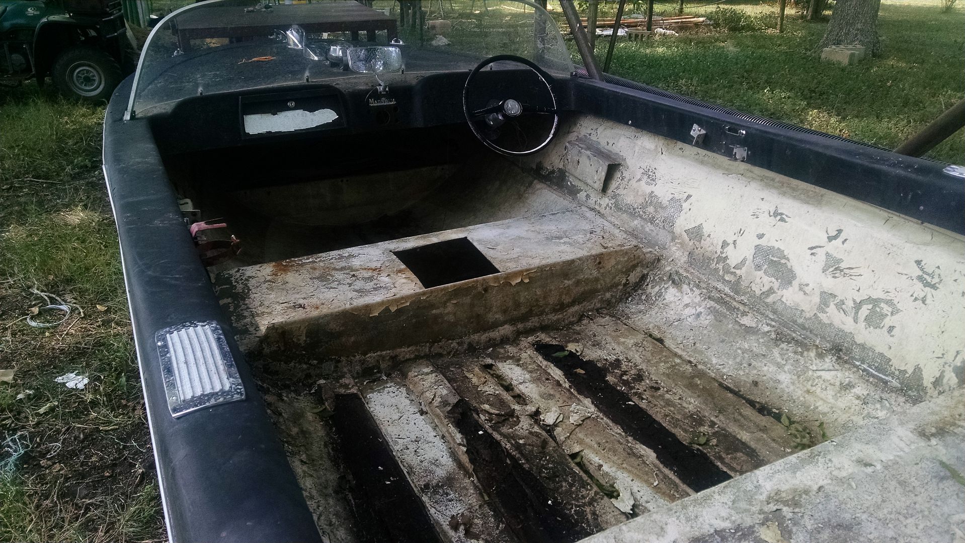

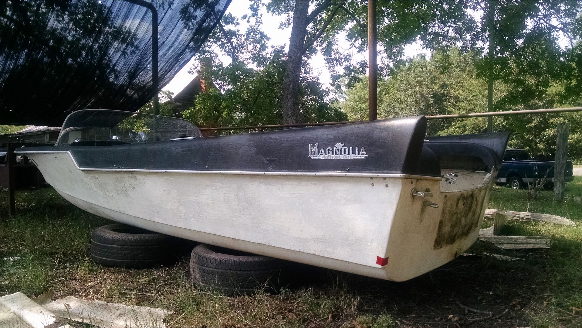

I probably paid too much for this on craigslist a few months ago but I fell in love. Im not certain on the year, or a particular model. This is my first fiberglass project and my first boat restoration. This will be a learning experience and unfortunately a budget build. Enough talking, here's the pictures.
This is definitely in worse shape than I had expected, and this project is also becoming more difficult and expensive than previously thought. But not impossible, or unaffordable. I'm not giving up.

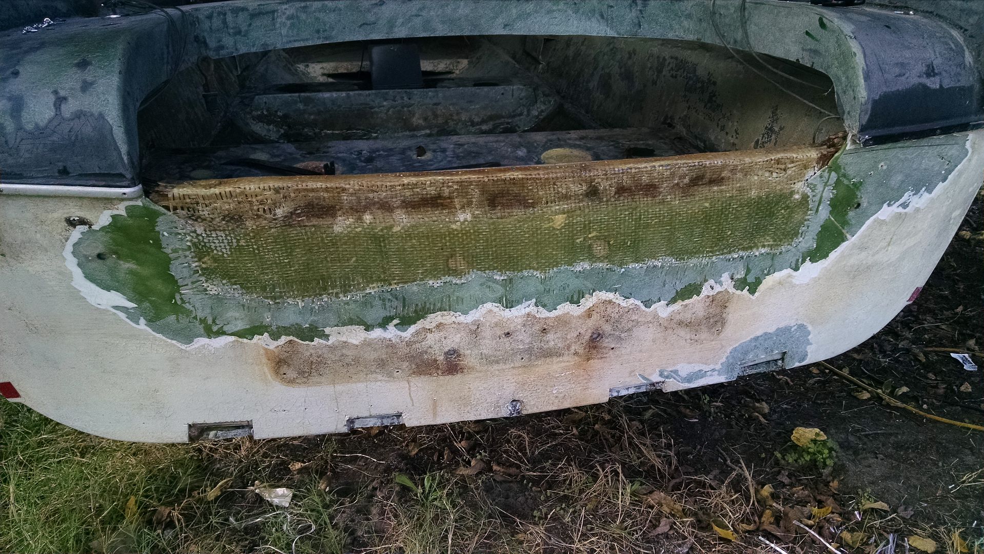

Skipped them earlier. But we worked on the transom at the same time. It was beyond shot.
Another decision that will be frowned on by the professionals, the plywood I used in the transom was rough probably BC made from hardwoods. It was not marine/cabinet grade or anything pricey. I used resin between the first layer and the original boat hull, then resin between the 2layers and glass over it when I finished

So far I've used the fibergladd jelly on small cracks to seal my runners into the seat boxes, and the "kitty hair" slimy stringy fiberglass putty to fill in bigger gaps around the new transom. I also used a trick to take apart the cloth and mix it with resin to create your own putty. I've been sandind btween coats of resin.
You can see that thick weave on the transom and the green putty around the edges
