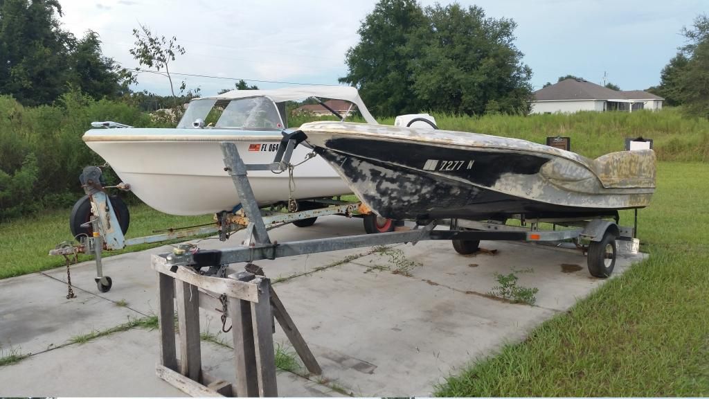

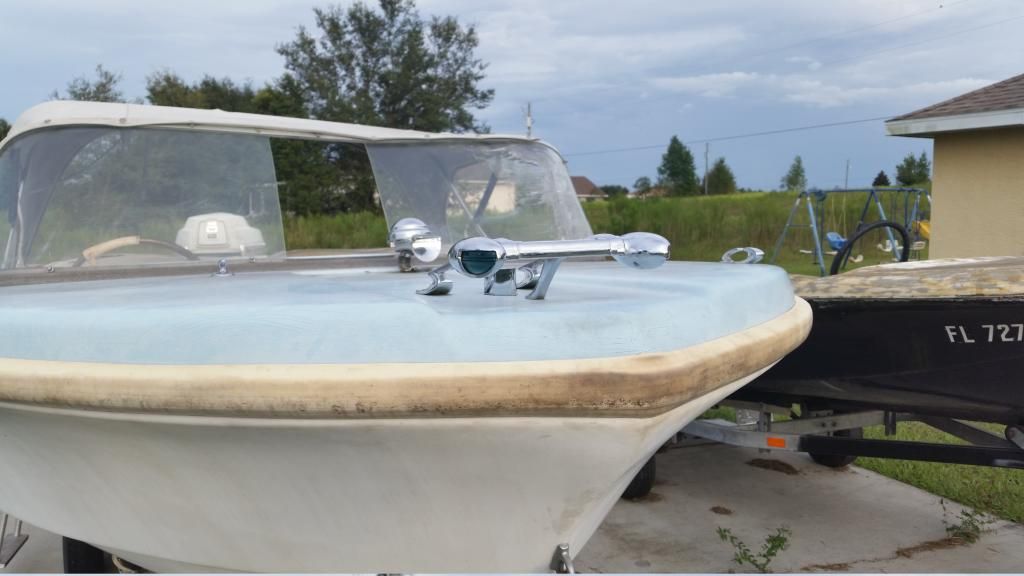

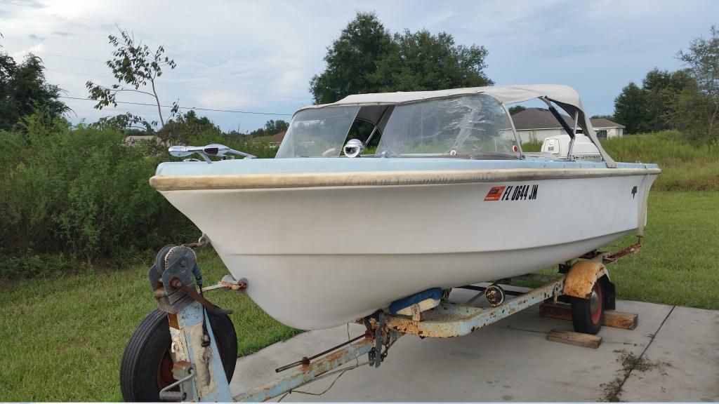

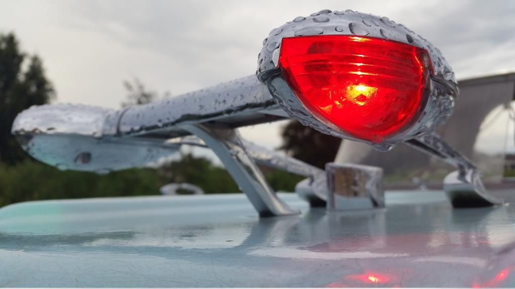

Pick up this today at a swap meet. 1961 Shell Lake. Not sure of the model so if anyone could help me with that part that would be awesome. enjoy the pic. the black boat is my CarrCraft Maverick boat im in the middle of bringing back as well. Enjoy

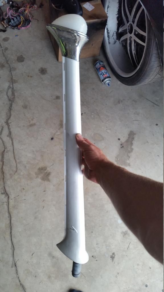

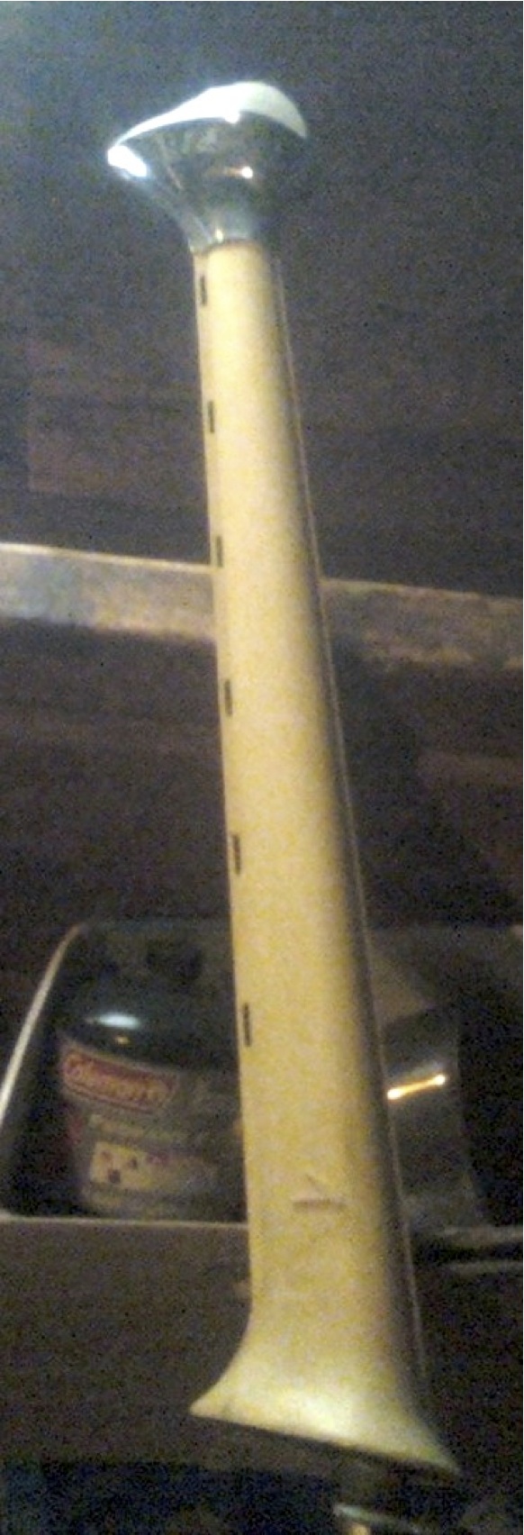

and the stern light

Robert, your bow lite does not look good on your boat. I think you should send it to me. lol :laugh: you have a neat boat and i'm glad there are more shell lake boats out there. greg

Lol. send me your address and ill ship it your way. just kidding, i love that bow light. i have the flag pole as well that sits in the hole behind the bow light. the guy forgot to give it to me when we picked her up but its in the mail on its way.

sweet im loving these old lights. only thing wrong with my stern light is the lens at the top is just about to break off. only one little piece holding it place. need to find some way to fix it.

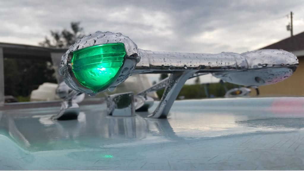

hooked up my lawn mower battery to see if the lights work and they do. took a couple pics. the stern light works as well and the horn too.
thought these where pretty cool pics

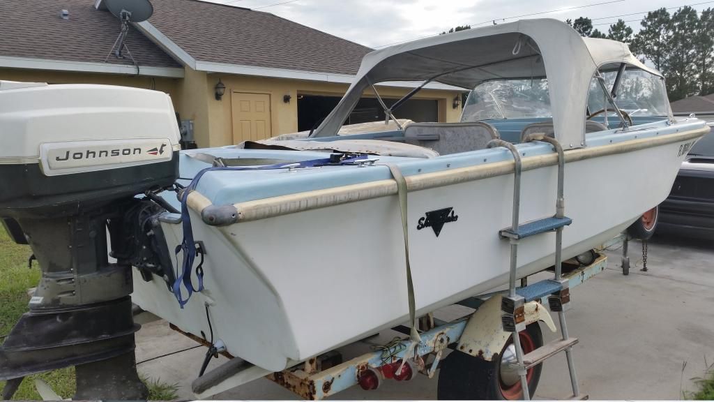

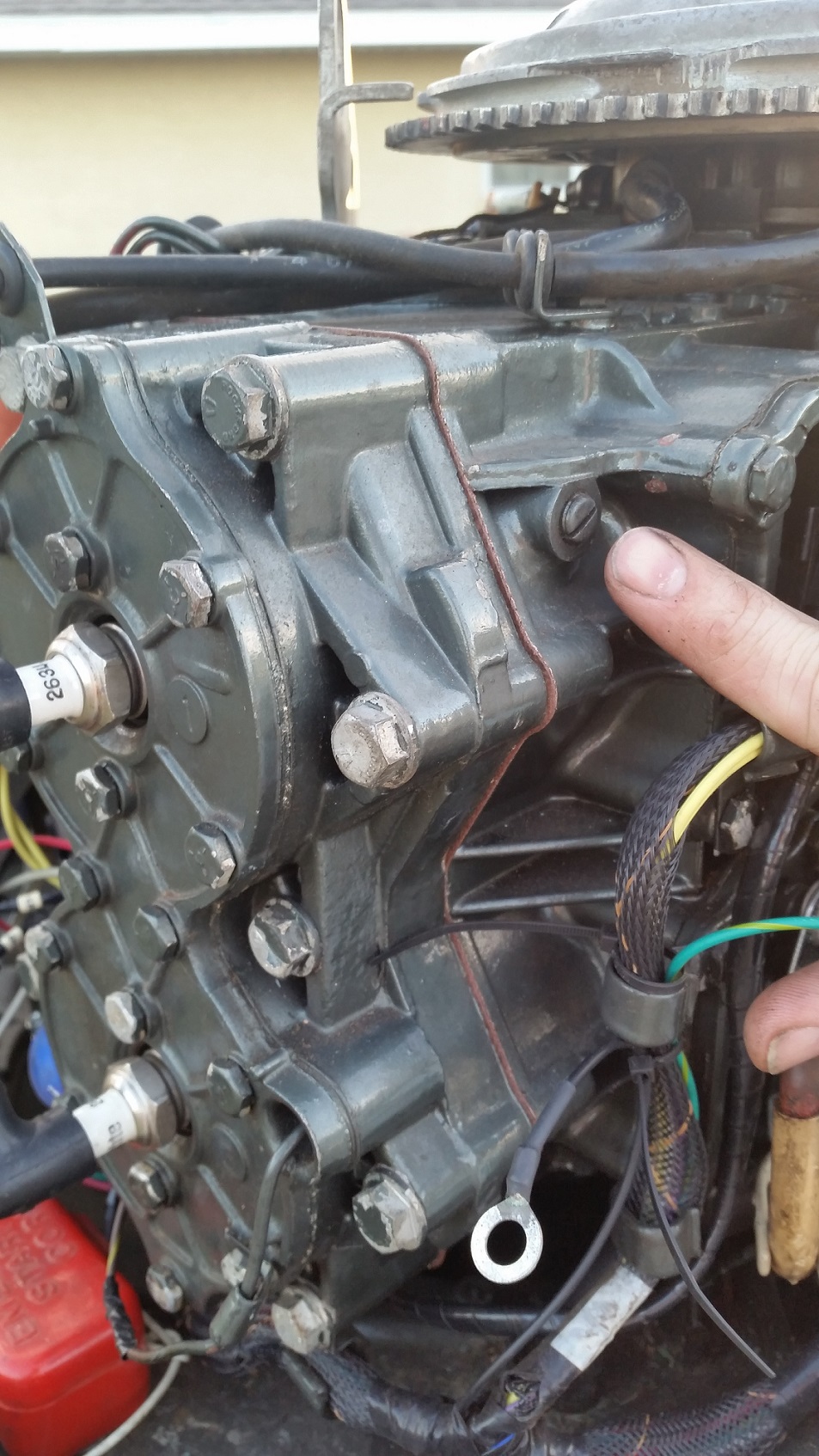

anyone know anything about these old motors. i was wondering if the plug i am pointing to in the picture opens into the water jacket of the power head. i really want to add a tell-tale to this motor. i know its pumping water as its coming out the exhaust port below the motor casing but a tell tale will make me fell sooooo much better. ive been searching but i really cant find anything about this plug. thanks in advance.
little update after the river on sunday. if ran fine but still having issues starting. weak spark if you turn the engine over for a few seconds. she likes real quick strikes of the key. but once its started it fires off every time. going to run new wires to the cdi box and see if that helps. thought i blew the motor on sunday when i was flying down the river testing. heard a loud bang like i hit a log. then went to start her and she sounded really bad. turns out the flywheel bolt was torqued down by the last owner when they replaced the distributor. didnt even think of checking that but thank god its not the motor. scared the crap out of me though. this upcoming sunday will be another test and tune day.
Re:Got a New Boat Today!!!!!!!!!! 1961 Shell Lake 11 years 7 months ago #102260
Looks like just a blank screw hole to me. Might want to go on the JEGO site. Looking at a parts breakdown it just shows a blank, no screw.
www.marineengine.com/parts/johnson-evinrude-parts.php?year=1961&hp=75&model=V4AL-13&manufacturer=Johnson§ion=Powerhead+Group
Re:Got a New Boat Today!!!!!!!!!! 1961 Shell Lake 11 years 7 months ago #102265
its a 68. in this one it says its a plug. guess i could always see if i can get it out and take a look to see whats inside.
www.marineengine.com/parts/johnson-evinrude-parts.php?year=1968&hp=100&model=V4TL-14B&manufacturer=Johnson§ion=Powerhead+Group
Re:Got a New Boat Today!!!!!!!!!! 1961 Shell Lake 11 years 7 months ago #102310
took the plug out today and it goes right into the water jacket so i will installing a tell-tale here in a couple days. hopefully it works well, we will see.
