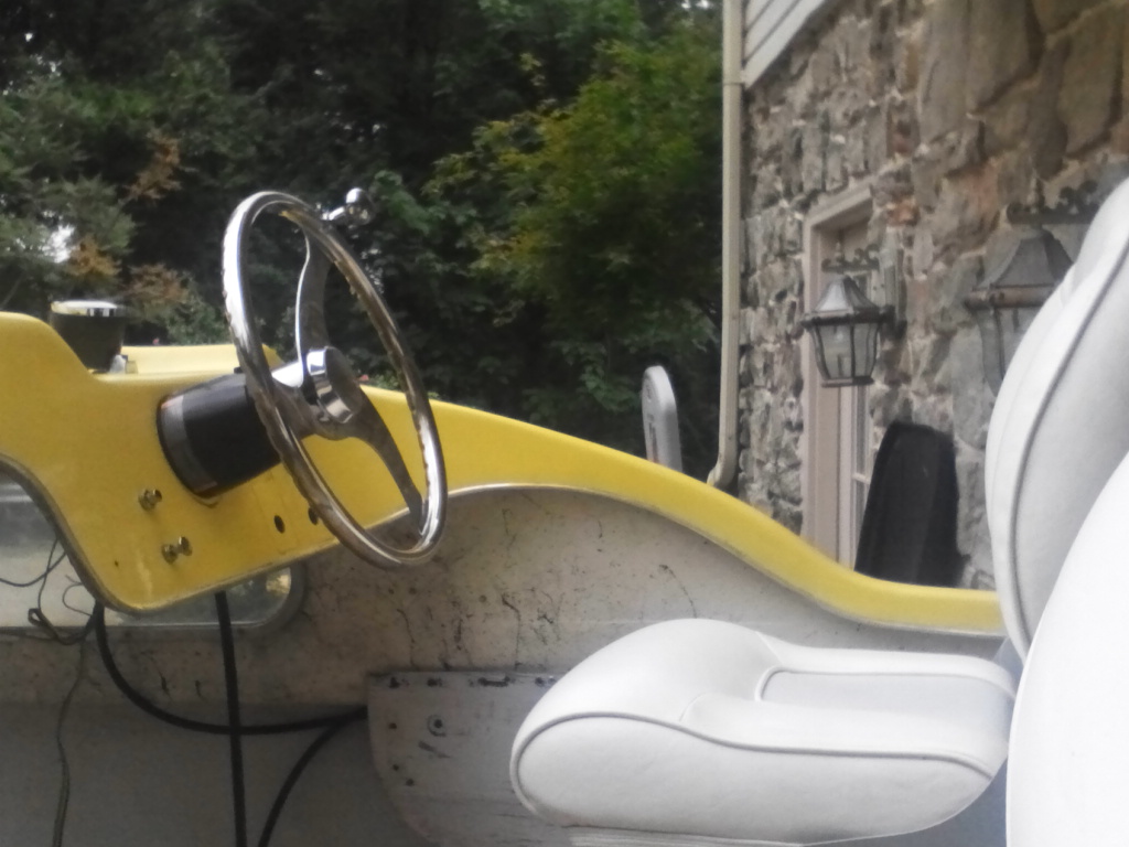

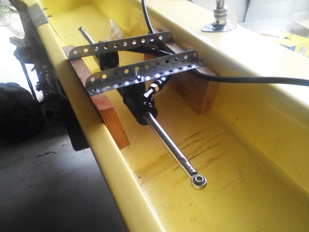

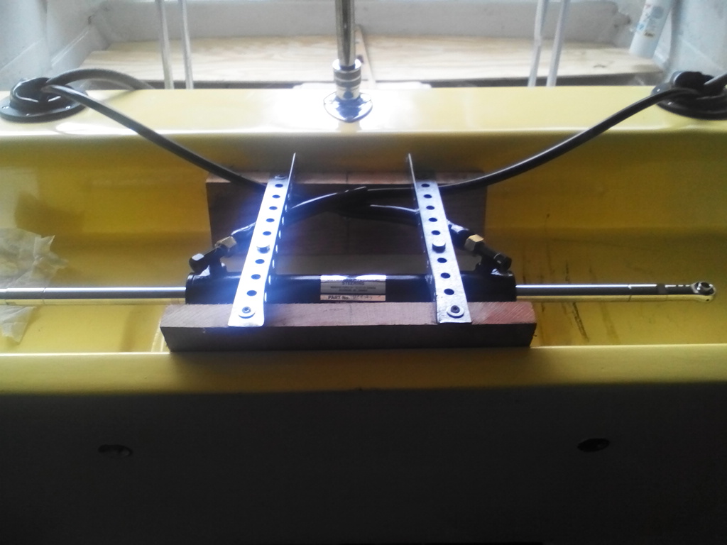

Have the helm, lines, and cylinder installed. Bled the lines and it moves smooth as butter.
Don't judge the ugly brackets. They are on there temp so i could bleed it and make sure it's all working before i take her to have the motors rigged.
I'm going to build a cover over the area that we can use for a step when getting in and out over the transom.

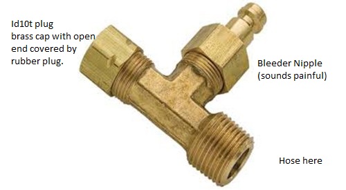

Does anyone have a seastar setup? There is a rubber plug at the end of the "T" opposite the line input. This rubber plug popped out while under extreme pressure. By extreme i mean i was cranking the wheel hard against the stop. Also happened when i had the wife cranking the wheel as i held the steel shaft to bleed air.

Figured out why that pops out...
Anyone curious?
Dan
68 MFG Chevron
61 Power Cat 18DC Tahitian

ok, i'll bite . why does it pop out? frog

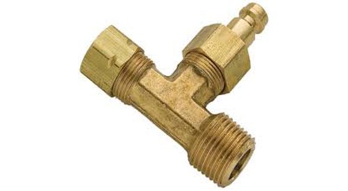

It's an Id10t plug...
I took the bleeder valve off the "T" instead of the plug. The instructions didn't show which end was the bleeder valve. There is a thunderstorm out now, so i'm not going to take a pic. But i downloaded one from the web. I took off that nipple, and kept the cap on.
Didn't realize it until i watched a video on how to bleed the system.
Live and learn.
Dan
