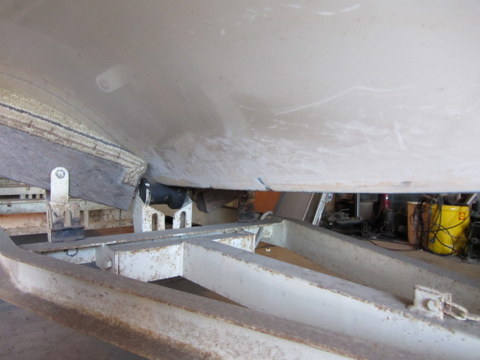

Here are some pictures of a boat I am considering. Transom and floor seemed beyond solid. The top deck was in great shape as well. Shows fine scratches from years of use and being wiped down with towels and such, but is still shiny and may be able to be buffed out. Sides show lots of rub marks from hitting docks, but they too still have a lot of shine.
There is some work along the keel though that does look like it was patched and doesn't have any of the shine. It looks like it would need to be redone.
Do you think the entire hull would need to be repainted, or just spot treatment where the patch is?
It would be nice to get something and not have to spend a fortune on it. It does need new upholstery and the trailer is a mess. Boat looks solid and always garaged. Hasn't been in the water for 20 years.

Welcome aboard David. It doesn't look like the hull is in that bad of shape, I'd be inclined to either attempt a gel coat repair or have it done. As you mentioned the deck is in a "that'll buff out" condition, try to keep it original if you can. Gel coat lasts longer than paint, and is more durable if properly cared for.
Painting is an option if the current surface is beyond rejuvenation, myself and many others here have gone that route out of necessity. Done properly it can be just as appealing as gel coat, some of the gang has done an awesome job on theirs!
Just my two cents, share some pics of the entire boat when you get a chance. Either way you go, we have numerous members here who will be glad to lend a hand with advise if you need it.

Welcome aboard David. I'm with Mark, I would try and do the gelcoat route since it's only that section. If you try and repair it with epoxy you'll HAVE to paint as gelcoat won't stick to epoxy.
