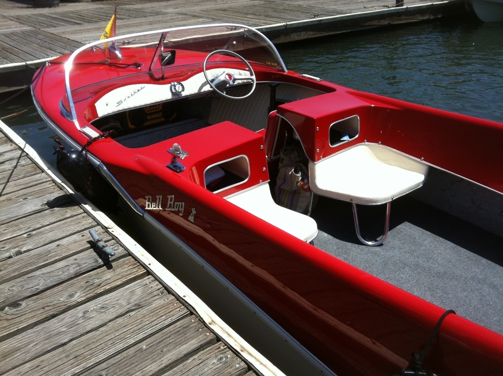

That's a nice looking Bahshee - how about some more pictures. Have any "before" pics?
As to the windshield frame - this exact question comes up from time to time.
Unless you can find someone with the exact frame you need, it is more than likely you will need to re fit an appropriate frame from another boat. The part can be from any maker, model, or year - providing that it has the approximate profile shape needed. Many builders sourced their parts and extrusions from the same sources. It is possible to find a junker boat that can be parted out - and sometimes people just sell parts off of junker boats. Also look for boat junkies that have a stash of windshield frames in the rafters of their shop. Find a frame profile that is similar to what you need. The aluminum on most frames was annealed, so it can be bent without breaking. At the least the frame needs to be longer than required. After shaping, the excess material can be cut off. Unless you can find a supplier of bull-nose extrusions - this may be your best bet.
