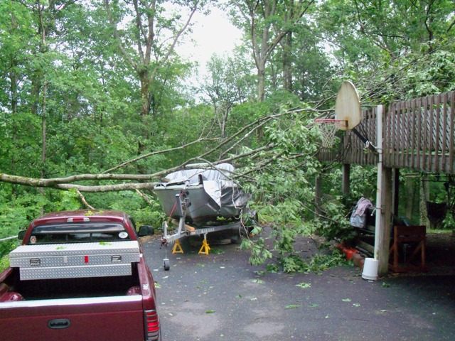

Personally I think the fiberglass in these boats will outlive all of us and our grandchildren. In Florida it is becoming a problem with what to do with all the old boats.
The only boats that come apart are severely neglected or have hit something.
I am still using this boat.
