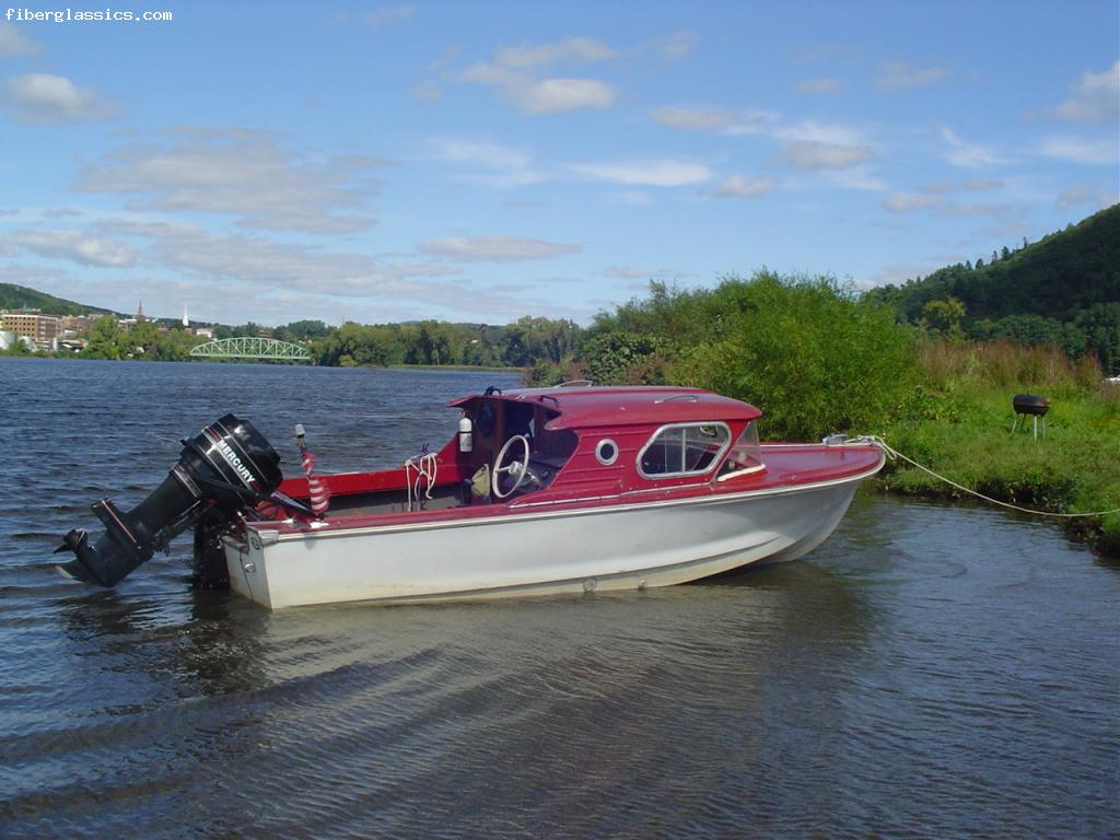

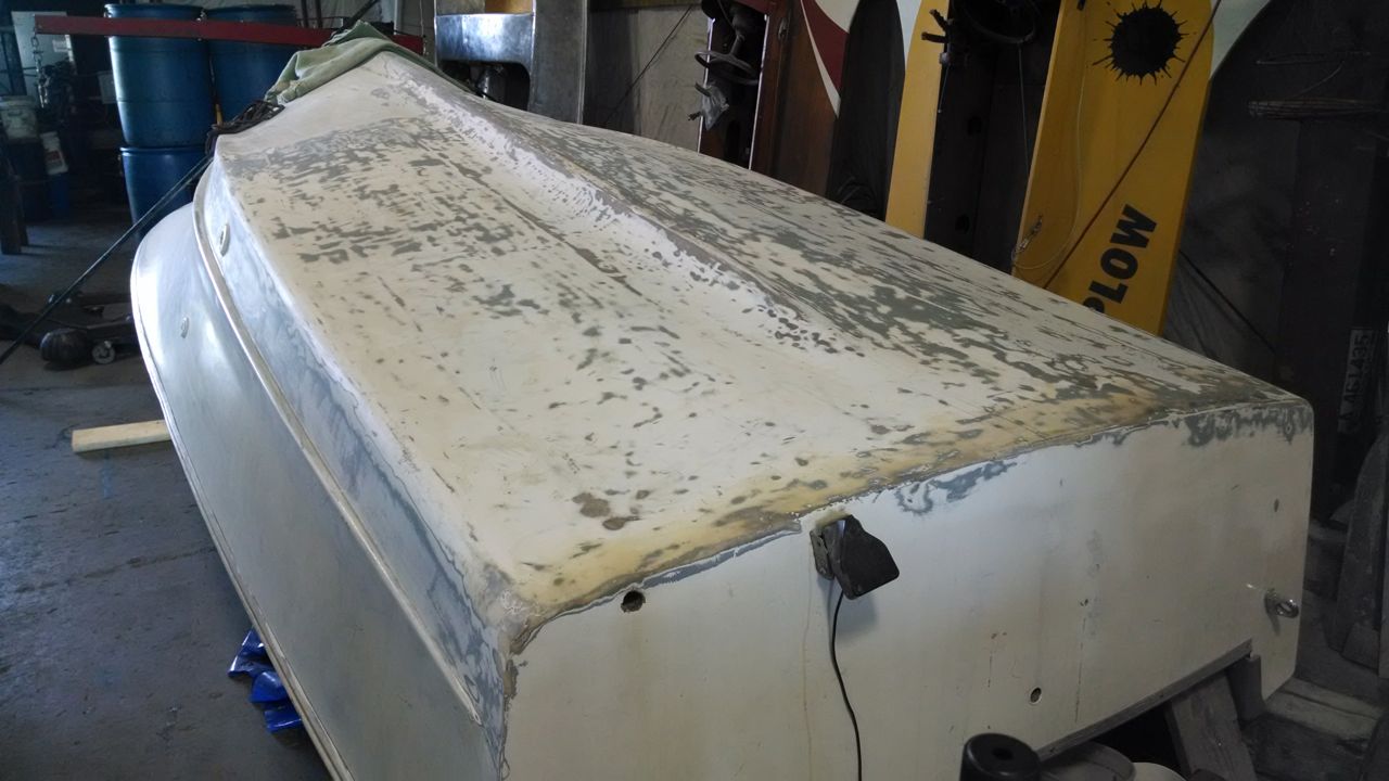

Last year, I bought this Superglas, advertised on Fiberglassics. I noticed this boat when it was for sale even before that, but I didn't have the funds, so I watched it come and go.
When it came up again, I was able to negotiate with the owner, who gave me a generous deal. Took two friends with me, drove 5 hours, arrived in the pouring rain. One of my friends immediately inspected the hull and said "It's got a hook!" Ugh. I bought it anyway….and they razzed me the whole way home. Took it out for a run, with a 45 hp Merc. Started out great, but at half throttle, the bow went down and the engine was cavitating. Tried to pretend that wasn't happening, but that didn't work.

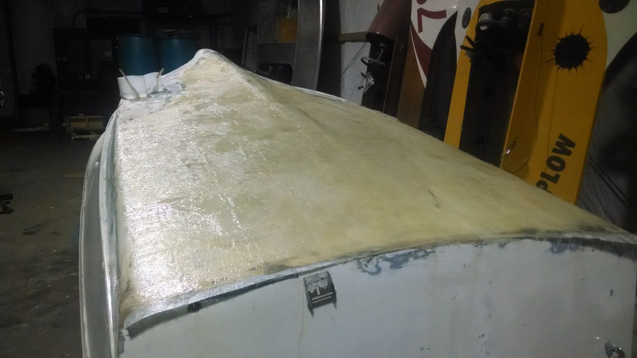

The prior owner had rebuilt the floor, but hadn't straightened the hull first. My friend suggested that we leave it, and build up from the bottom, pouring a two part foam to fill the gully and then sanding it straight.

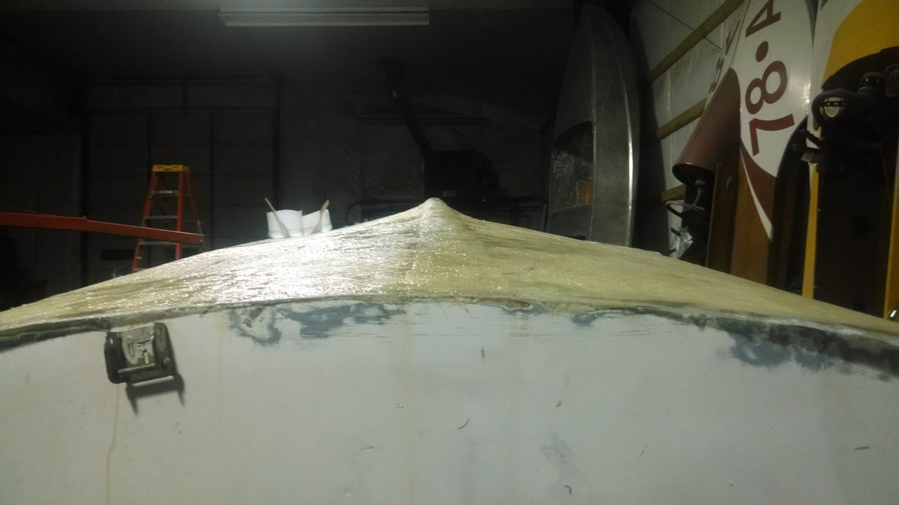

This level shows the extent of the hook:

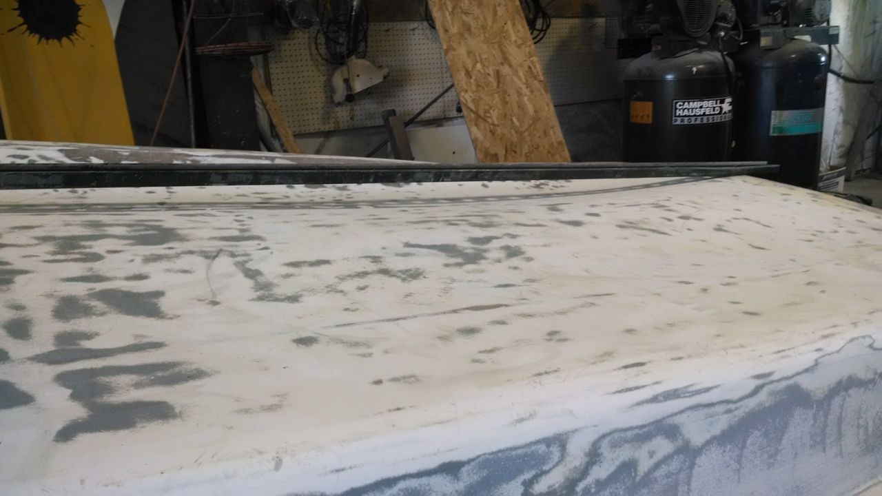

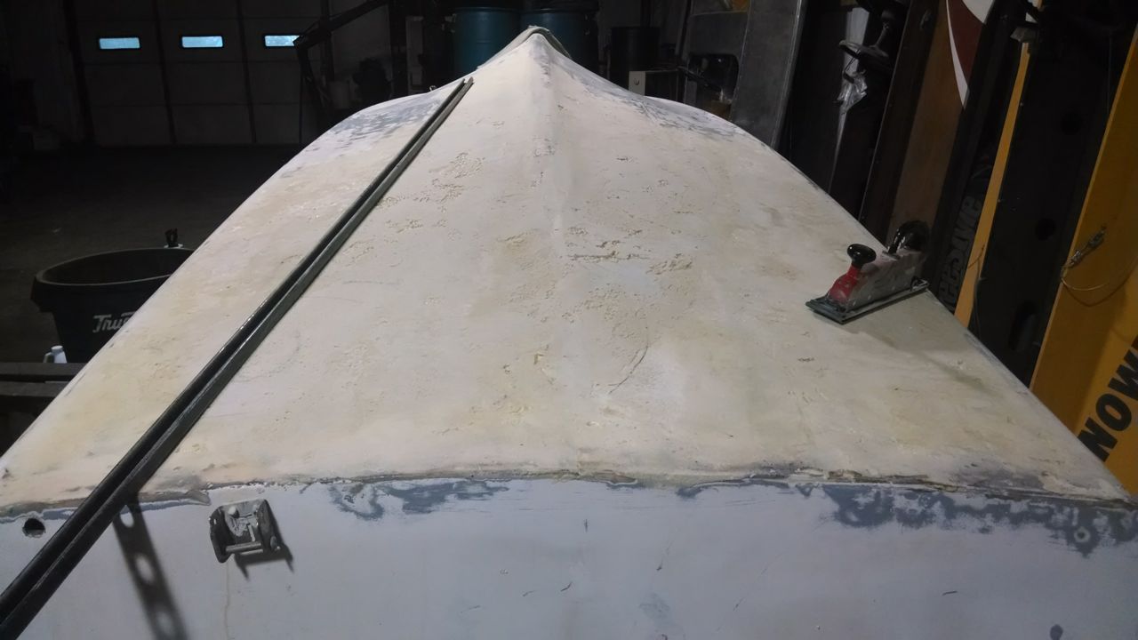

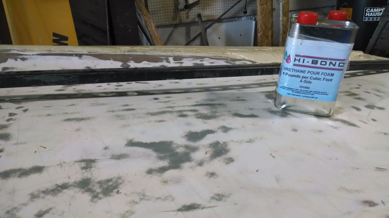

Foamed and sanded:

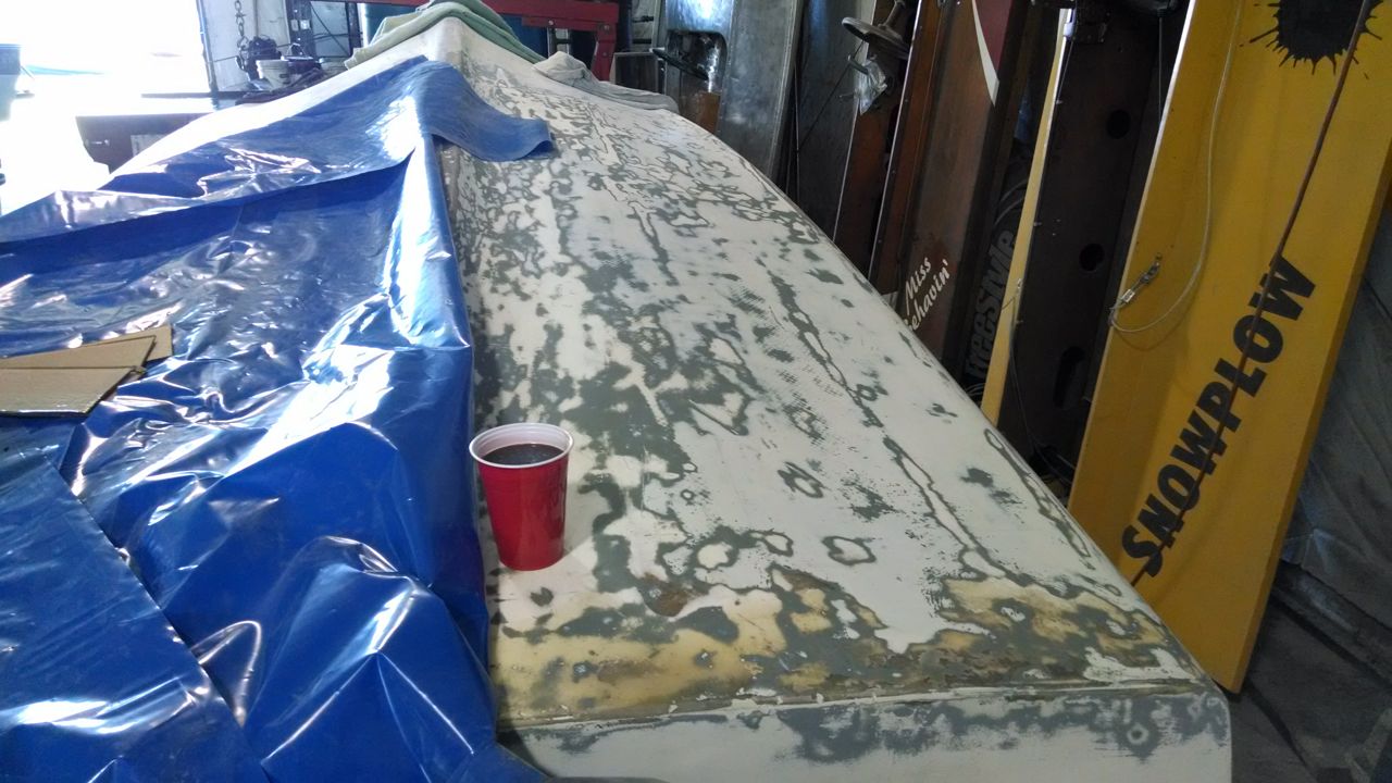

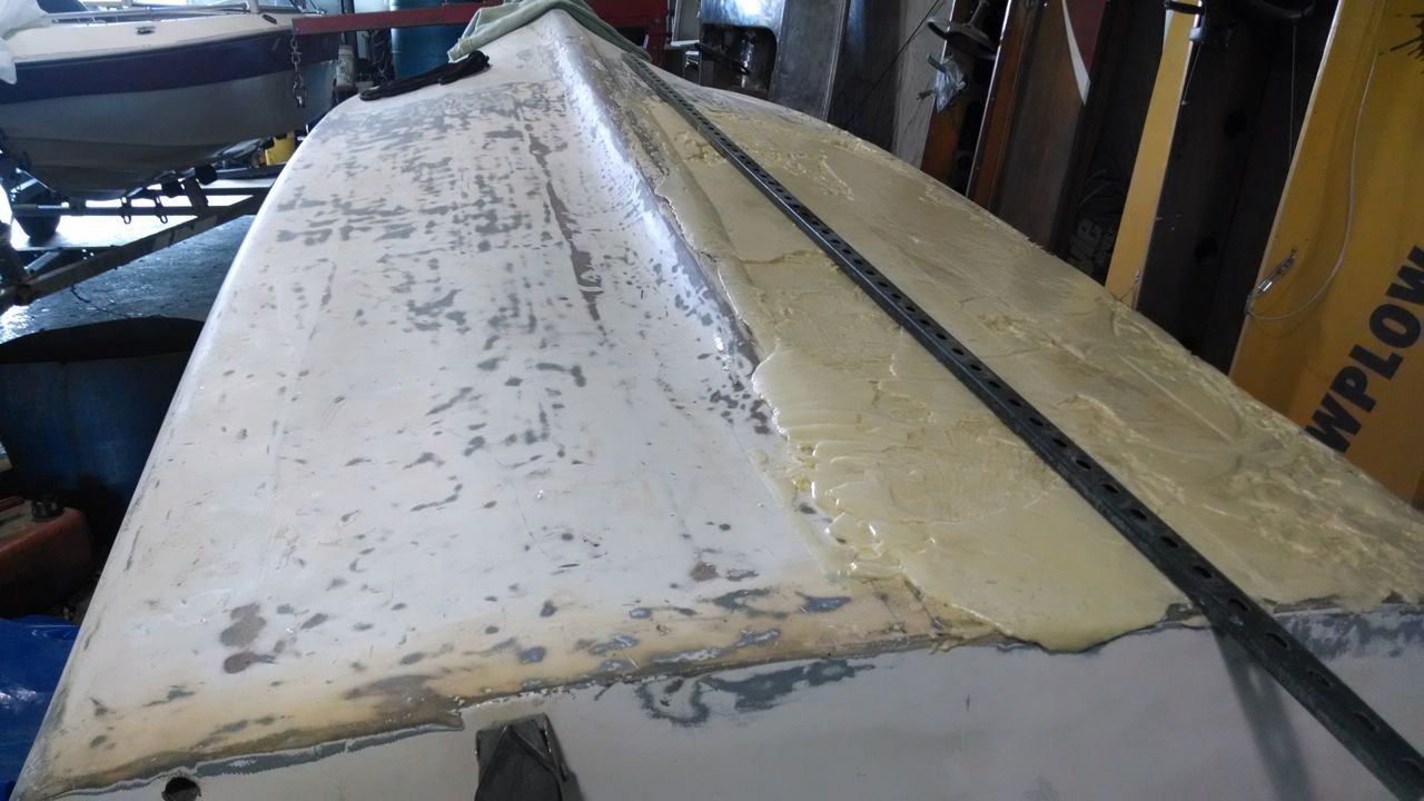

Then, we laid on mat and epoxy:
Ground down, making a crisp edge at the transom. Paint and trial run. Success!!!!
