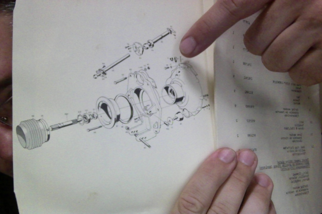

ok,we need to start over. i dug out my manuals for the BB70and and the aquamatic outdrive. the volvos i have been messing with are newer and somewhat different that the older aquamatic 100.
the breather does not open into the inside of the bellhousing but opens just above the bearing supporting the primary shaft. there is a seal on the motor side of the bearing. on the aguamatic the prop shaft runs in oil but the upper gears are pressure lubricated by an oil pump drawing from the lower housing oil. the oil then goes thru passages to lubricate the upper gearcase. there are no seals on the gear shaft coming out of the drive between the upper gearcase and the universal coupling. so,it would be possible for oil to get into that area with the motor running and the drive in the up position. the primary shaft would be spining along with the upper gearcase. all shifting is done in the upper gearcase on the aquamatic. this is the reason it is so simple to change rotation direcion on them.
