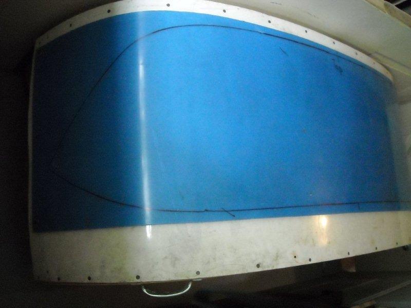

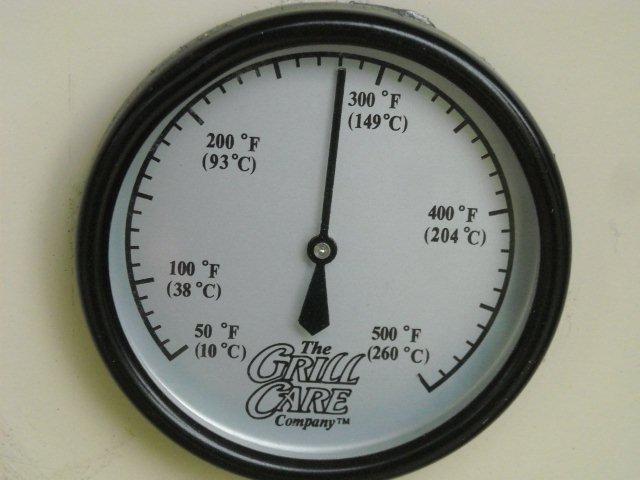

Finally finished my windshield oven. The mold is for 57-59 Larson Pla-Boy, Thunderhawk, Pla-Mate, etc. Heats right up to 270-280 degrees. I kind of have to manually regulate the heat. But it works. Glaspar G3 mold is next. Tom
