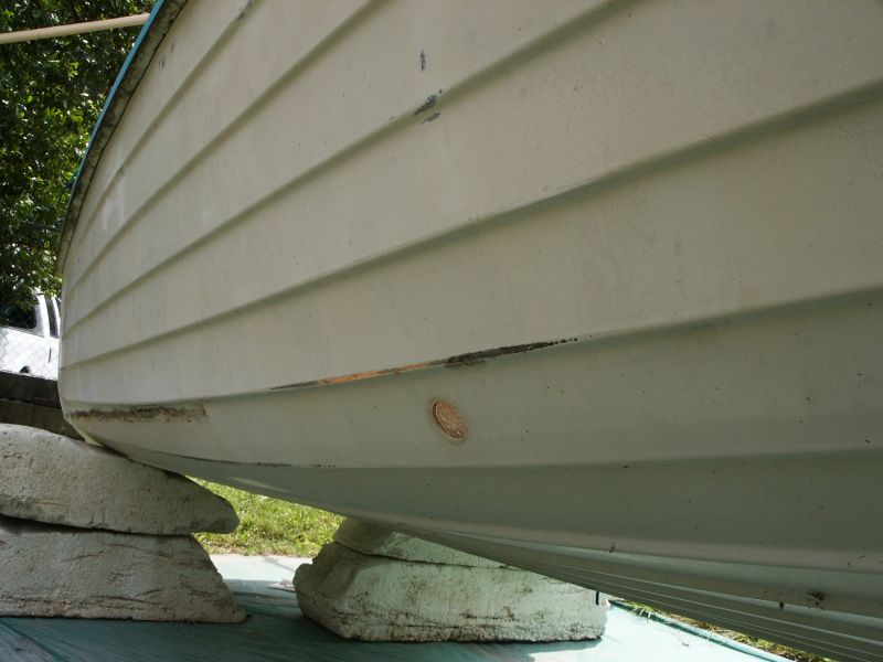

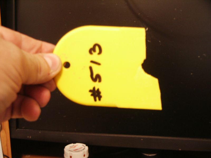

ok all i can tell you right now is that this is a home made tool i made for my mfg sea cruiser to help with the restore. i imagine you can refit to do almost any boat. im going to give you all a few days to guess what it is and then i will send the rest of the pictures to announce the purpose and design .
Re:ok guys here is a what is it???? 10 years 11 months ago #97807

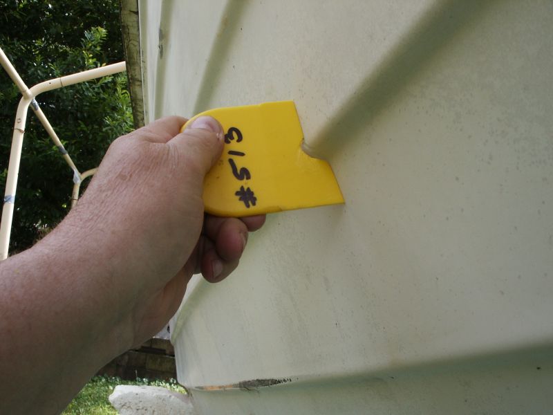

Lap tool for working filler on the edge.
Re:ok guys here is a what is it???? 10 years 11 months ago #97893

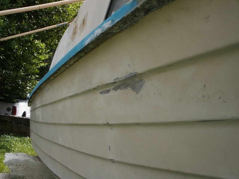

ok robert you win i have some back spots and they are mostly on the edges of the lap . so i filled and sanded most of the others on the other side and took awhile. so i wanted to do a better job or as good of a job and quicker on this side. robert got it i is a spreader i cut down to use i can angle it and use it on the deeper ones as well as the shallower ones. thanks for playing i thought it was pretty good to see a need and to find a solution .... i have had several of those. ok thanks
