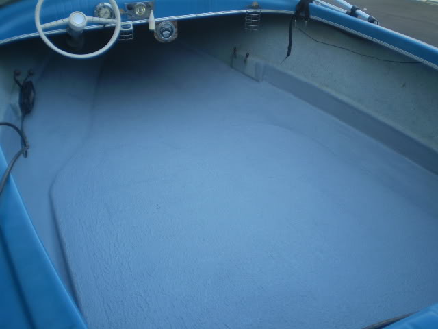

Re:Dorsett Belmont vs El Dorado? 10 years 11 months ago #97520
Joe considering you are a more knowledgeable on these I am now worried. My boat has a stringer centered on the keel and one off center each side about 12". Overall interior is about 56" which leaves 16" between the outermost stringer and hull. With the shallow depth of the boat it seemed adequate as outermost stringers are only a couple inches deep at the most. I ran the original 3 and added cross braces to get rid of the sloped floor which in the past I have found to be easier than mounting everything at a slope. If you have seen the great blog with "whiskey Tango you will notice his seats both lean towards the inside. Every interior I find shows a drastic sloping which I believe is due to the minimal space and stringers.I have attached a picture that is the best I have been able to find across the net of a Belmont deck albeit carpeted :(. Even in this pic the flat stops at about 48" which is the standard width of plywood and where I plan on stopping my flat deck.
More Time than Money! 1965 Dorsett that was butchered by previous owners but hull in decent shape.
Re:Dorsett Belmont vs El Dorado? 10 years 11 months ago #97594
  • Shake
  • Shake's Avatar
  • Posts: 983
  • Karma: 29
yep that's about right.. 48" wide to the outer stringers like in the pic.
