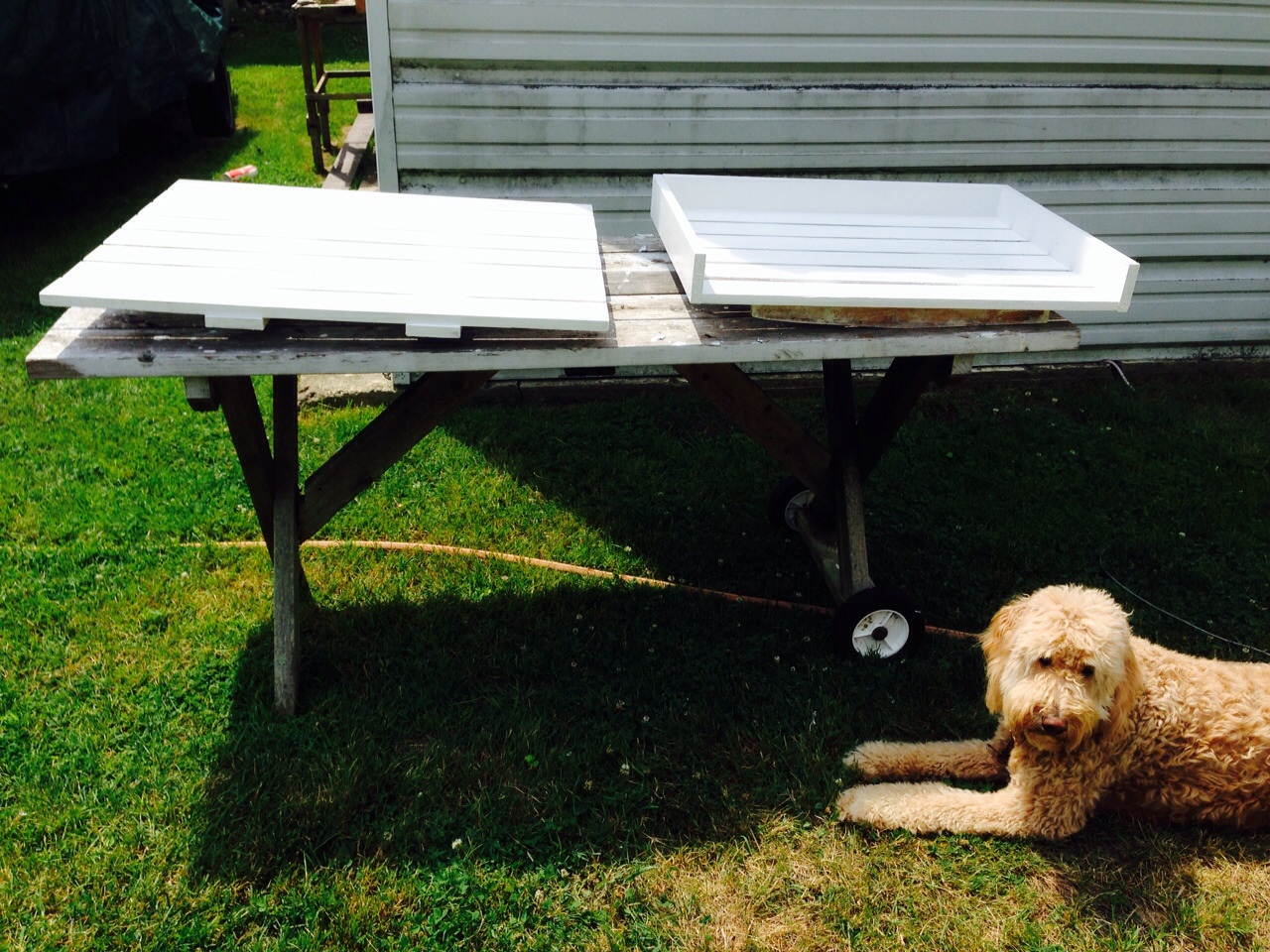

As far as the work on the boat, I get to do exciting things like paint the slatted floorboards and somewhat matching rear gas tank holder I built. This boat was never meant for a full restoration but do what I can that is close and make it salt water useable. More of a daily driver.
Shown here with Mattie the TV star

Your coming right a long then. I see Mattie the Forman is making sure it gets done right. ;)
