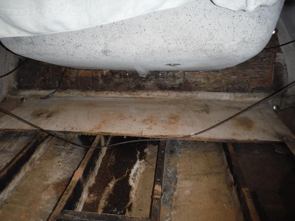

Ok no problem will do both!!!! Yesterday and today I cut out a good section of the inner deck area as the plywood under the think layer of fiberglass was rotted - I think it better to just replace the whole section rather than try to piecemeal it. Under the floor it was full of water!!! The stringers were actually quite solid - I think just being immersed in water kept the oxygen away. I washed everything out under there with a mixture of bleach, mould killer and detergent - in the 100 degree Californian sun it will probably all dry out in a couple of days or so!!! I am waiting for my buddy to give advice about where to cut back to in the transom - as you can see in picture I stopped shy of the edges as that wood is rock solid and under the fiberglass - I am hoping to use that as support for the new wood transom inside.

I got a question.Was the wood exposed on the inside of the transom like that or was it originally glassed over and the glass been removed? Those boats don't look terribly hard to put a floor and transom in.I had looked for one of those around here(NC) back in the Spring...nonexistent. Now,I have some unexpected expenses that will take MY toy money I had put back :( . Maybe someday I'll find one of those or maybe a G-par seafair or ??. Have fun with it. jim
