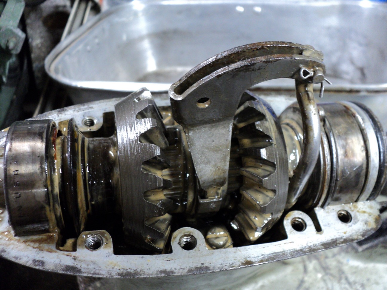

Re:Help Screwed up 12 years 2 months ago #97257
Hey Robert, Just wanted to Thankyou very much for the Detailed Picture of what the Pivot Bracket looks like. I ended up taking the lower end off and checking everything. All looks good and not worn put on new seals and put the Pivot pin back in. Fresh Lube in Lower End and all good. Launch Tomorrow:) Tom.
